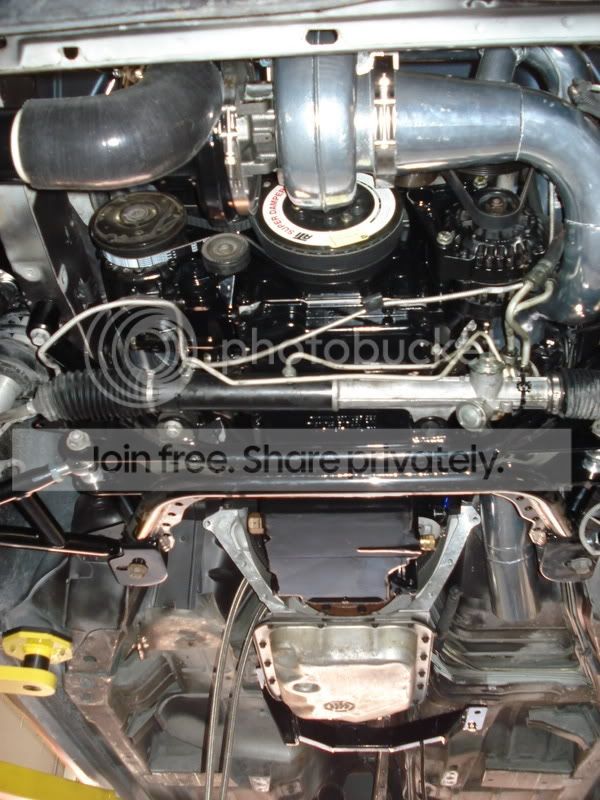

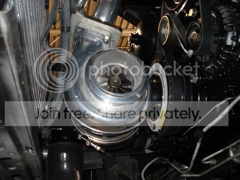

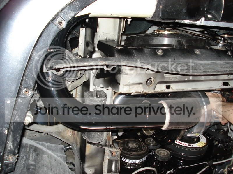

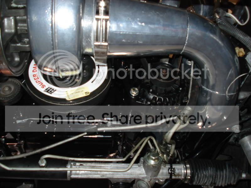

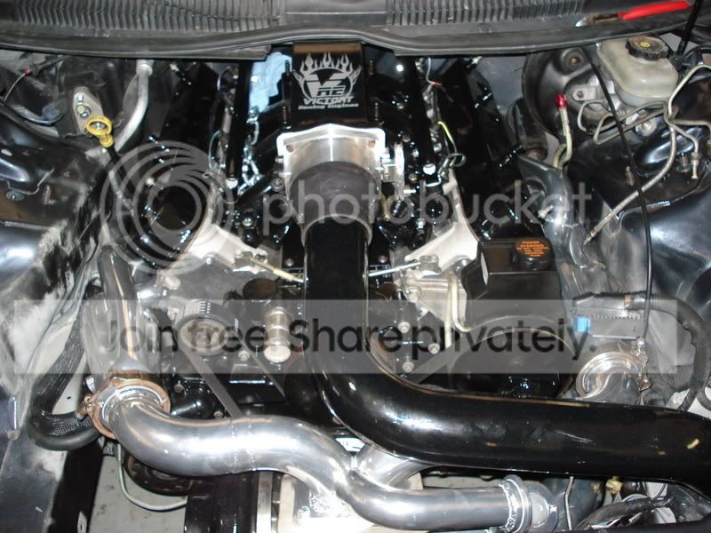

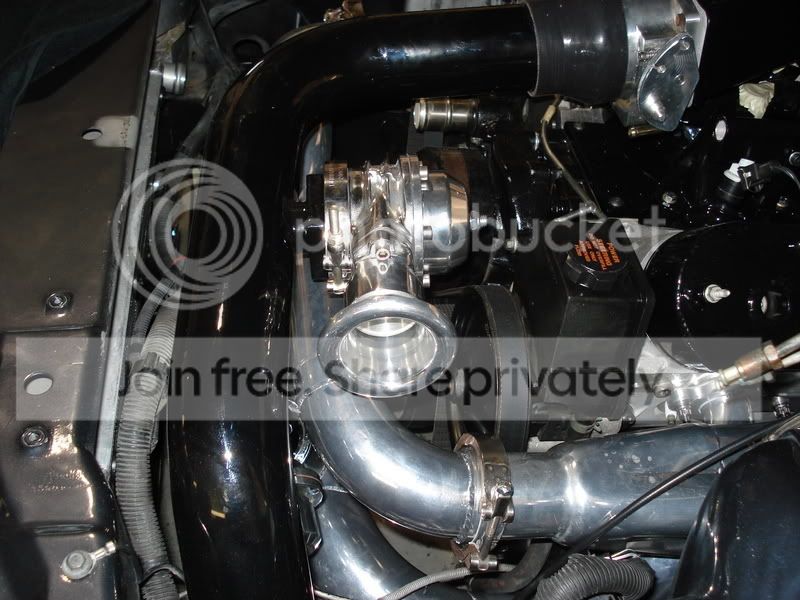

Ok, got some update pics on the build. Everything is on for the exception of the driver side IC outlet pipe to TB charge pipe. That is being cut and welded a bit, not much, so its a smoother fit.
We still need to finish the lines for the bov and wastegate, install boost controller, filter for turbo, and a few misc. things to have the turbo kit and motor finished. Next will be the rest of the kit including fuel, rear, sumped tank, trans and driveshaft refitment and remainder of suspension parts.
Well, enjoy!

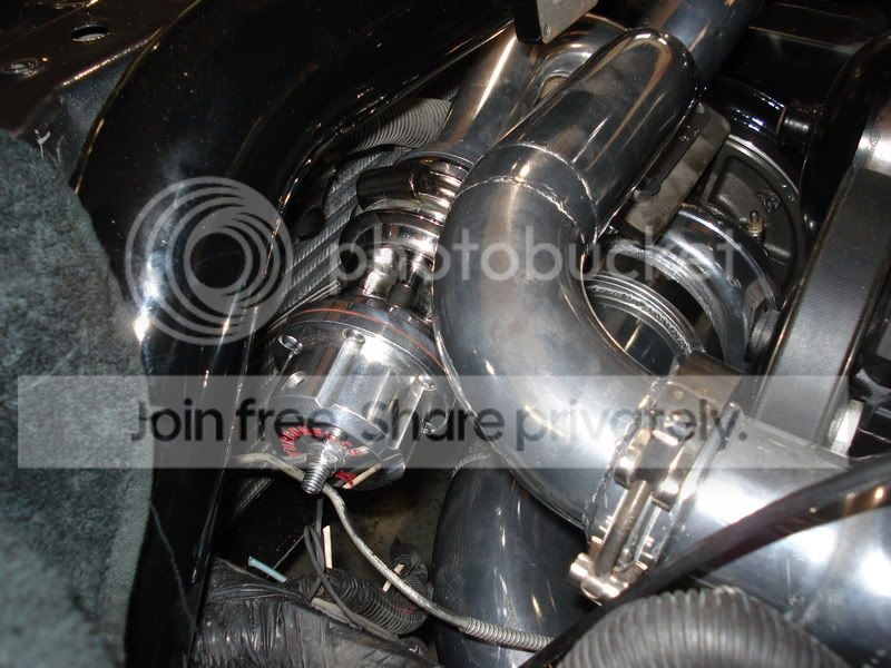

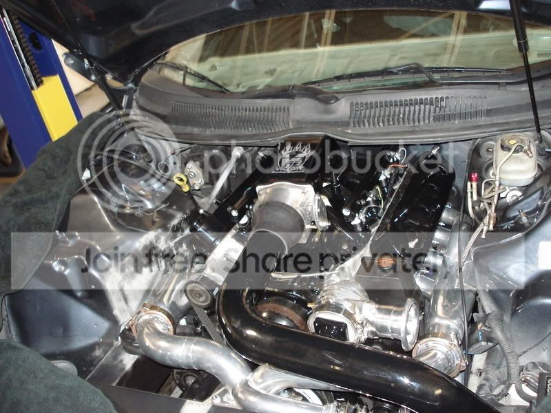

So what do ya'll think? The Tb charge pipe is just fitted, thus it may look a bit off. Also, the cowl was cut to fit the elbow. However, I think I may want to have the manifold milled .5 down so it can fit under the cowl and just replace the cowl since this one was cut. I don't want water to pour on top of the engine and the way it site now, it may from the pics.
The BOV is a turbonetic Godzilla valve "blowzilla" and the wastegate is their new Neogen gate. Both are quite big and should hold well to the amount of power we are shooting for.
Honestly, I think the kit looks fantastic!! It need some massaging to get everything to fit and function properly but thus far, it looks great.

That BOV is going to sound SICK.
This is all looking awesome... Did you guys bend the cowl up a bit?

Looking good. It sure is a tight fit. Your TB is on backwards also.

What are you doing to a turbo support bracket?
yeah, im kinda anxious to see what it will sound like. I really like the flutter type sound of a bov over the single whoosh but honestly, it's gonna be loud and nasty!

you better make a support brace for that turbo or its gonna crack the headers. my exhaust guy made a simple one for me ...not pretty but holds that sucker up
Yeah, you noticed that huh?!
They were trying to see if it changed the way the hood hit but its gonna get turned around. DP is tiiight!! I know cable suggested a few things so we are gonna see what we may have to move, relocate for more peace of mind!
thanks, it's in the works. Cable, you see anything that you know I should move around? Got any picks of that support? Where did your guy anchor it?

Interested in the support also. Joel said the T-6 crossover came with a bracket now, neither of yours did? Also, I have a 3.5" DP coming, will it fit? I almost went with the 4" to..
One more thing, the turbo looks close to the balancer, you think a turbo blanket will fit on there?

The turbo is quite close to the balancer, and with the later installed condenser and fan, it might even be a tight fit on both sides.
I would say that no, a blanket won't fit on there but there is always a way. MAy the pics are a bit misleading. I would like to get one but then i'm covering up a sweet looking turbo, so, hard choice for me.
I'll get some pics up of the support bracket.

That really looks great! You might have some troubles keeping that thing under 200 degrees with limited airflow to the rad. I had cut out my front bumper to gain airflow throughthe intercooler to the rad and make some shrouding to keep the air going right through the intercooler. The airdam wont cut it anymore. I also added a 3rd fan which is a puller on the back of the rad on the pass side, never gets above 204 in stop and go traffic w/ beating on a 90 degree day.
I just put a street scenes grill in, painted black. Sorry dont mean to jack ur thread, just showing how it looks.
