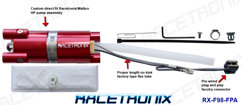

You could use a generic walbro, or you could have a full plug and play solution from racetronix! We only use genuine Walbro's in all our assemblies.
If the car is factory or only a few mods, you can use the $107.10 Racetronix factory upgrade pump.
http://www.racetronix.biz/itemdesc.a...PA-017&eq=&Tp=
If he plans on more mods in the future might as well get the 255lph now! Better than doing it twice!
http://www.racetronix.biz/itemdesc.a...PA-002&eq=&Tp=
