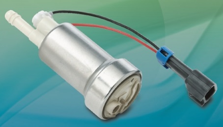

What all will I need to do if anything for it to fit?
Looked through the walbro thread and didnt see anything referring to that pump. I was watching a local shop trying to put a 400lph in a gran prix gtp's bucket and it definitely didnt fit like a 255 or a stocker would.
My goal is 600whp this pump should support that I believe. Though unsure if I will also need to upgrade the fuel line as well.

its actually a 416 lph i think
i have one and have had a 98 and dont see why it cant be mounted with very little extra effort.
98's dont have buckets

i know in the z cars they can go over 700rw on the one pump but of course there are no gaurantees in life!
they are not the same size as a stock pump
