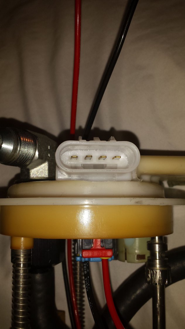

Any pictures of your current setup? I'm in the midst of doing dual 340LPH pumps as well. Basically I have the racetronix hotwire kit for one and I'm making another hotwire kit for my other pump. You need two power feed wires. The grey wire in the big fitting behind the tank on the body is the "switch" wire to turn on the pumps.
Grey wire- Pump trigger wire
Purple wire- Sending unit wire - (Fuel Level)
Black wire w/white tracer- Sender ground
Here's what I have so far, I'll be ordering another one of those white bulkhead connectors for the second pump.
