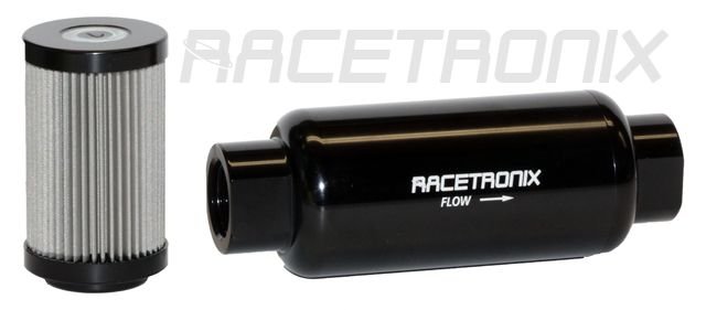

Originally Posted by 91 Z28
I bought the racetronix dual 340 kit for my 3rd gen. Ill be using 8 feed 6 return lines. One of the racetronix techs was telling me when buying a fuel filter for pumps like that you need at least a -10 fuel filter because anything smaller doesn't have the needed surface area(something along those lines anyway)
The details of a conversation are everything. If something doesn't make sense please ask our tech team.
A 10 micron filter between the pump and injectors is required to provide reasonable protection in a fuel injection system. A larger filter element (with more surface area) is required to prevent pressure drop through the filter at high flow volumes. As more debris plugs the filter element the pressure drop increases across / flow decreases through the element.
Based on testing with our SS/magnetic filter elements we recommend our #12 filter housing for applications that require 500LPH or more. Given the small price difference between the two filter sizes the #12 housing is the better choice when space is not an issue.
Different manufacturers may have different specs and recommendations based on the design of their elements. Not all filters with the same micron rating perform the same.
Our #10 housing and element combo is currently $56.06.
Our #12 housing and element combo is currently $60.80.
We offer two types of mounting brackets:
Extruded bracket
Billet mounting bracket
