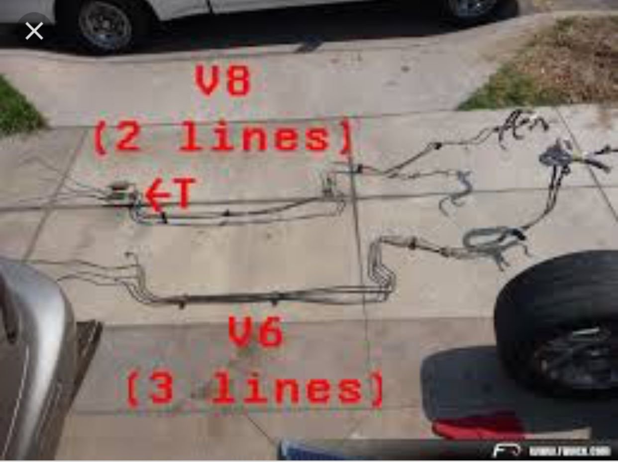

Are you sure The V8 fuel lines are any bigger than the V6 lines? They might be the same piece! Have you checked on this?
Old Mar 16, 2018 | 03:10 PM
Masnart197's Avatar
Joined: Jan 2016
Posts: 28
they are the same diameter, but the v8 lines have only 2 lines with a t block (return less) and the v6 have 3. You can convert them buy flaring and installing a t but I would rather just swap them then deal with the hassle of that.
Old Mar 16, 2018 | 03:11 PM
Masnart197's Avatar
Joined: Jan 2016
Posts: 28
The picture was supposed to be under my statement lol
