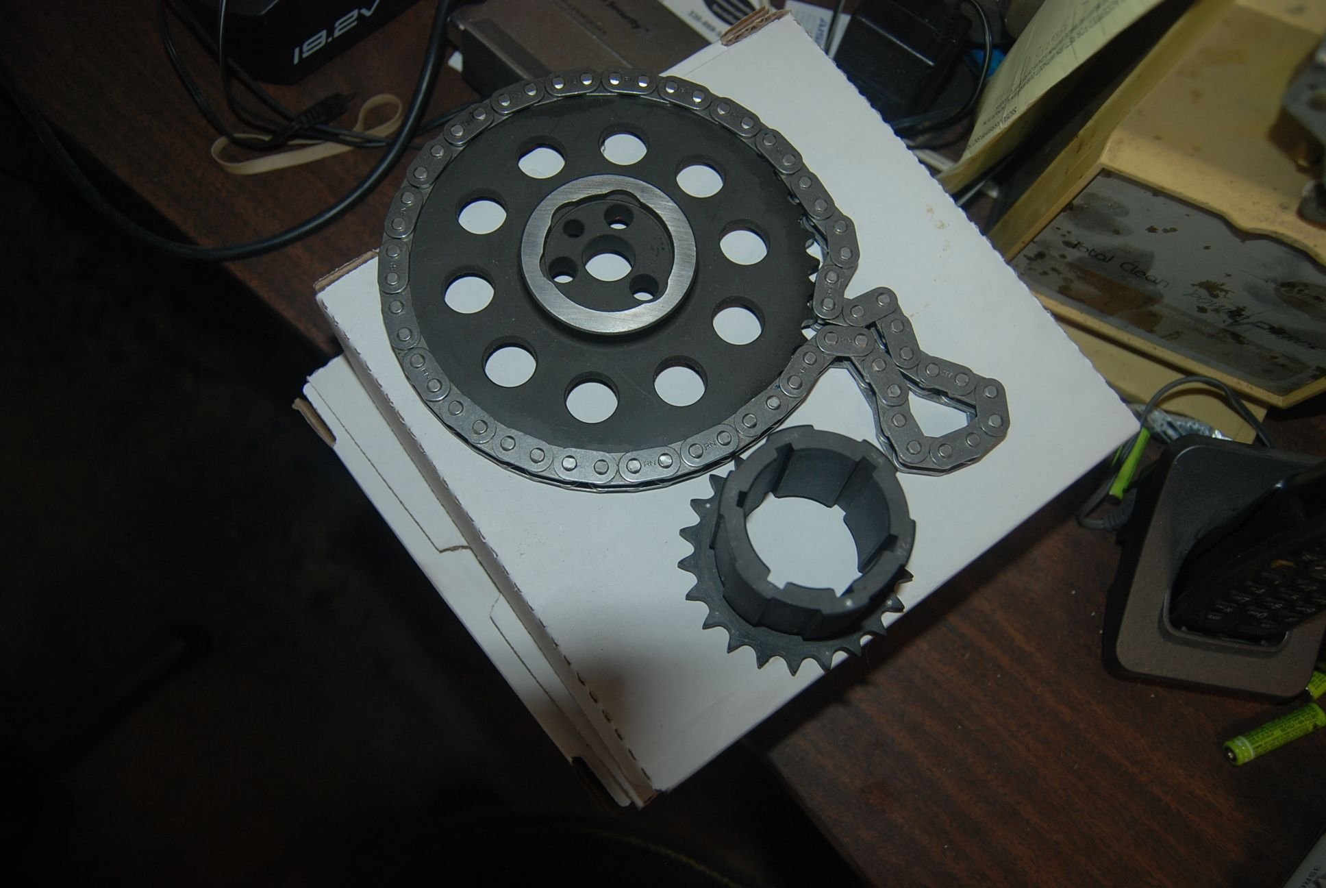

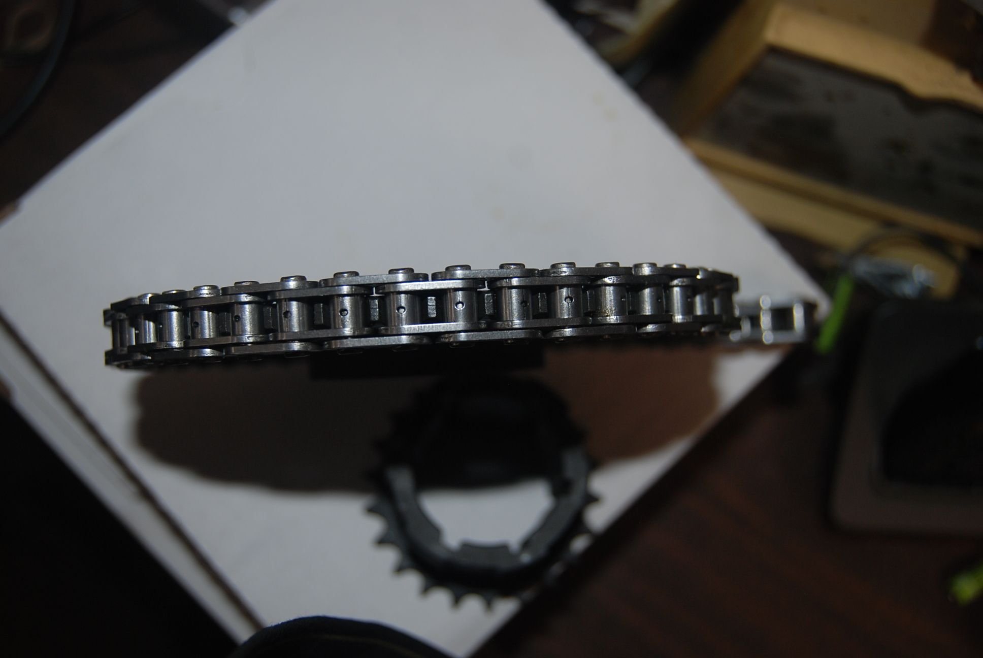

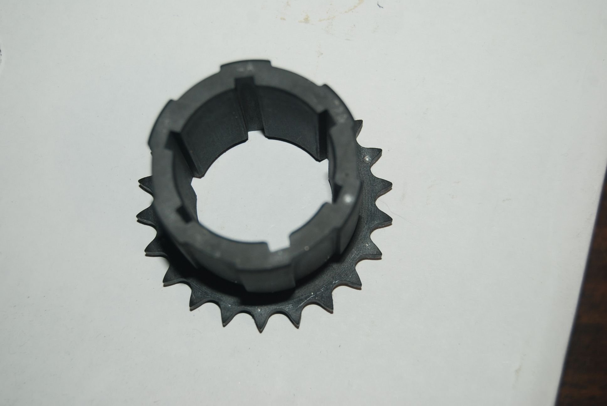

Hi Nathan, my customer, off road truck, ALSO is using a 5.3 engine for his base test.
This engine features a Reground Crower Camshaft, my spec@ $200.00, my Valve Spring Kit, his hand porting.
My timing billet set (AVON) and a 2010 Camaro Oil Pump @ $90.00.

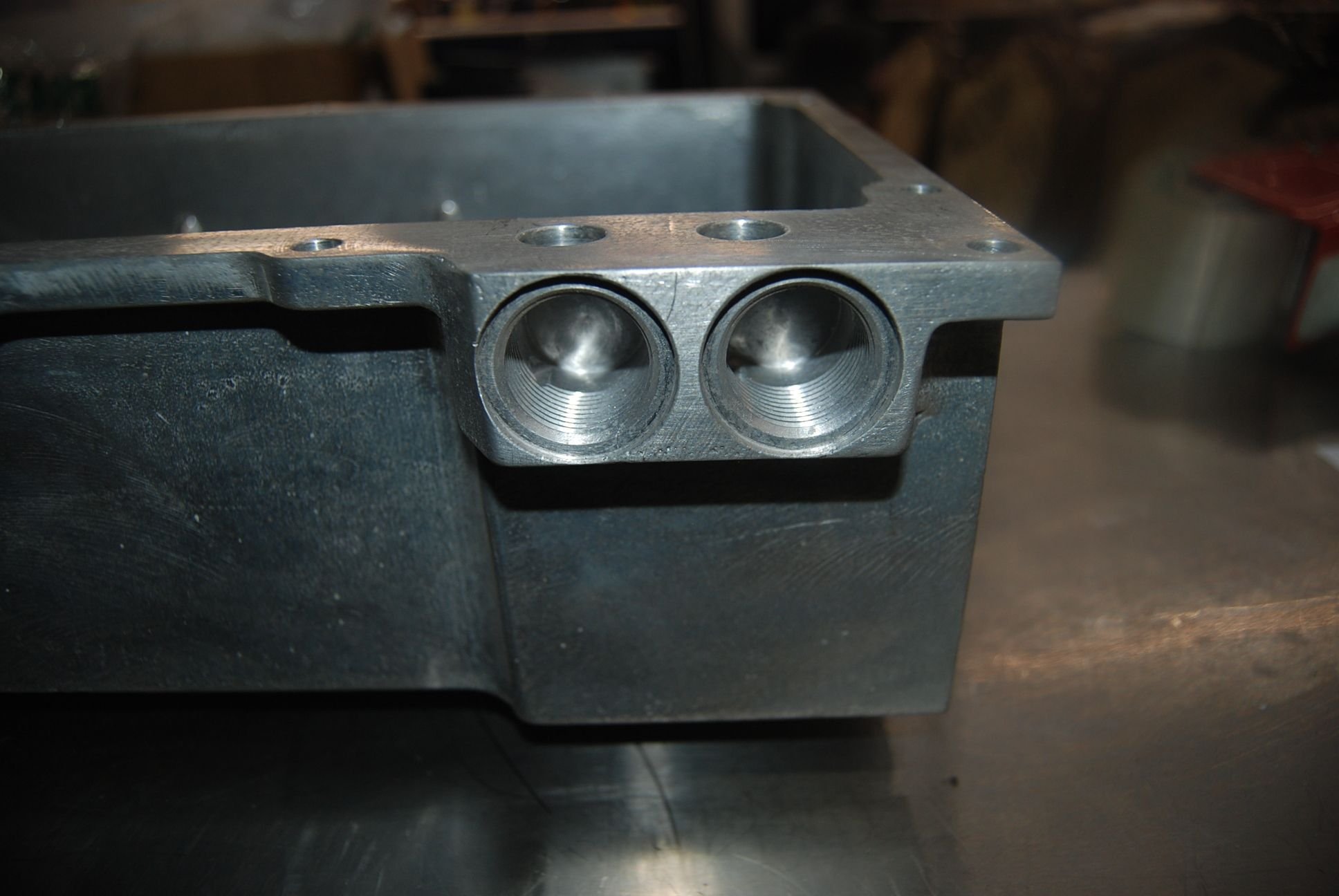

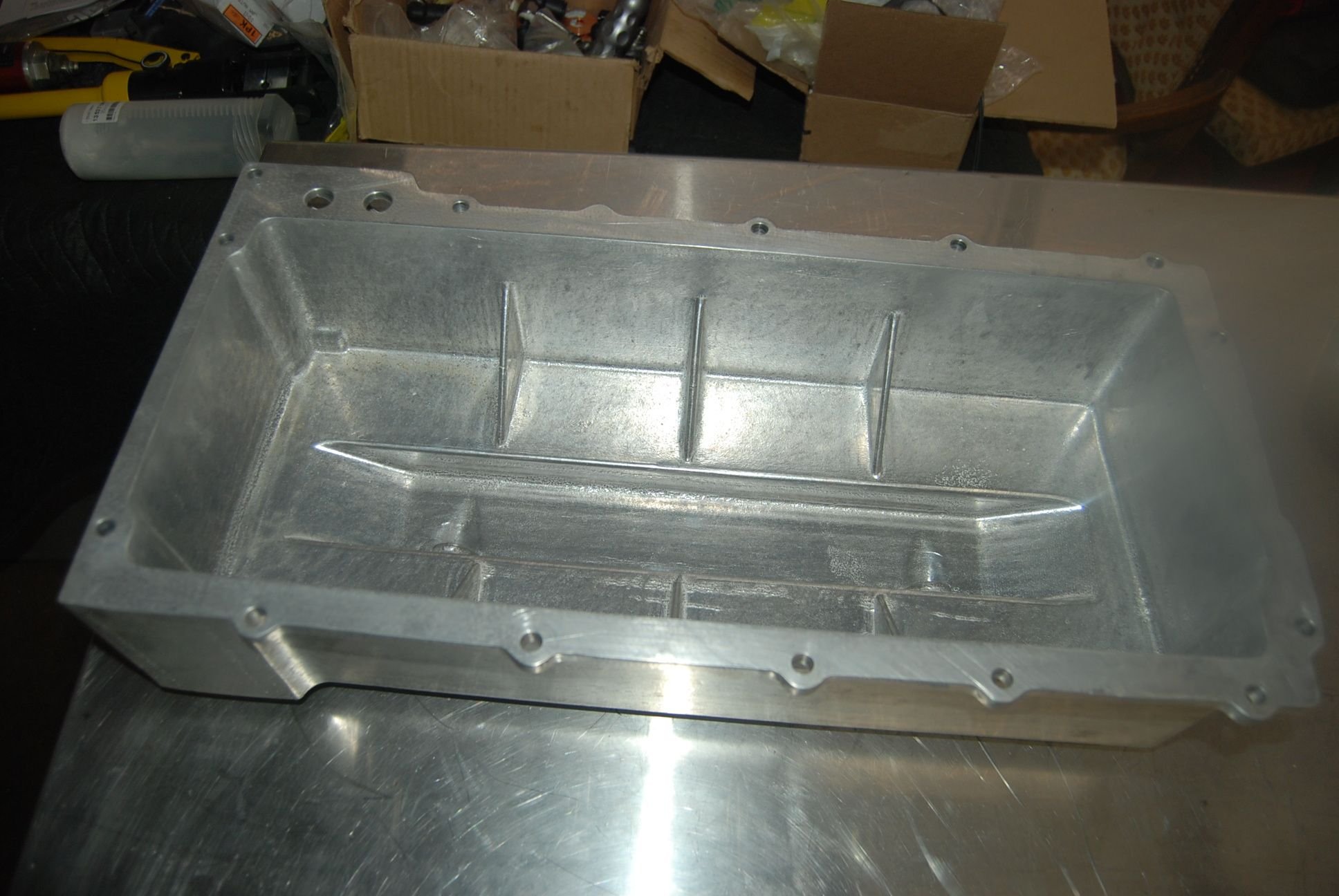

My off road truck customer has another 5.3 GEN-IV (spare engine) that will use my 4.1" crankshaft, 98mm pistons, ALL Forged kit,
He fit my cast AL Oil Pan..
