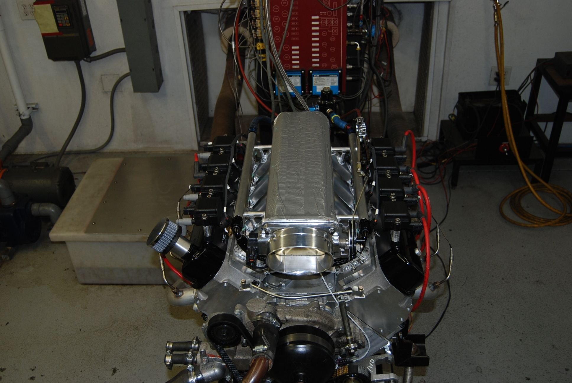

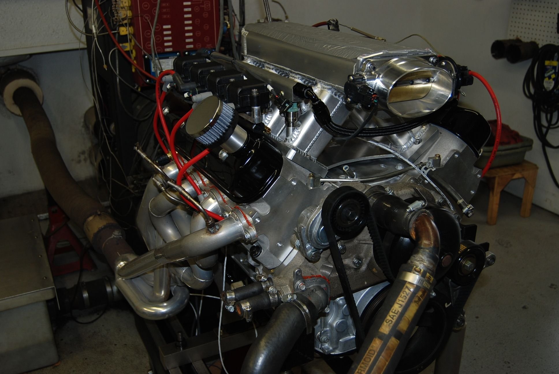

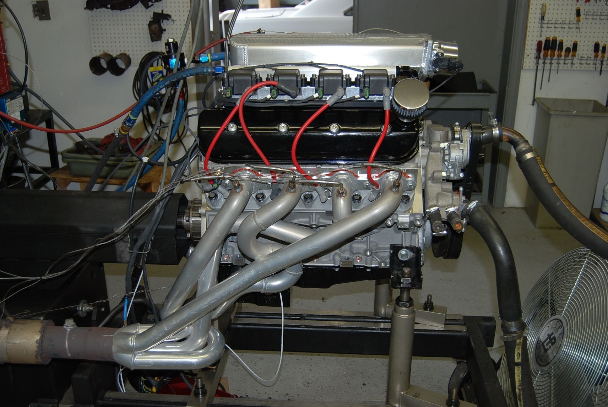

What fuel injector should I use ?
i went from an Ls 1 with 450hp to a strocked Ls 3 418ci with 675 hp. I upgraded the intake to a custom sheet metal intake with a 102 TB. from sharp customs. I heard you can use
mustang 42lbs. green injectors n there a lot less money ? 42 to much ?
the motors in a NASCAR Stockcar so it's not doing any street driving. All racing on road courses.
Thank you
