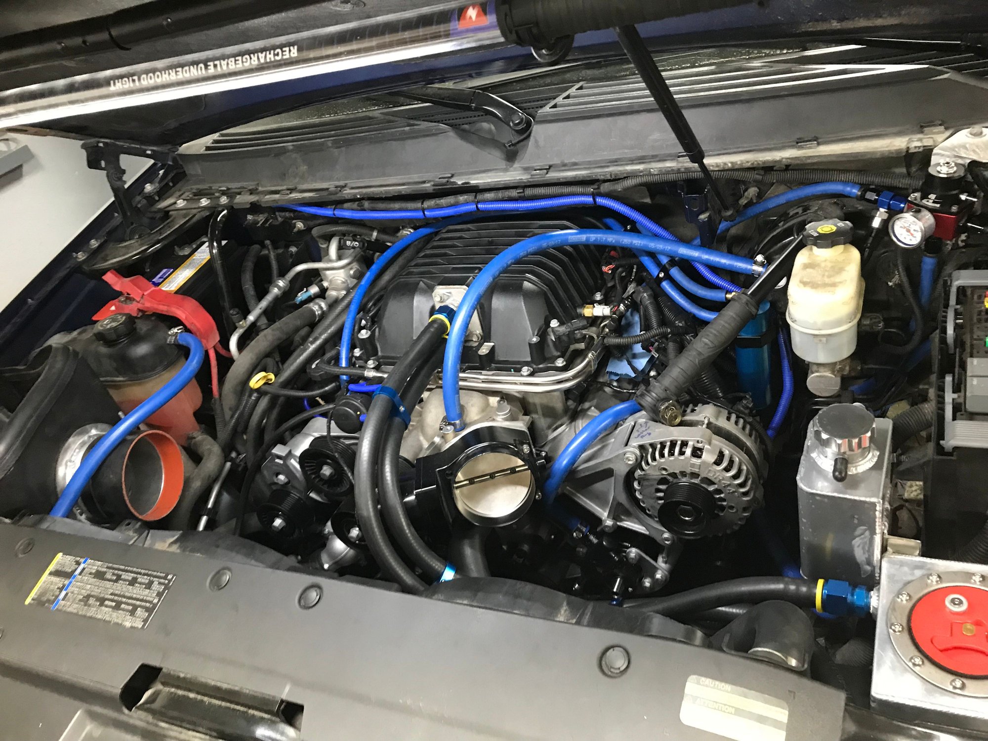

I used it on my entire LSA Yukon Denali build... Works great. They are hard to get on but well worth it. Very clean and hold 250-300psi depending which hose you use. Use a hardline to AN fitting and it will hold well more than the 100psi of a fuel system. I don't suggest the adapters with plastic inserts. Use SWAGLOK if you want to be trouble free or adapters without plastic, metal only.
