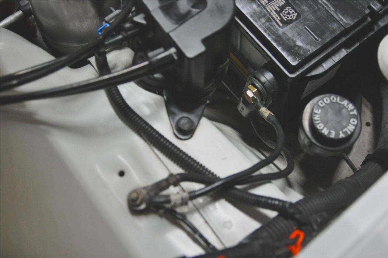

How important is the upgraded ground wire? Debating whether to have them send one or just get a refund.
Since you have already paid for it, I would notify shipper/vendor and request that they send it rather than a refund. Be aware you have seven days to report the shortage. Make sure to save the inventory list with check mark on each item as it was picked, packed, and shipped.
The ground cable is not a show stopper. A good redundant ground is dependent on a lot variables - essentially how good are all current grounds. This particular ground connection is in the engine bay, but there still might be some rust under the retaining nut. So make sure all rust is removed.
You can make your own but their ground cable is quite inexpensive compared to making one.
You can use the current bolt to connect or if there is an extra hole like mine (a 98 and yours is a 2000) then you can insert a bolt there and connect as well. You will have to remove the fender well splash shield. Not sure if I would want to use a self tapping bolt because it might strip out when clamping. You want a good connection that will not loosen over time.
hth
