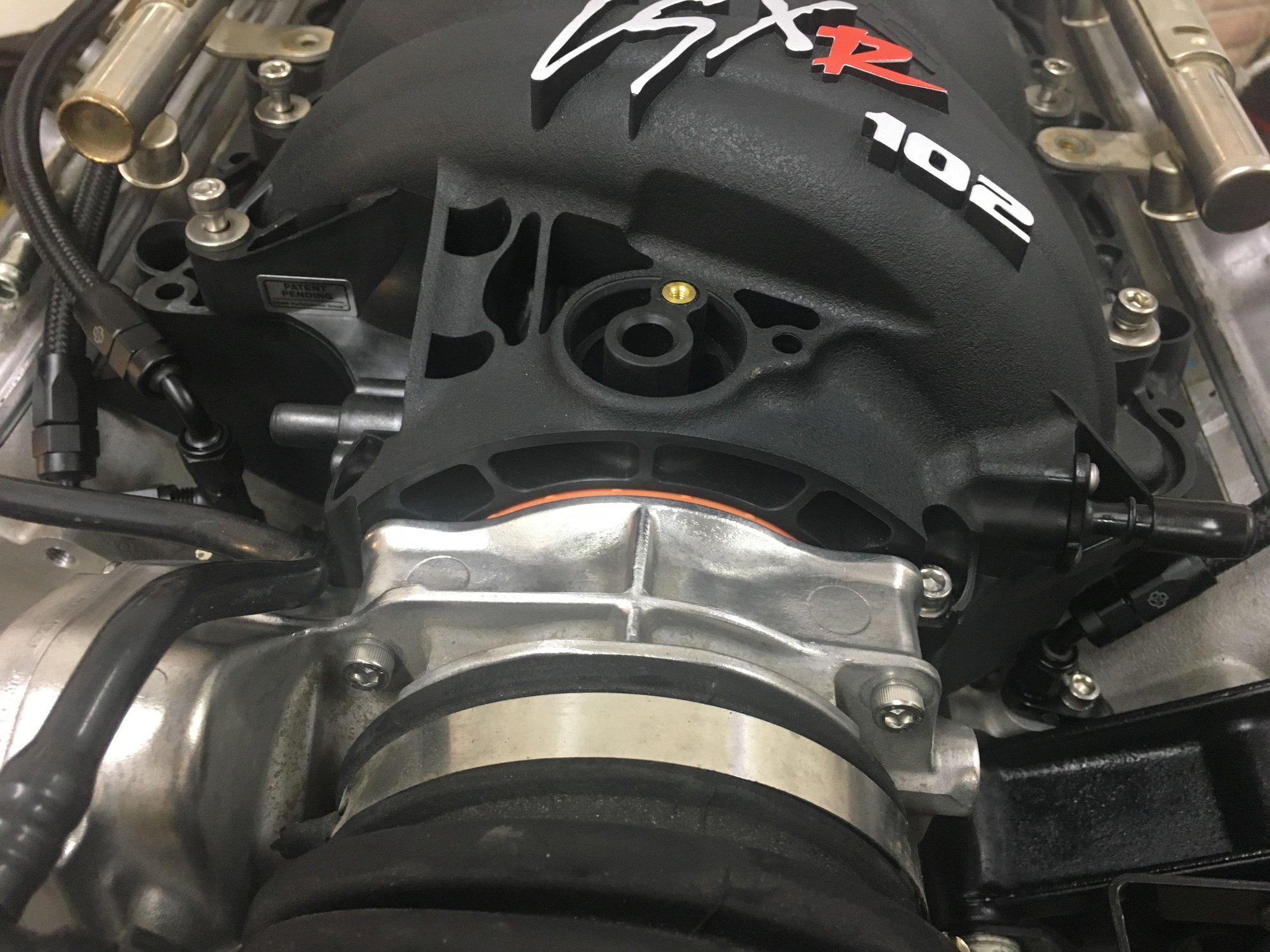

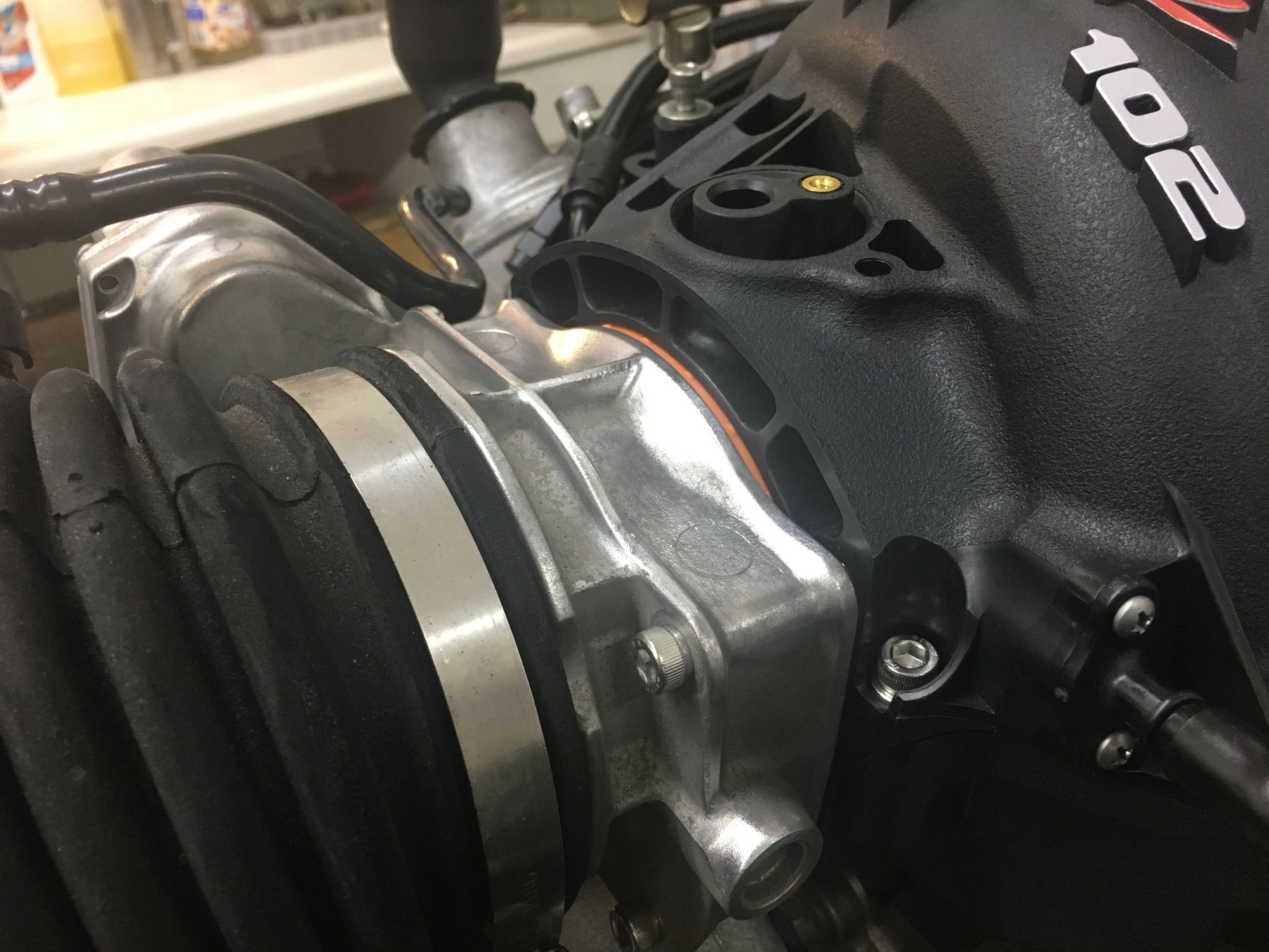

I’m am mocking up my LS2 build before installing in to my car.
The first thing I have noticed is that it looks like I will need an adapter of some type to configure my GM LS2 TB to fit the FAST 102
Can anyone point me in the right direction to find one ?

V-Max Velocity Ring, fills/eliminates the gap at the plenum entrance when using 90/92 MM TB
on a FAST 102 Manifold. I am using this with a LS2 TB on a FAST LS3 102 Manifold.
It also helps with tuning, especially at idle, part throttle, and low rpm transiitions.
