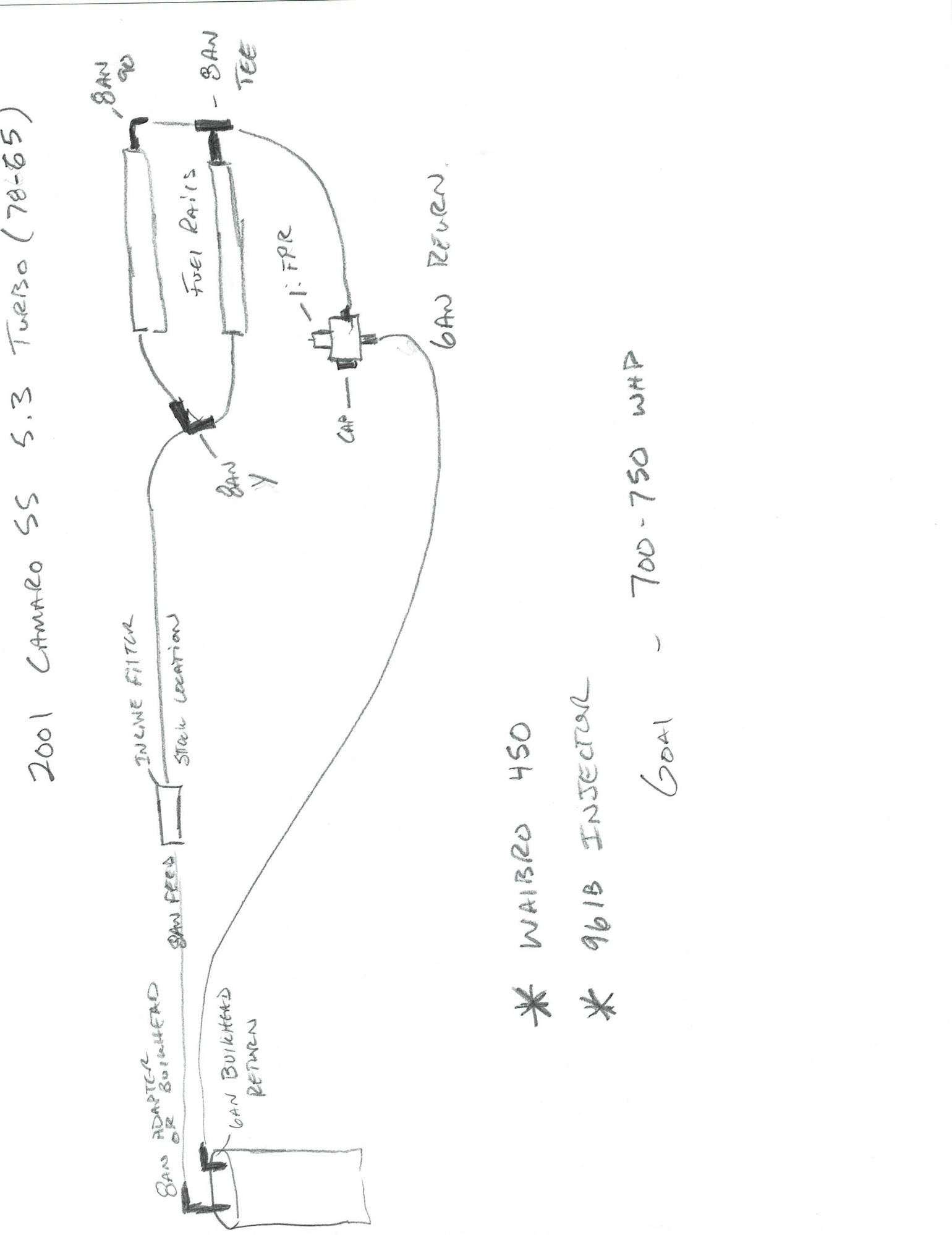

I have a 2001 Camaro and doing my first 5.3 turbo build. I am really appreciating all of the knowledge on this site. Details on the car: 5.3 stock bottom block, btr 660 spring/ heads worked. ON3 7865 turbo kit and on3 turbo cam. Holley sniper low ram intake. I have 96lb injectors still deciding between and 450walbro or the 525pump. I am looking to setup for e85 and power goals are somewhere in the 650-700 range. I am planning on 8an feed and with 6an return that is bulk headed at the tank. I have roughly drawn my fuel layout based off of the mass information gathered through the site. Does this look acceptable for my goals or anything I should change? Looking to get the Jegs max flo lines and fittings. Last question, are tees frowned upon in a fuel system. I feel like I could use a tee on the back side of the fuel rail and then route to fpr. Can I then plug the far side of the Regulator and just run a inlet and return from it. Any suggestions are appreciated!
