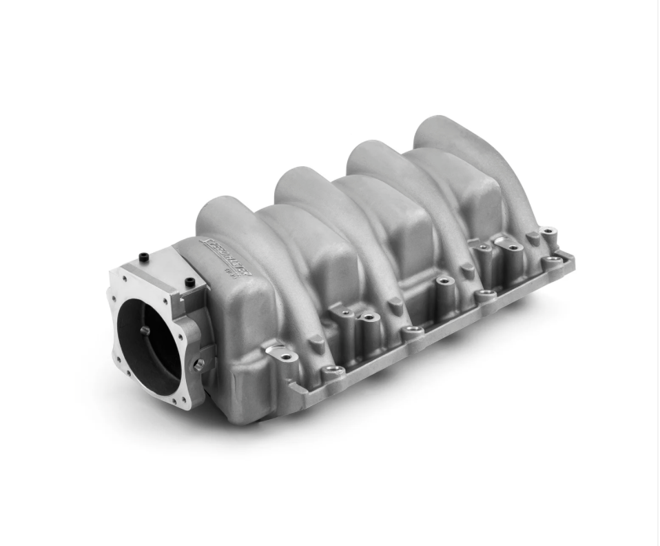

I am using this Speedmaster intake, called "Qualifier ER Series Intake Manifold" that I bought new a couple years ago. Here is a link to it
https://www.jegs.com/i/Speedmaster/7...8-014/10002/-1
Old Apr 2, 2021 | 05:56 PM
RedXray's Avatar
Joined: Mar 2005
Posts: 663
Likes: 384
From: South Carolina
The description says "LS1, LS2, LS6"
As you can see on the ICT chart the LS1 & LS6 injectors are the same length and the LS2's the shorter of the three. Since you have to run aftermarket rails I would mock up the intake with the rails and see how the LS1 injectors fit and if they require any spacers because of their extra length compared to the shorter LS2 injectors.
The FAST 36lb (303608) are the correct LS1 length (64.77mm) with the correct intake bore (.551). There is plenty of good data for them as they are the same as the Pontiac GTP & ASA injectors.
