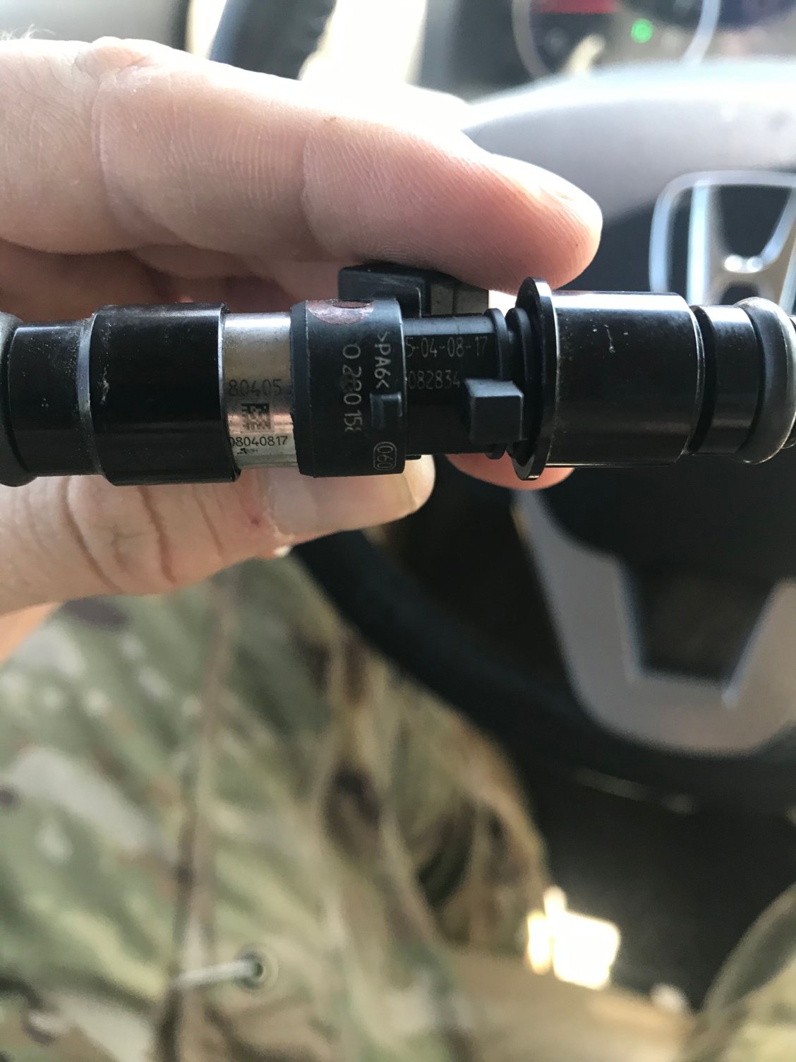

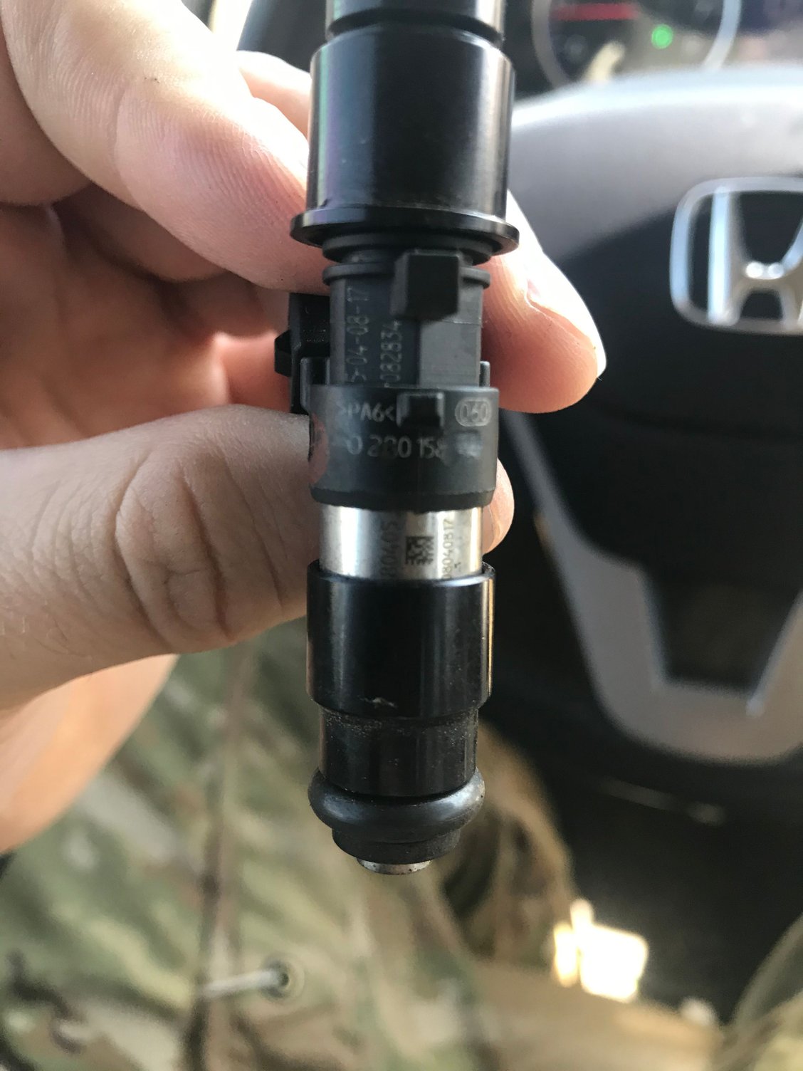

Can someone help me ID which injectors these are thank you.

Looks like they are EV1/EV14 Bosch injectors with extenders on both ends. As far as flow goes, you would probably need to have them flow tested to see exactly what the flow rate is. Are there any other man made markings on the injector? Maybe on the bottom of the connector

Thank you, i found out they were only 60bls, I was the one that went to your shop today for the 210 lbs injectors thanks again!
