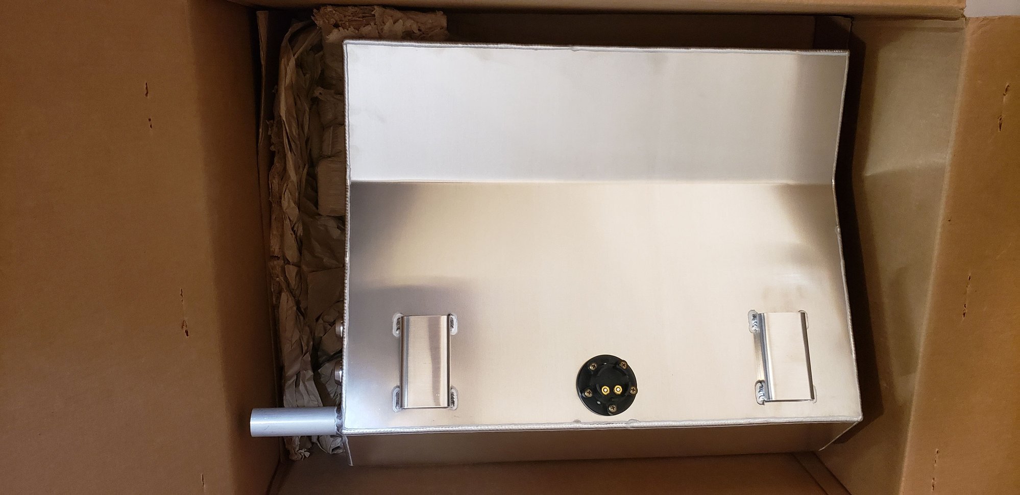

So how does the factory setup work in your car, 2 separate fuel tanks that gravity feed to another tank, or right to a merge with a pump right there?
I searched a little, and saw some tank setups in here: https://www.jaguarforums.com/forum/x...-tanks-197470/
I like the idea of the tank right behind the back seat, does not eat up whole trunk. I saw that as a guy with a 15 gallon cell that eats up 2/3s of my trunk, it's not ideal.
My system is overkill, (-10 feed, -8 to rails, -8 return( but I think if you can find a good external pump I'd go -8 feed and at least -6 return.
