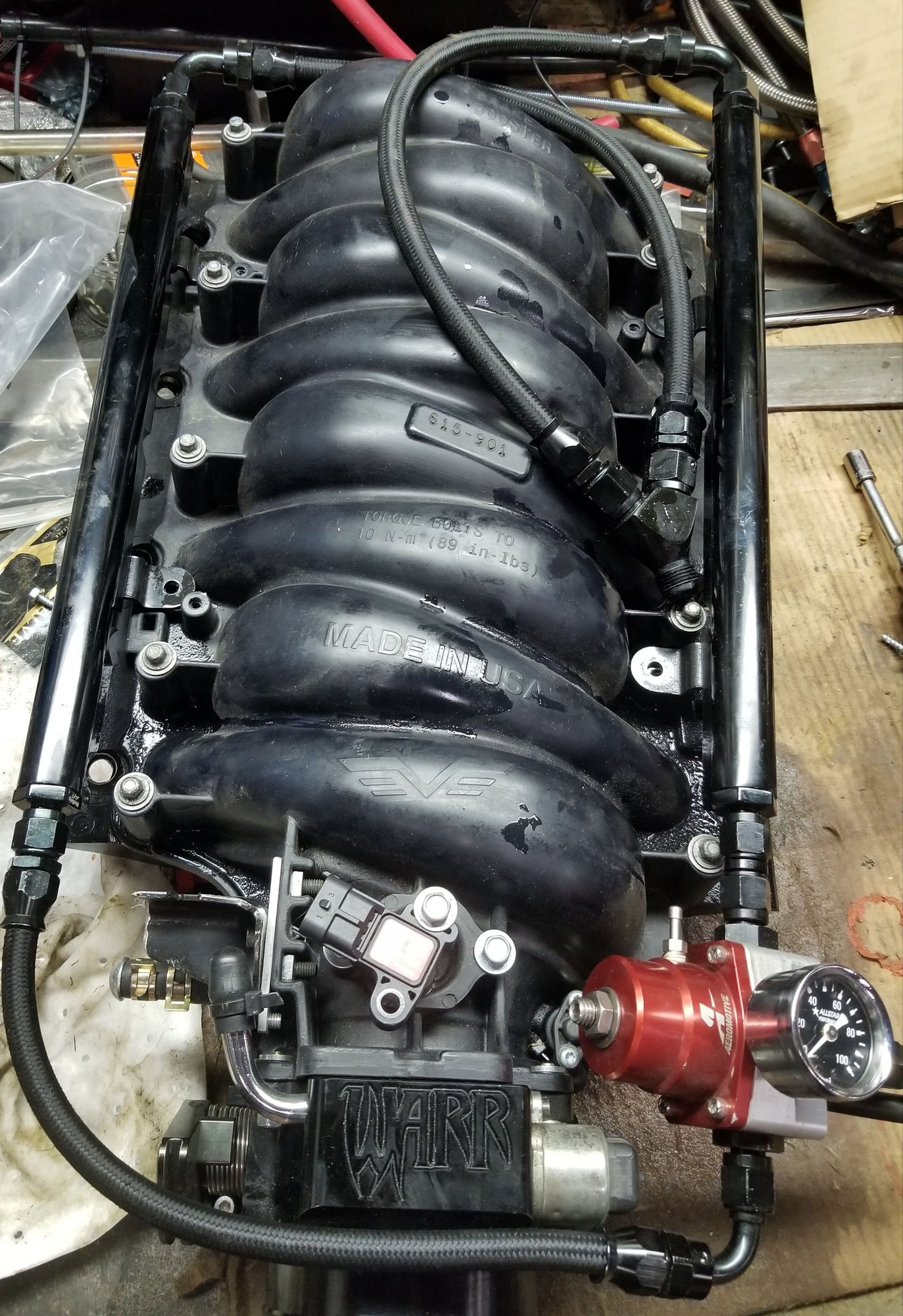

I'm just curious of (logic, theory, proof) why a regulator physically connected directly to the rail, is better, worse, or same, as if both rails have a small length of hose prior to the regulator, basically making the "Y" in a slightly different location?
If there's a proven, better way, I'm all for it. Heck, I love doong every mod 2 or 3 times, 😆
Not really, but it happens often.. lol
Here's how mine is currently.
p.s. I have the FEEDS extended for ease of maintenence, since I have fat hands, lol. (Stole the idea from Maven)

I'm digging the setup! Do you think there would be a problem with reversing it but not connected to the rail?
Old May 22, 2021 | 12:20 PM
rel3rd's Avatar
iTrader: (43)
Joined: Nov 2005
Posts: 2,874
Likes: 314
From: Baltimore County, MD.
No matter what, the FPR should be AFTER the rails (for a true return style setup).
So if you fed one side at rear of rail, then crossover at the front, and FPR somewhere at/near exit side of opposite rail, it should be fine.
Only possible issues, I can think of right away, are inaccessibility of FPR to adjust it, and a FPR mounted to firewall not being NHRA legal, if that matters.
If the regulator is before the rails, whether back at/near the tank (factory Corvette style), or just prior to rails, then it's technically a "Dead headed" fuel system.
I know on my car, even with a stock F body LS1 rail setup, converted to return style, (complete with FPR mounted to test port) and rail feeding a 250 shot, the fuel was there...
With the dead head setup the car had when I got it, a regulator back under the rear driver side seat area, and a rear mount turbo, I blew both head gaskets first time to track,, 😆
After fixing that with my screwed up back, I 100% want full fuel availability up at my rails, where its supposed to be...especially with ethanol.
