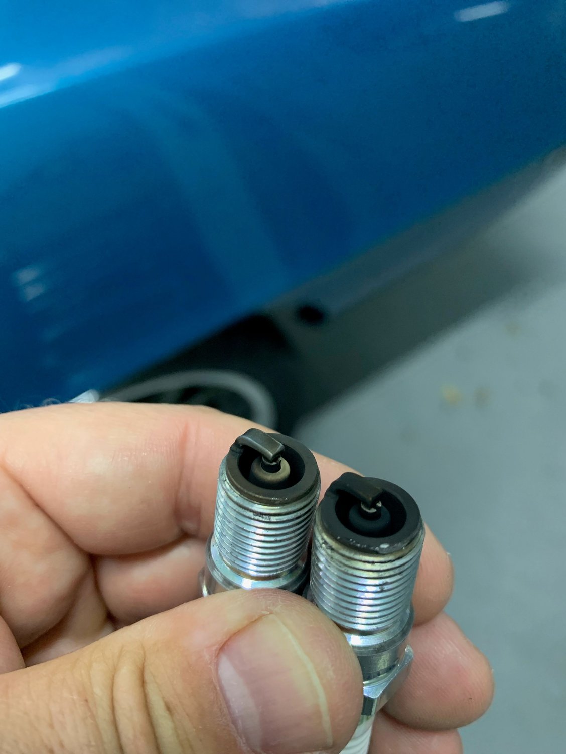

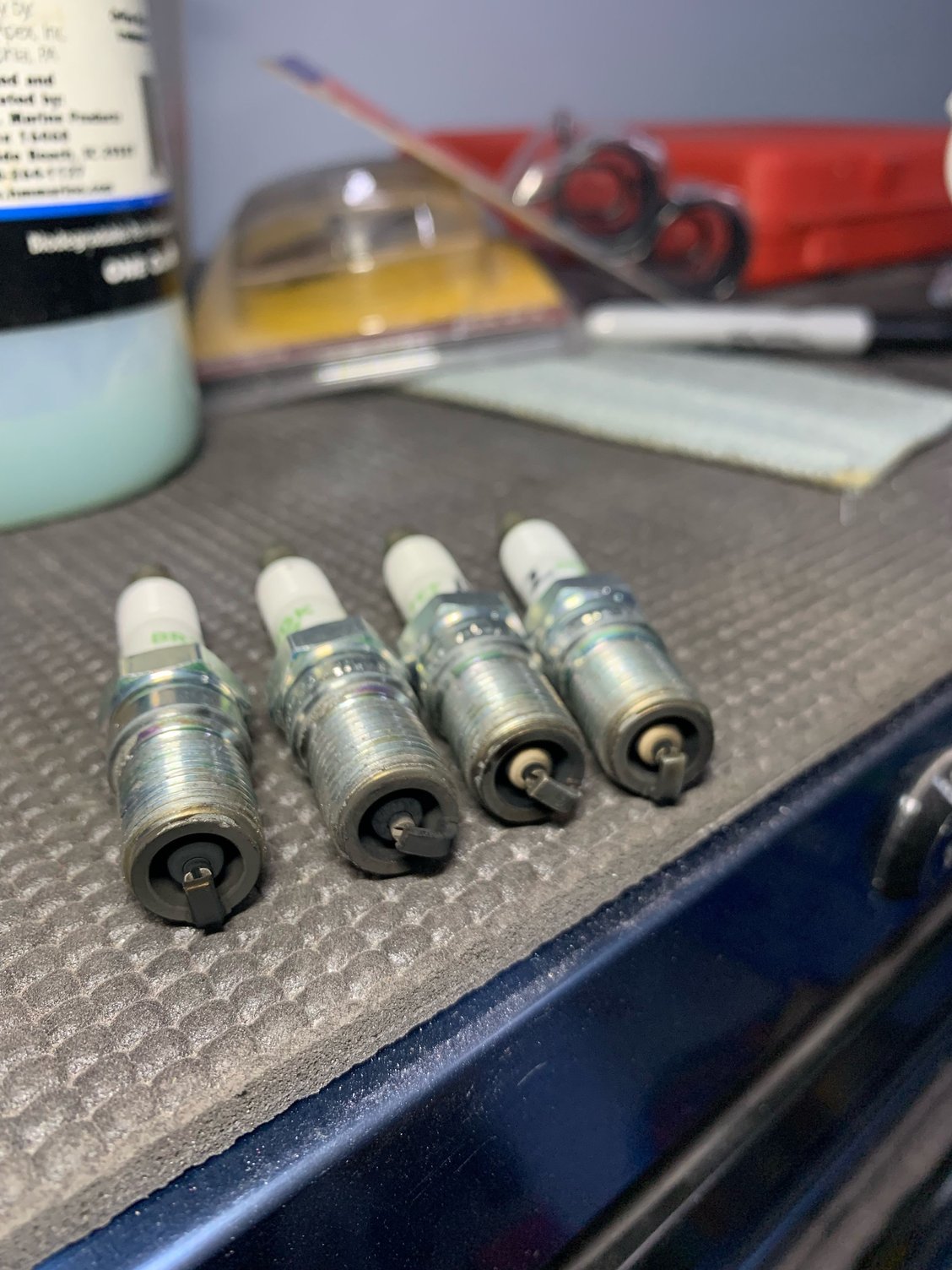

5.3LS single turbo with TerminatorX, worked fine with 55lb injectors and updated to SEP 1000cc and since day one, been having issues with dropping cylinder over time... to the point where anything 1/2 throttle and it would not fire in at least 1 cylinder.
I had a feeling something funky was going on, so I took the plugs, #6 and #8 where really black while the rest were descent. I cleaned them up good, went for a 10mi test and tune session, couple hit at 13 psi, and all seemed fine, then as time went by it started to degrade to then start missing again.
Parked it, next day I yanked the plugs and well...y'all be the judge but I think two injectors ain't flowing the same as the rest!
I'm thinking 6/8 are going so rich at 1/2 to WOT that it literally miss fires. bellow 1/2 throttle it seems to hit on all 8.
Car did not do this with the previous injectors....
I know I can adjust each cylinder fueling but this would seem to be a bandaid when all the other cylinder look exactly like #2 in the pic
#2 and #8
2/4/6/8 (right to left)

Replace the 2 bad injectors
Yeah working on that with SEP, just sucks to have two bad one right out of the box!

Second set is no better, #3 misfires (or doesn't). That's on new plugs too. Did the usual checks: swapped plugs, wire and coil between 1 and 3 just to be sure it wasn't something silly, wouldn't be lucky that way....SEC wants me to send this set back...so they are packed and ready to go, meanwhile I got a set of FIC850 ready to install...I don't have time to play this game....takes 2 weeks turn around (that's what it took the first time, 4 days to get there, 3days to test, 2 day shipping -at least that was nice of them to use 2day shipping).
Hope the FIC works out.
