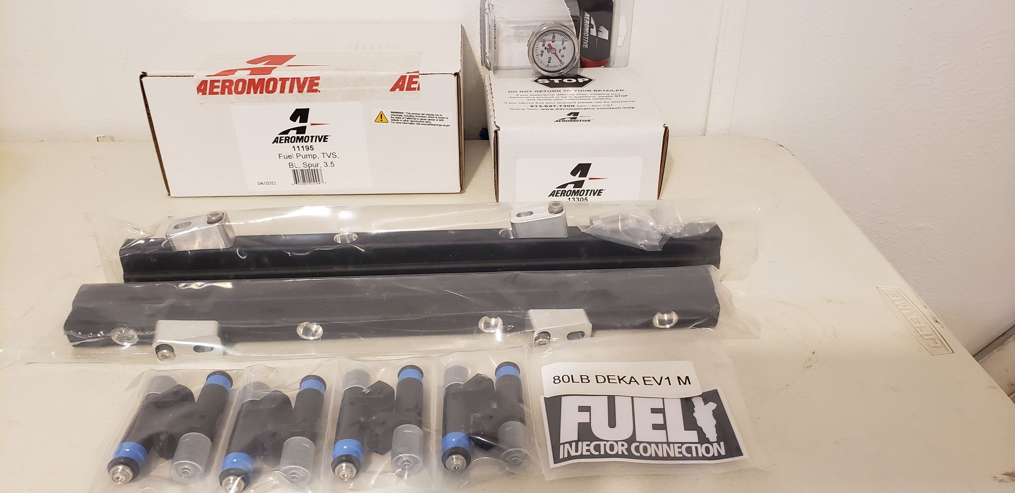

The pump shown in this picture is one of their best and can handle the methanol but it will set you back about $1400.00.
ok ok that should have plenty for more power in the future when I go with bigger cubes?
