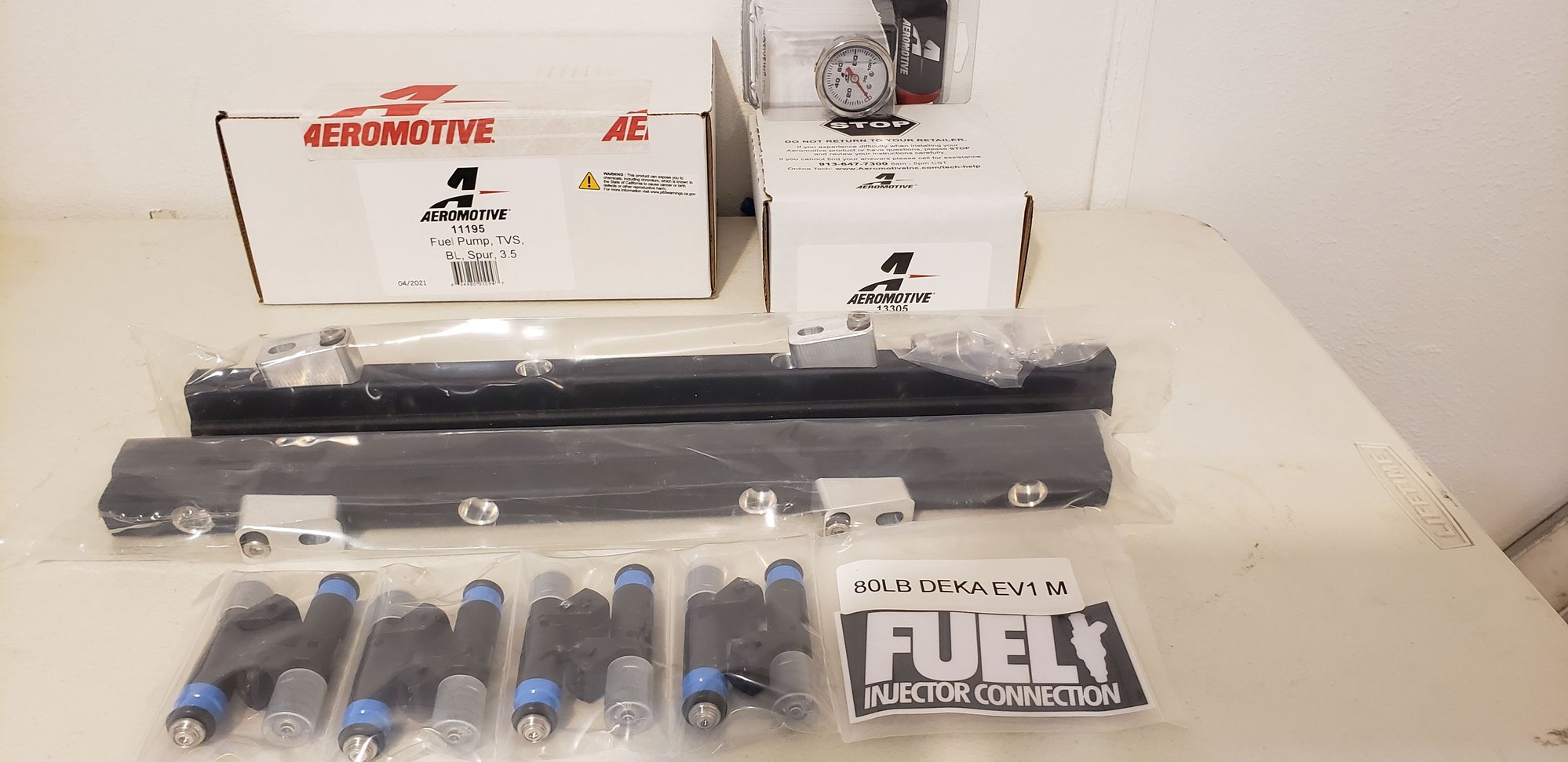

Depends on fuel and power goals but I plan on boosting the 99 at some point so for my fuel system I went with 8AN feed and return.
Thanks! I do plan on a decent size line just in case I want to bump the power up in the future. I like the Motion stuff, but it's pricey. I guess the power level is going to grow with the car. I'm doing brakes and suspension first, before I put the engine in. Will be more of a street/strip setup.

Yeah I was wondering about that and my tuner say's I'll be fine with them on E85 but my gut is telling me to go with 120's.
