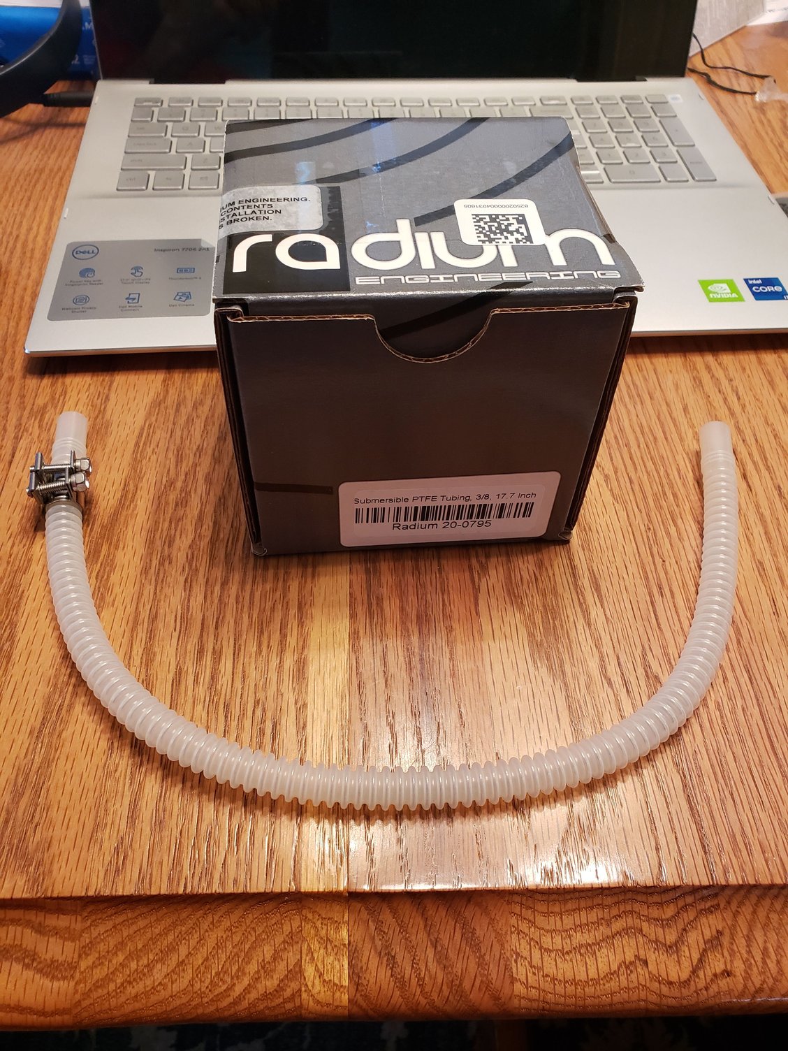

My dual Racetronics 340's are not able to keep up with my Bosch 210#, E85, BW S480 5.3 above 6,000 at 19psi. A buddy of mine told me about his dual Hellcat (525 Lph each?) setup. I ordered the pumps from Summit( cheap price is somewhat misleading if you buy on the assumption that everything that comes with other pumps will be in the box. All you get is the pump. No filter sock, no 'male' pigtail for the female pump connector). Remembering from prior pump setups, I knew I'd need some 'straws'. I had several of the 6" or so ones left over but I went to ee if any other/newer straws were out there. Yep, 16" long too. Plenty of length to allow more mounting options.
