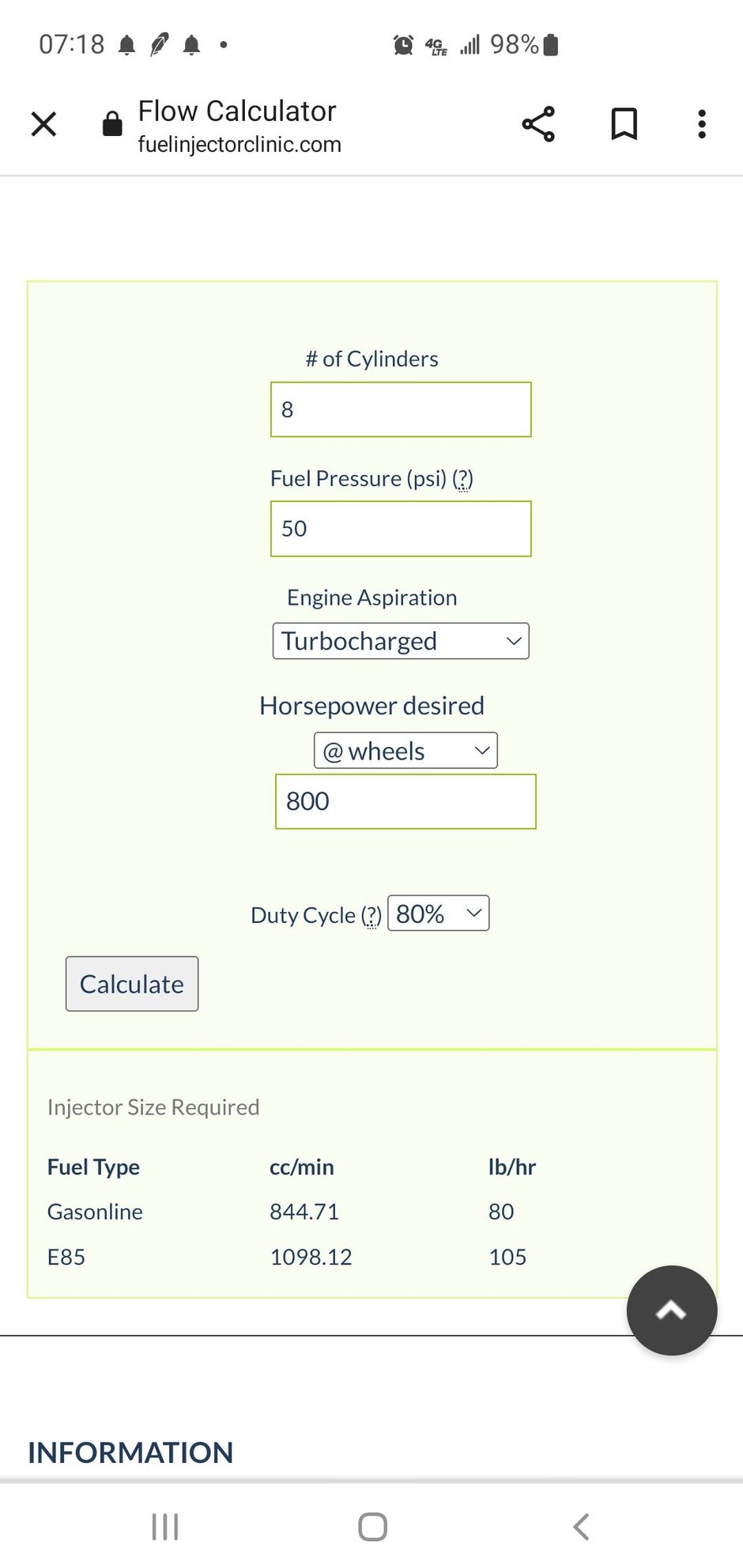

pull these calculations off Fic just for some simple math. either one of these will work for my current setup.
I could use the 80lbs on pump to hit 800hp or the 120lbs with e85 to hit 800ish with both under 80% duty cycle in theory, even with moderate fuel pressure.
