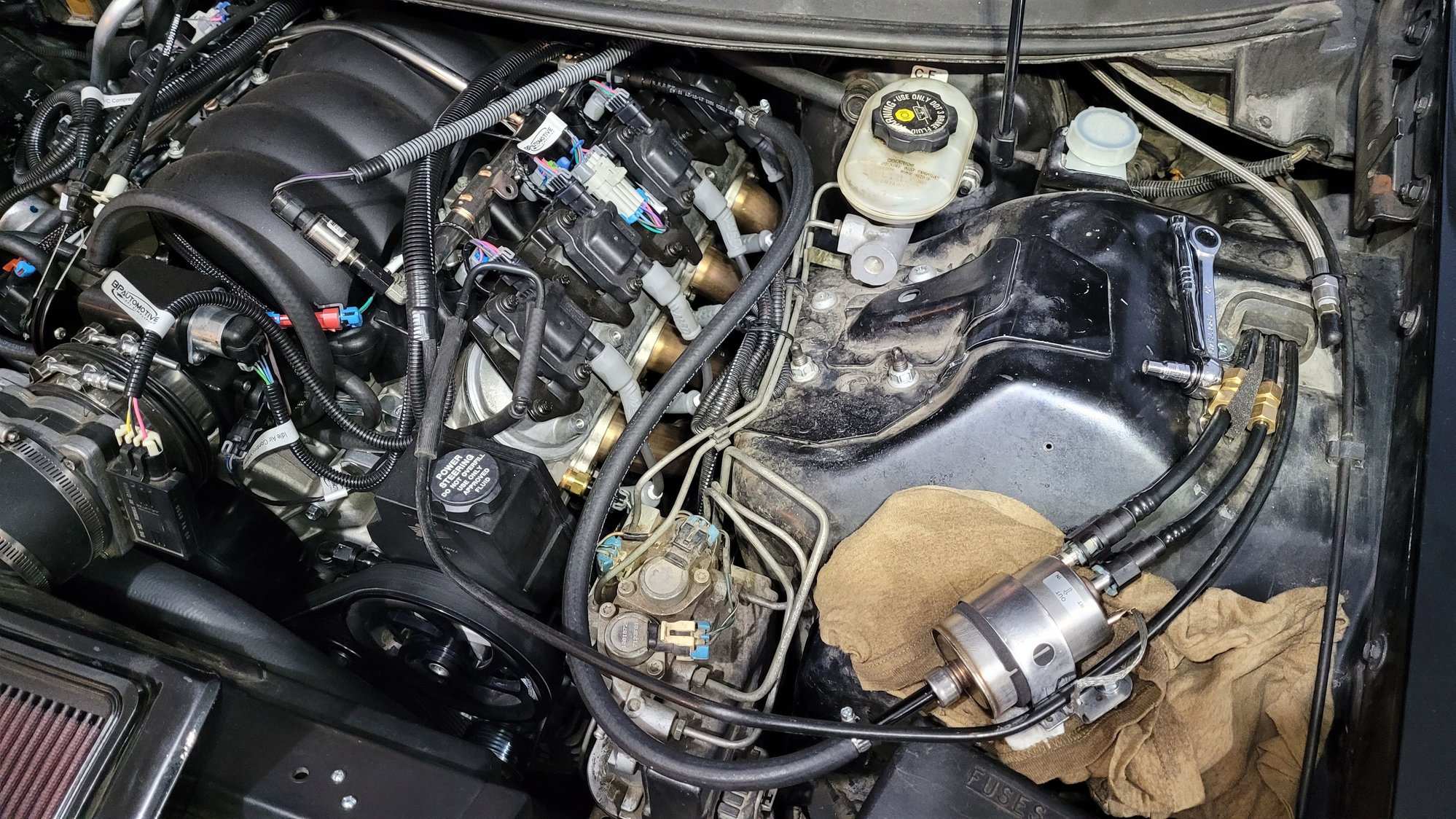

Did more troubleshooting today. I rigged up a totally new fuel system in a bucket to rule out the feed line from the tank and the feed line from the FPR to the fuel rail. Fuel pressure is still at 70 psi.
To recap: I've replaced the FPR, ran a new return line to a bucket, ran a new feed line using my spare fuel pump in a bucket, ran a new feed line from the FPR to the fuel rail and I'm still getting 70 psi.
I think the only other component left in the fuel system is the fuel rail. It was a brand new LS3 intake assembly when I bought it so not sure how anything could've gotten in there to clog it.

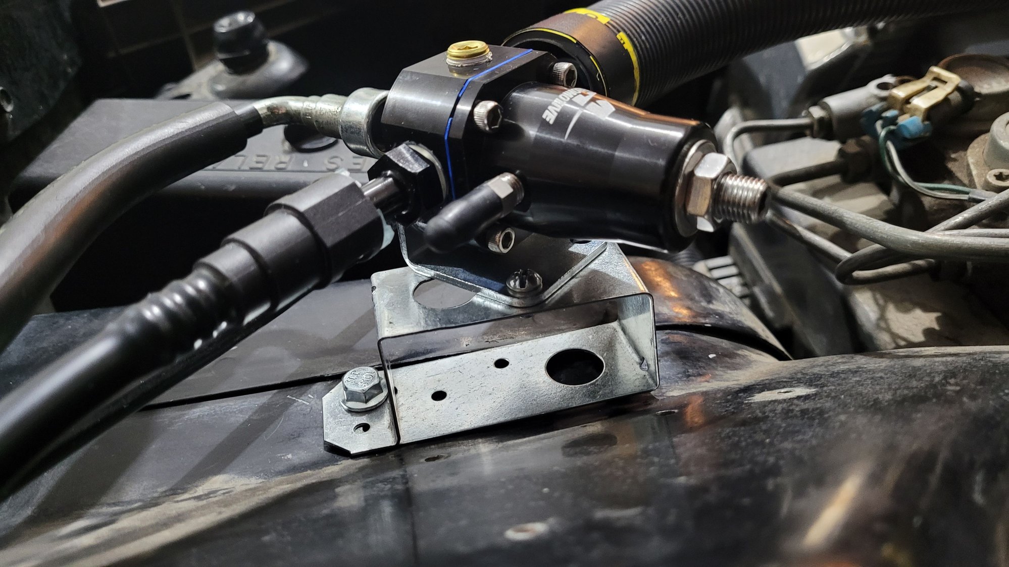

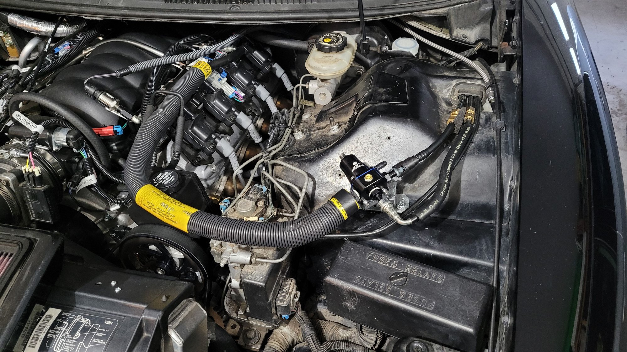

Old Mar 18, 2023 | 02:09 AM
  #33
AdsoYo's Avatar
Joined: Sep 2007
Posts: 1,444
Likes: 107
From: Bend, OR
Got the adjustable fpr installed. The instructions said to use o-rings but they didn't work with my Summit AN to quick disconnect fittings so I used ARP thread sealer. Everything works great, no leaks, fuel pressure now at 58 psi

Old Mar 18, 2023 | 06:15 PM
  #36
01CamaroSSTx's Avatar
Joined: Feb 2015
Posts: 6,000
Likes: 2,286
From: Conroe, Texas
What car is that? I've never seen an F-body with the fuel lines entering the left front wheel well like that. IMO it looks like a dangerous place for them to be routed. Perhaps the LT cars had their fuel lines routed in that manner.
Old Mar 18, 2023 | 09:00 PM
  #37
AdsoYo's Avatar
Joined: Sep 2007
Posts: 1,444
Likes: 107
From: Bend, OR
Yes it's a 94 TransAm. The fuel lines are stock nylon in the stock locations.
Old Mar 19, 2023 | 07:06 AM
  #38
Old Buzzard's Avatar
Joined: Jan 2009
Posts: 1,063
Likes: 475
From: Bostwick, GA.
Why do you have the vacuum port blocked off?
Old Mar 19, 2023 | 02:10 PM
  #39
AdsoYo's Avatar
Joined: Sep 2007
Posts: 1,444
Likes: 107
From: Bend, OR
So it doesn't fill with debris and such.
Old Mar 19, 2023 | 02:35 PM
  #40
Joined: Jan 2009
Posts: 1,063
Likes: 475
From: Bostwick, GA.
If it's not being vac referenced, it stays open.
