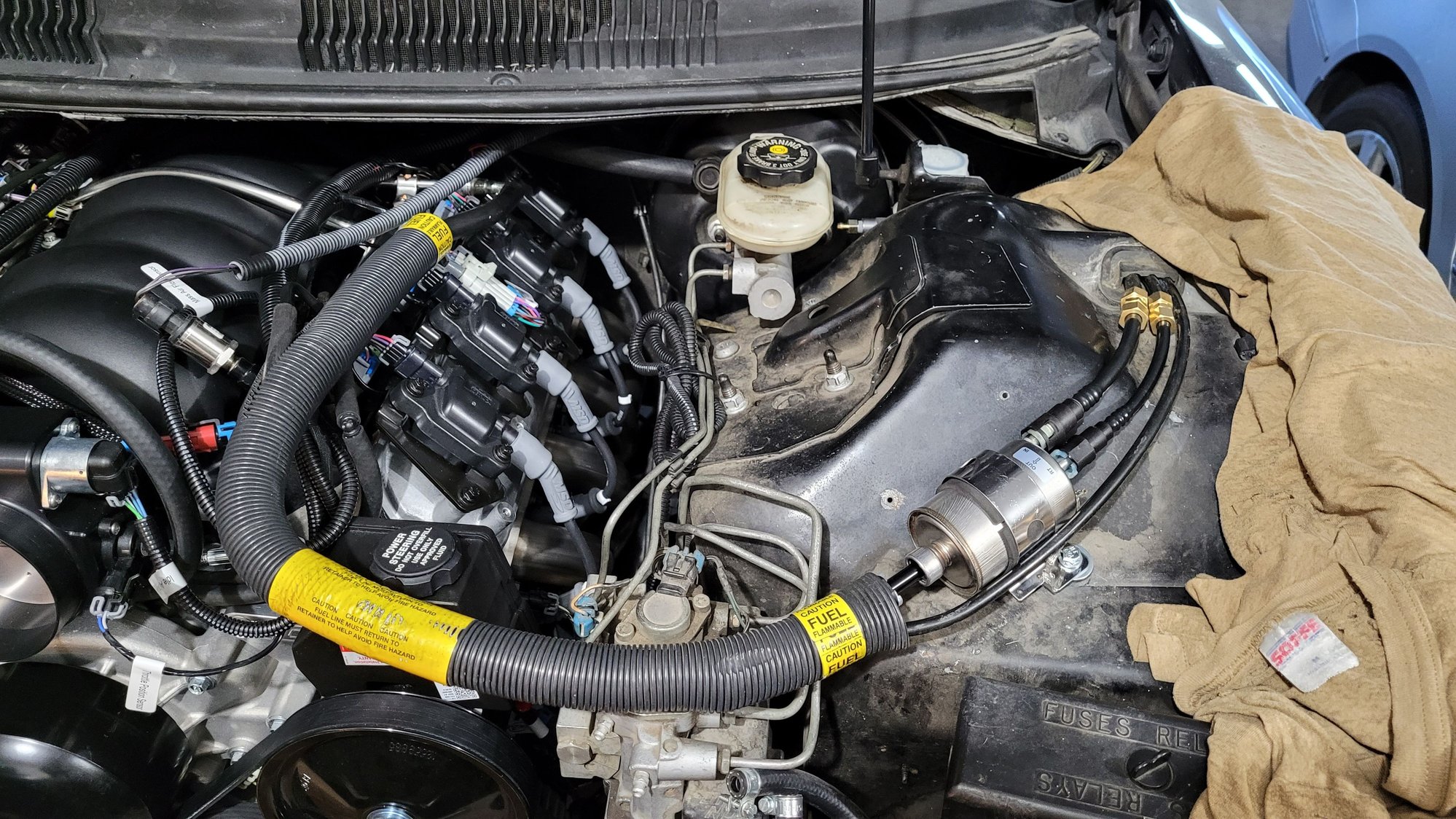

Just wrapping up an LS3 swap into a '94 TransAm. Got it started and running fine, even drove it around the block. One of the few remaining issues is my fuel pressure is at 70 psi. My fuel system looks like this:
stock tank and sending unit
Walbro 255 pump with Racetronix pump harness and upgraded bulkhead harness
stock lines including return line from engine bay
stock fuel filter delete
MasterPro (O'Reilly's brand) Corvette fuel filter/ regulator mounted in engine bay
Stock LS3 fuel rail
The fuel pressure gauge is an Auto Meter digital gauge I've had for years.
The car is running fine but on my logs it's clearly pulling fuel to compensate for the higher pressure. Not sure what I can do other than try a different FPR/filter. There aren't any constrictions that I can see.
Here is the stock filter delete and my FPR/ filter set up under the hood. These are the only places I messed with anything.
Old Oct 9, 2022 | 04:22 PM
LS1 TJ's Avatar
Joined: Sep 2008
Posts: 1,653
Likes: 530
Hate to say this but get a Wix or Delco FFR.

The filter should be as close to the tank as possible. Not sure if that's the reasoning of the high pressure. But still needs be be near tank.
You may just have a defective filter/regulator

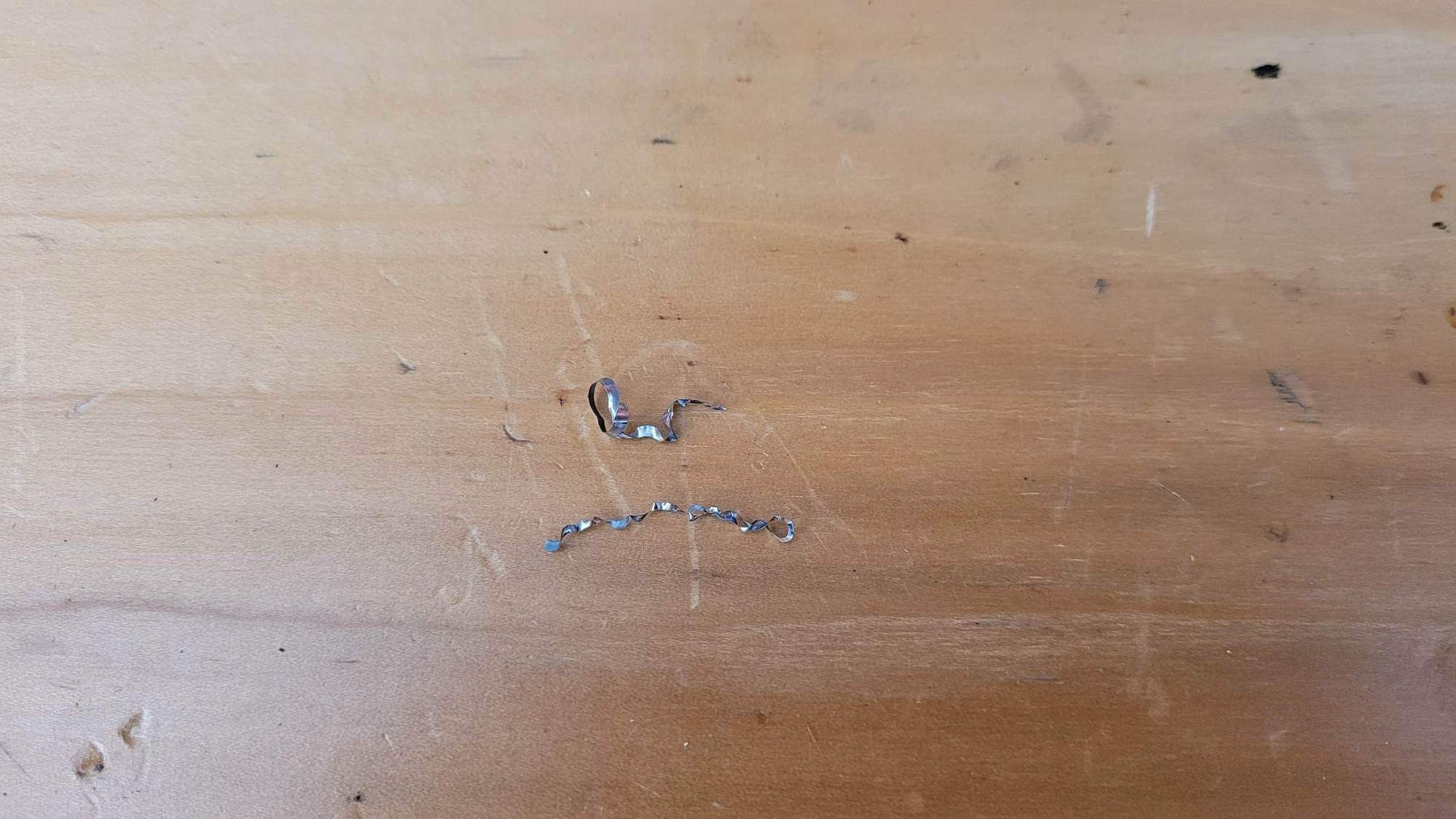

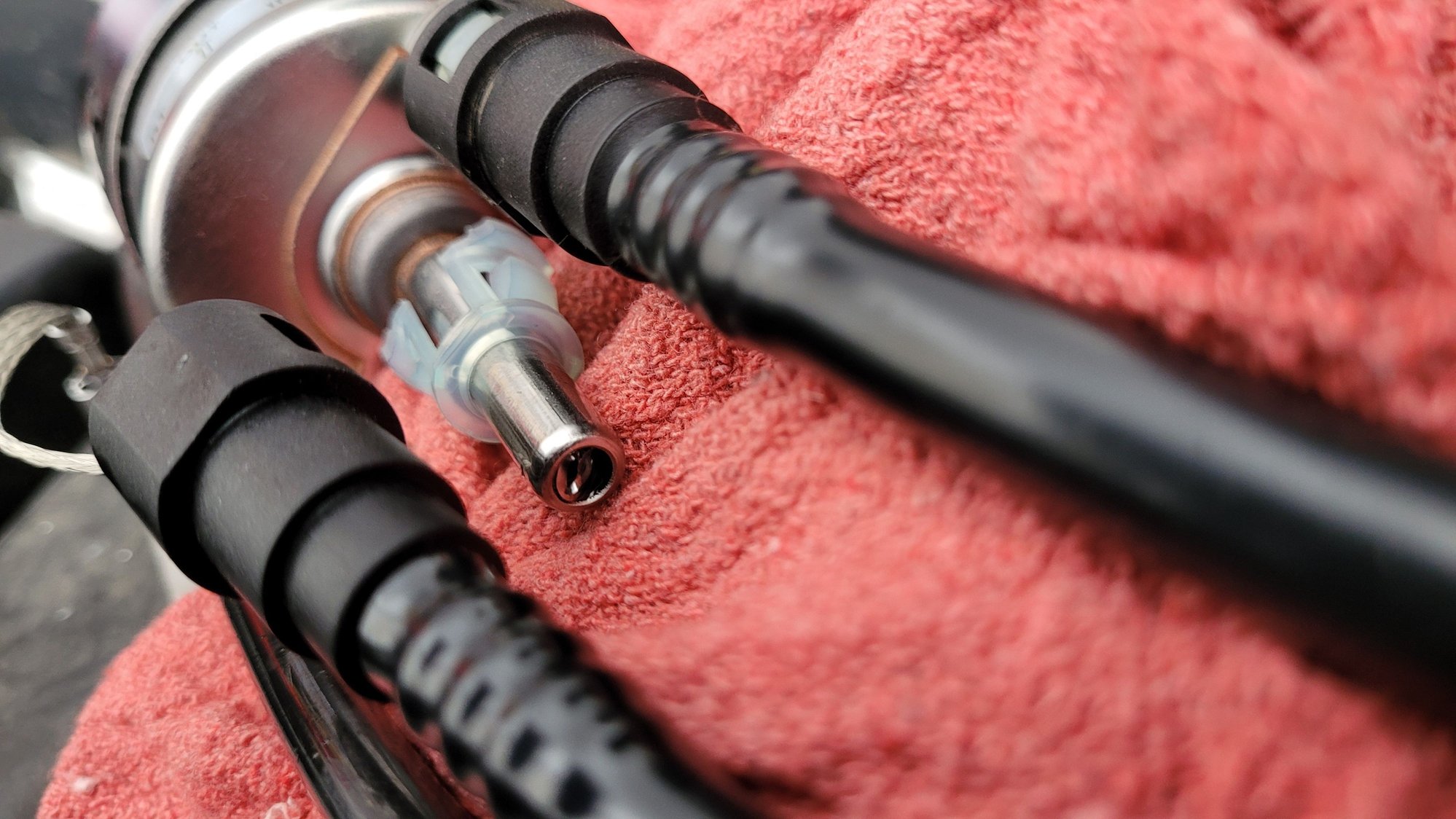

When I went to take the return off the FFR this is what I found.
Not sure how or why those got there but even with them removed my fuel pressure is still 70 psi with a line going into a jug. And remember this is my 2nd FFR so I'm extra confused as to how they got there.

That's not the return line.
Did you use the AN fitting repair disc?
That metal looks like it could be one of them.
We use red and black fittings to differentiate the flow paths.

"The middle is 5/16 and the outer is 3/8".
Regardless of the size, the port with the **** in it is not the return port.
