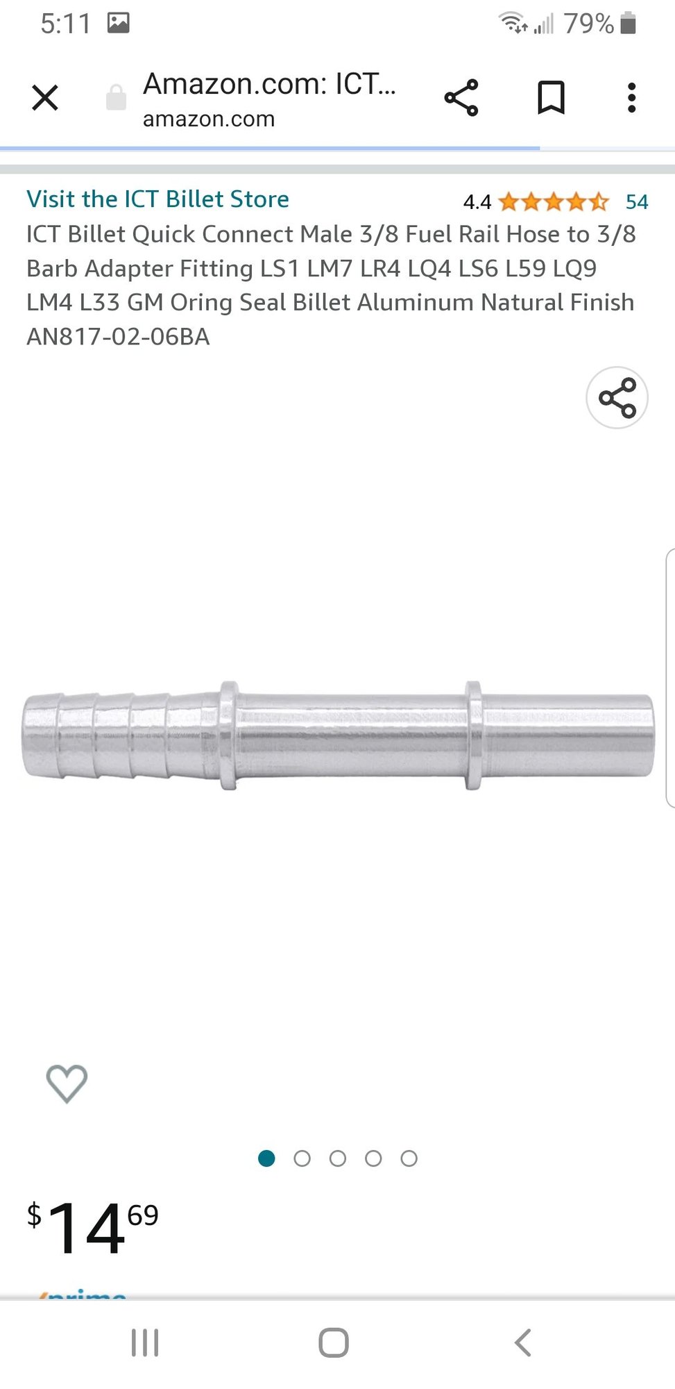

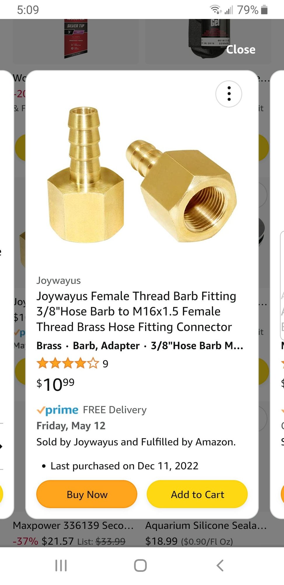

I just did this with my car. I did run it a couple times with the filter still in the line and didnt notice anything.
I then removed the filter and bought these parts along with a piece of 3/8" fuel line. Worked great. No leaks.
