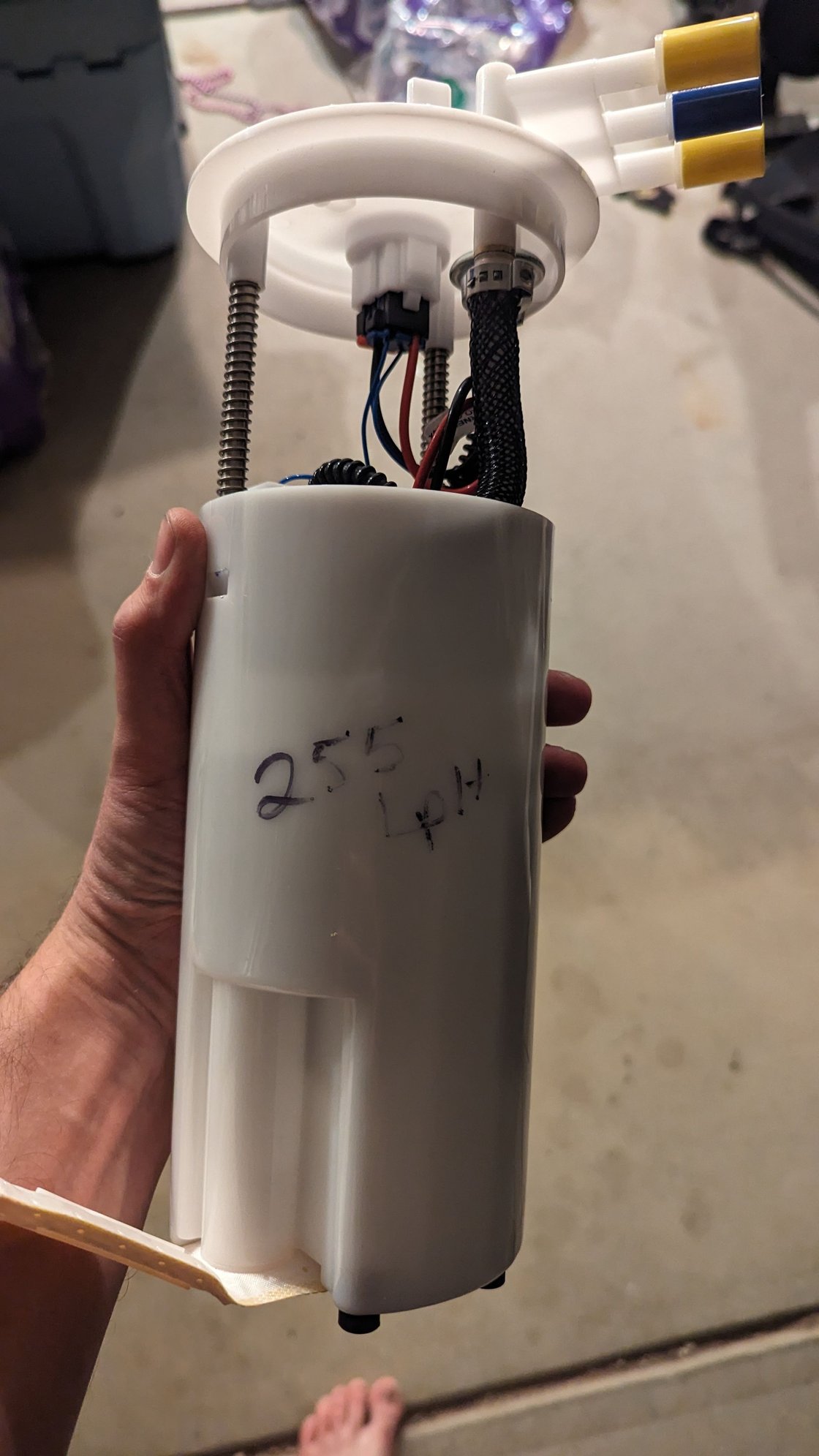

I recently bought a 2001 Trans Am with only 43k miles. The previous owner told me he had replaced the fuel pump at one point in time. A few months later and the fuel pump in it won't provide enough pressure to even start now. Maybe he bought a cheap one to get by.

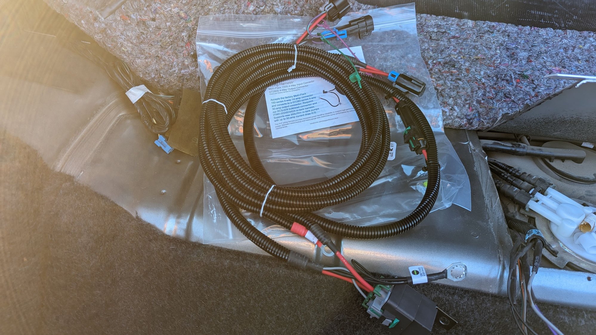

So I bought the drop in racetronix 255 lph kit from WS6store with the hotwire kit. Go to install it tonight and now I'm confused because it looks like it's not drop in/plug n play as I was hoping. Of course there's no directions so maybe someone can enlighten me.
Here's what I received in my order:
The hotwire kit is part number FPWH-017. The sticker on it says I need RCS-028 and the ITWH (which is already installed as I received it).

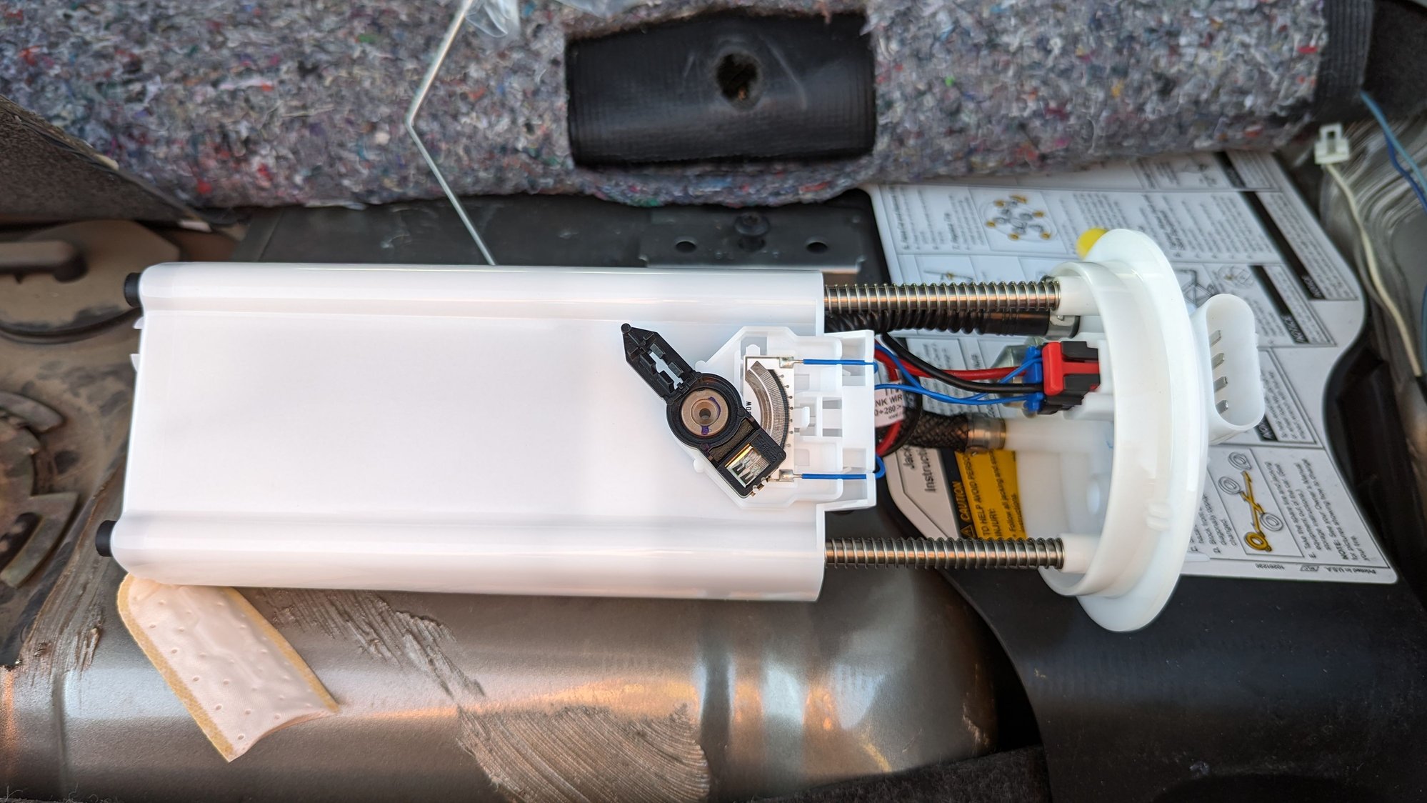

What am I missing on this? I know the RCS part should fill in the hole on top of the new assembly, but maybe I can/or I'm supposed to use the old one since the racetronix pump is already installed? Is the regulator missing or is that a new style?

The fuel pump module you have does not appear to include a pressure regulator (as you already pointed out). That's more typical of a 340 L/hr pump where it is expected you would re-plumb your fuel system with an external regulator. I would talk to WS6store on Monday and determine what you have vs. what you really wanted.
The Hotwire harness is correct. All Racetronix Hotwire harnesses now come with larger current ratings (25A) than in years past, hence the different "GT 280" type connector at the fuel pump bulkhead. It matches the style of connector on the aftermarket pump module you got from WS6store.
The old square "Metri-Pack 150" type connector with a stock fuel tank was rated for only 14A. You're better off with this 25A upgrade. If you put in an adapter pigtail to go back to stock style connector then it will knock down the current rating to 14A again.

I didn't take a picture of the back side of the assembly at the time, but it does say 255lph on it.

Went ahead and tried to install the hotwire kit today. Slow process because I was trying to do it right the first time. Fished it through the tank area, grounded the wire at the brake bolt like I've seen racetronix suggest on other threads, fished it all the way up, zip tied it along the way.
Went to hook up to the alternator and the damn post on the back spins the whole damn thing. Wrestled it for over an hour and finally got the top nut off. Bolted the hotwire kit red wire to it, now no power to the hotwire kit.
Checked the fuse on the hotwire kit and it's good. Checked the power going to the relay and there's 12 volts with key on, no ignition, but nothing beyond that.
This is getting to beyond frustrating now. Anybody have any suggestions? I'm smart enough to use an electrical meter to test things. I eliminated the post on the alternator by bypassing it with just channel locks. Seems like the issue is the racetronix relay.

Finally got it all sorted out (hopefully). After a few discussions on the phone with Ed from WS6store (awesome support) here's the rundown Incase someone else ends up with the same problem/situation as me.
First - the regulator is in the bucket instead of the top now and you transfer the pressure sensor over. That's not shown on the picture on the website, so maybe it helps someone else.
Second - since my pump was previously replaced, the previous owner had already changed it to a flat plug instead of the factory style square plug. Since the racetronics one comes as plug and play for the factory style, I had to rewire a square plug into the factory wiring so it could plug into the racetronics hotwire kit.
So if you're factory, it would have probably been a plug and play on that end. Still a pain in the *** to run it, but hopefully it'll run good.
