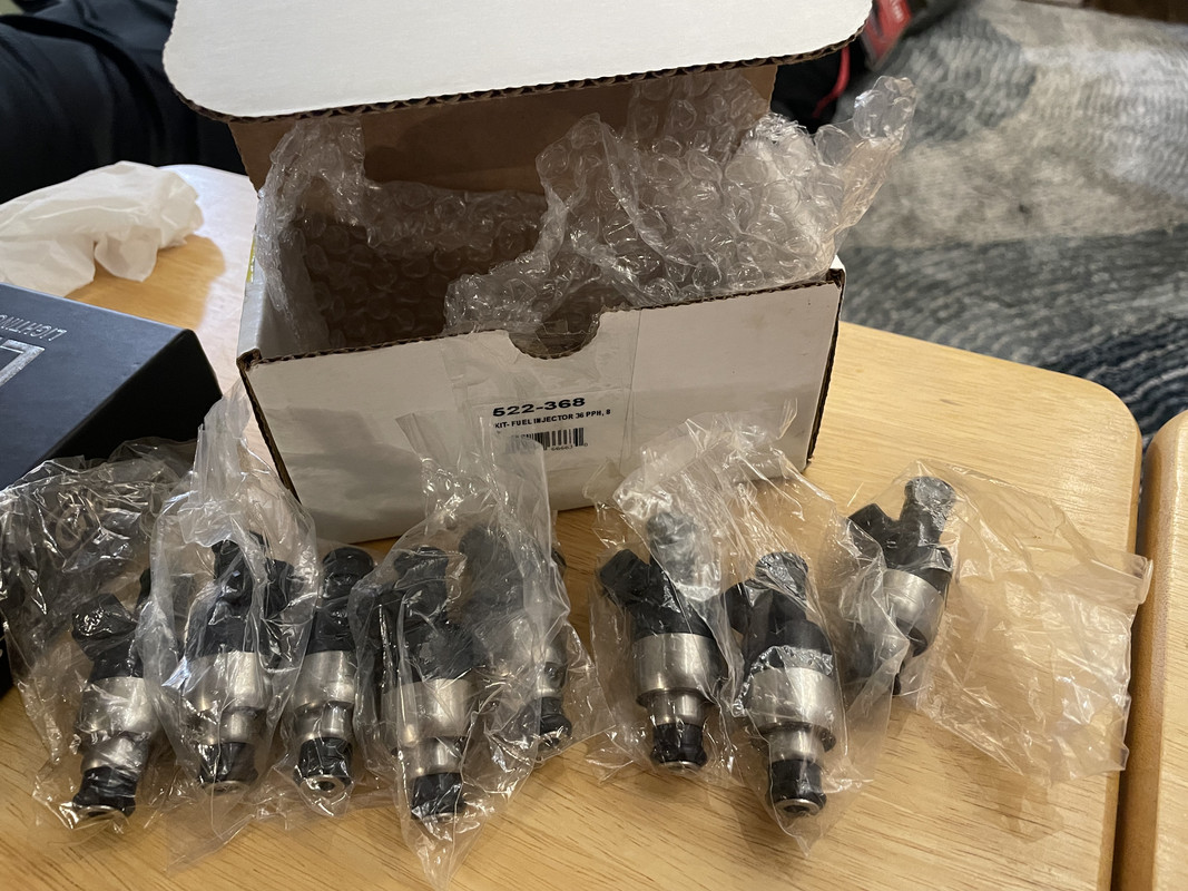

I ordered these off eBay, advertised and priced as genuine Holley EFI injectors. 36LB, part number 522-368. The box shows no signs of being from Holley other than the generic part number sticker, and the injectors themselves have no information or specs printed on the bodies. Are these real, or do I need to chase my money down?

I googled holleys website and from the looks of it they put the part number on the injector body. I've never owned holley injectors but I'd definitely be suspicious on no part number

My Holley 120's didn't come in a box like that they came in a sealed plastic board thing. The part number should be on the upper part of the injector not the shiny part

So just to update, they are fake and I got refunded. I’ll upload some pictures, but the key differences were incorrect packaging, no identifying data inscribed on the body, and the nozzle lacked the divider like genuine Holley injectors do. The o-rings are also the wrong color, and the inlet port also looks different to me.
The seller seemed honest and stated they had sourced them from here, who are also advertising them as genuine Holley: https://www.redline-motorsports.com/...ts/hly-522-368
Be careful out there and always inspect your parts!
