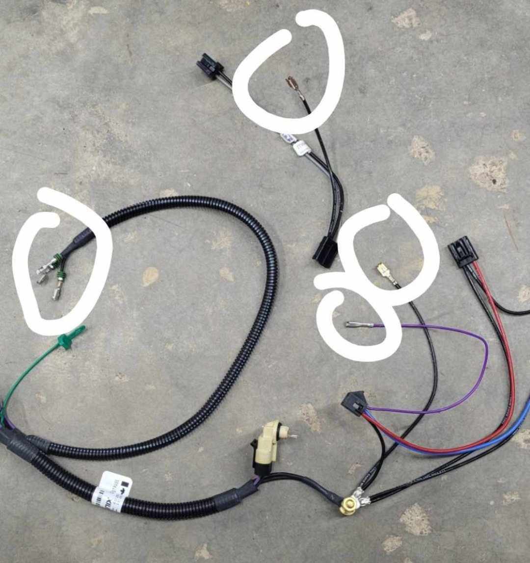

I'm installing twin pumps on a 1998 car. 1 pump will be on a hobbs switch. I'm open to having both run all the time though, as my return will be 6AN ptfe line on a boost referenced regulator. I'm unsure what even half of these connections are for. This is a racetronix bulkhead connector setup.

I'm still building my car, but I did this install on my stock hanger a year or so ago and I have pics somewhere. Might take me a week to find them, unfortunately. They were on an old phone. I will say, when I talked to the WS6 store, they said there's zero issues with running both pumps at the same time.

What harness part number is that? For a 99-02 for example, the Racetronix goto with a hobbs switch is
UDPH-005
IDPH-F99HD
DP-ITWH-042
HIH-001
HPS-7
What pumps are you running? It’s best to convert to the newer bulkhead. Racetronix can get you setup with whatever remaining harnesses or end plugs you need based on what you have to convert the 98 setup. Just tell them the setup and that you want to run both pumps full time with no hobbs switch.
This is not designed for twin pumps.
This would be a F98 DP wiring solution:
UDP HD Fuel Pump Wiring Harness (MP280)
Item #: UDPH-005
Unit Price: $130.00
In Stock & Ready to Ship
Intermediate Double Pump Harness F98
Item #: IDPH-F98
Unit Price: $79.99
Hobbs Interface Harness 72" - DPK
Item #: HIH-001
Unit Price: $17.50
Pressure Switch, 7PSI, SPST M/P280S
Item #: HPS-7
Unit Price: $27.07
Running both pumps all the time is a bad idea for a number of reasons.

Everything you just listed here, is everything I have.

The purple wire on the in tank wiring is for fuel level and the black is a ground. The two loose wires on the intermediate harness will go into the fuel pump bulkhead at the rear of the car above the rear end. I'm not too sure what the little harness is all about.
I will note that I had one hell of a nightmare on my 91 Z28 with this double pump harness. None of it worked correctly. I was back and forth with Racetronix and still got nowhere. Power just would not get to the pumps at all. I ended up pulling the main harness out and used the sender bulkhead and in tank wiring harness then cut the main harness up and wired up the pumps myself and haven't had a single issue

Here's a detailed write up of an install of those exact harnesses (UDPH 005, IDPH-F98, and HIH-001) on a 98:
https://ls1tech.com/forums/fueling-i...ct-review.html
Post #15 in this link and onward.

For anyone stumbling upon this in the future, post above covers everything.
