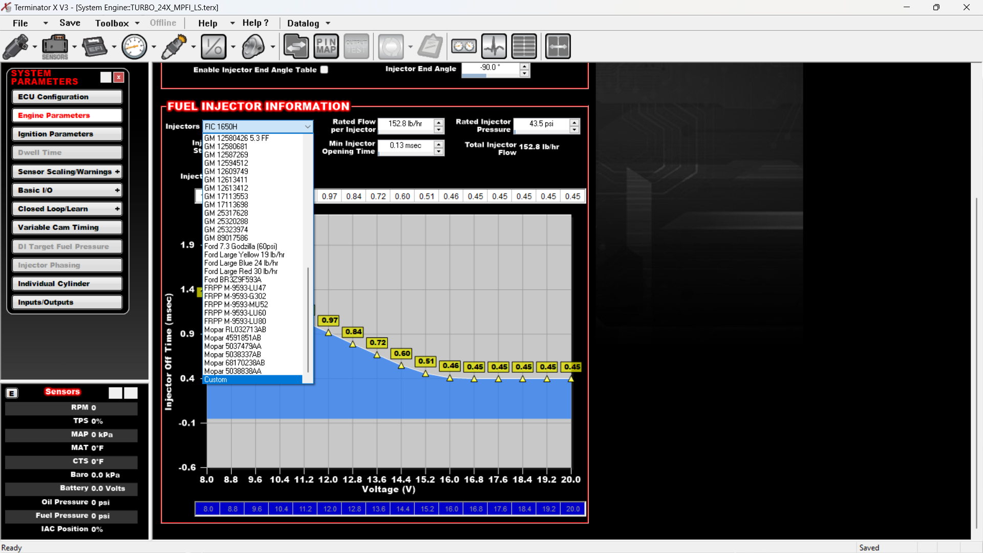

Hello all i am wiring up my Terminator x on my LS swap and my injects are not listed in the terminator x, i have the injector data and all the info needed to add them to the terminator x but i need someone to do it (i have no experience/knowledge).

It's easy enough to do. Just open your tune, click on the ECU icon up top in the software then click the drop down menu for injectors and select custom. After that you'll input your injector data in the bar just above the graph
This is where you select custom injectors

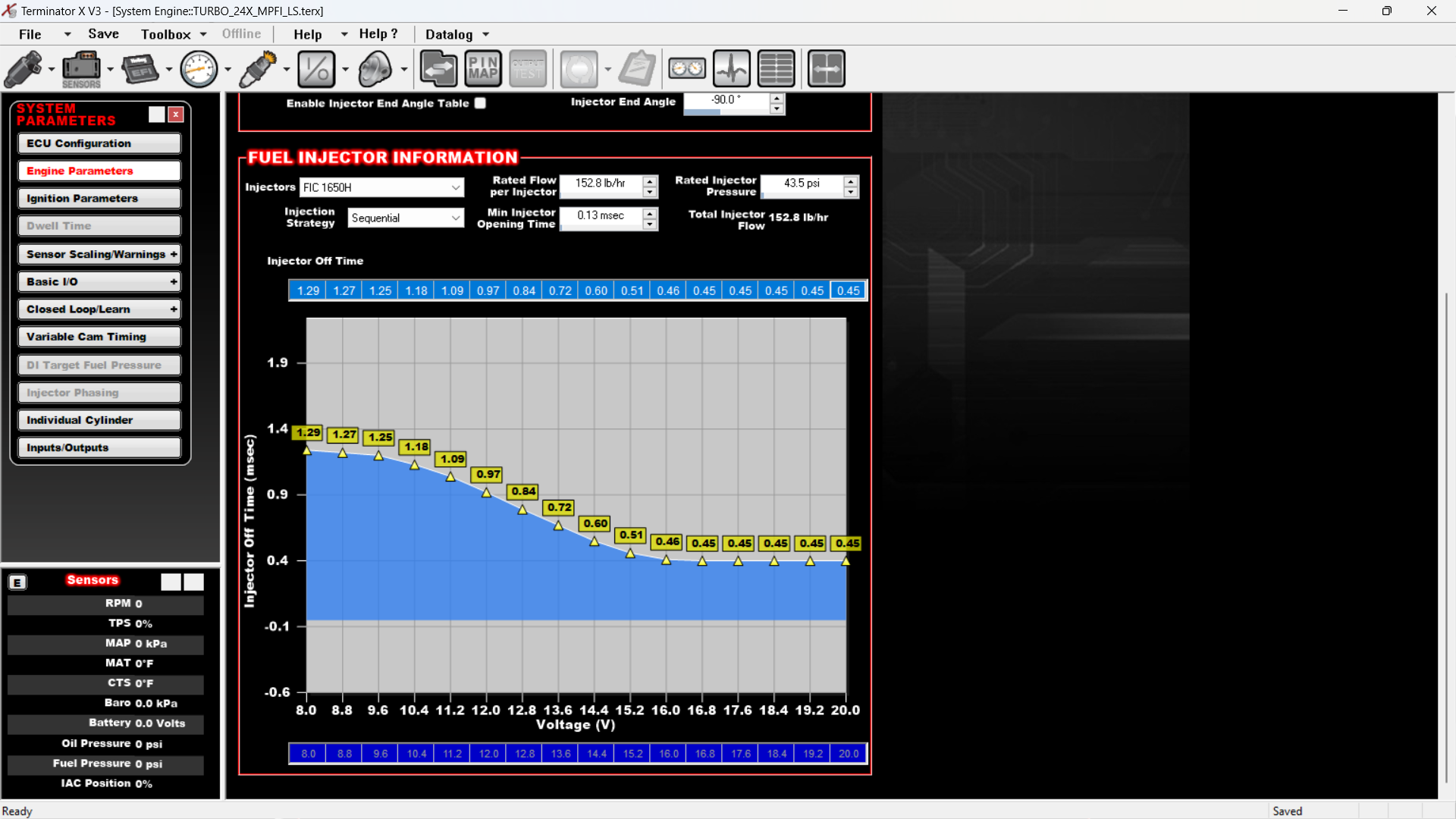

The bar right above the graph is where you will enter your injector data. Make sure you enter the rated injector pressure and actual system pressure correctly
The bar right above the graph (injector off time) is where you will enter your injector data. Make sure you enter the rated injector pressure and actual system pressure correctly
