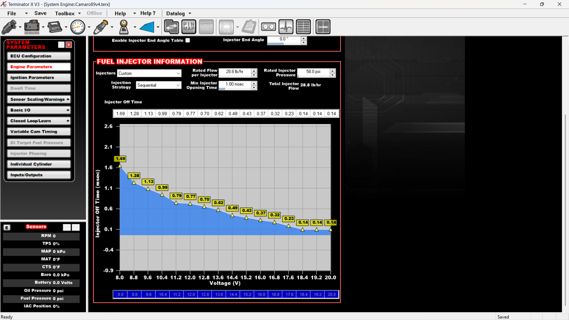

Installing Terminator X Max on a LS1/4L80e combo swap in an early Firebird T/A for a buddy and need a little help.
The engine has 12561462 injectors and my Internet searching has come up 28.5# and 30# @ 58psi. Can someone please confirm the correct flow rate.
This injector is not listed on the Holley dropdown list. Is there one in the list that is close ? Better yet, can some post up the injector data or a link so I can do a Custom. Sorry for being picky but would prefer the data in Holley format. I could fudge something up in a spreadsheet but that data is not usually linear.

Those injectors are supposedly from a GTO I found a thread with Terminator X and using this injector data. And here is the thread https://ls1tech.com/forums/pcm-diagn...ey-term-x.html

AWESOME!! Thank You.

Yea no worries I just helped a guy out a few days ago with these same injectors that had no data. Small world
