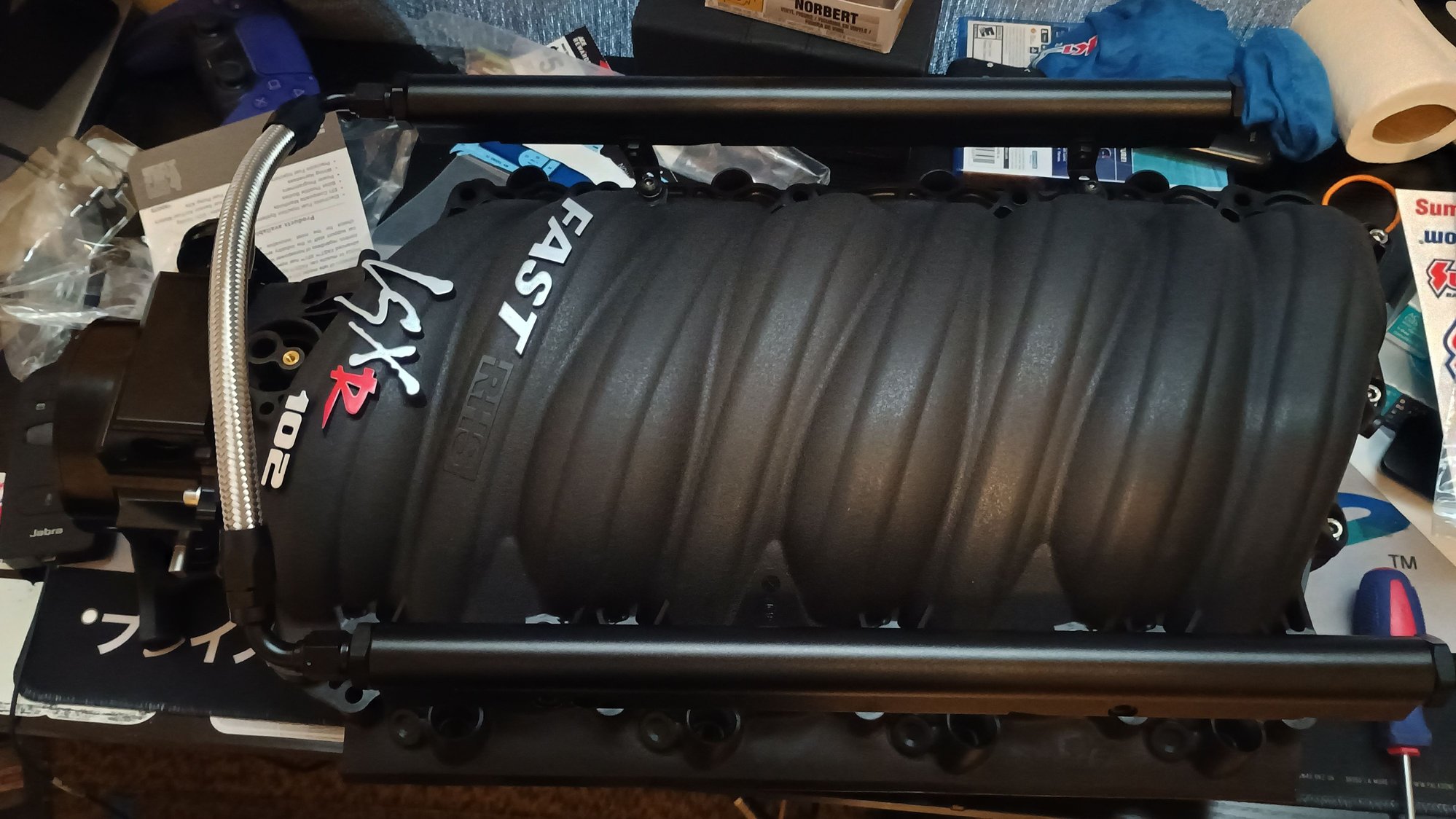

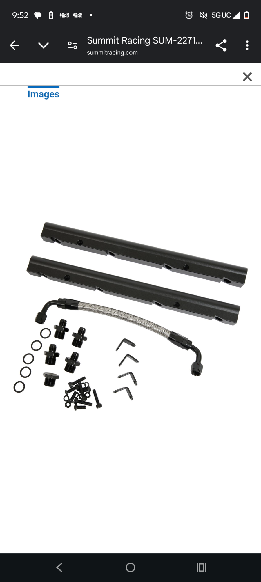

Hello working on some add-ons for my build. Have a fast 102 I'm setting up but trying to to find an alternative to fast fuel rails. My current fuel rails are the OEM LS1 fuel rails with GTP injectors. I bought summit racings 227152 fuel rails (cheaper than fast brand).
I'm trying to determine what makes the difference in regards to fit/recommendations besides the fast fuel rails. Sounds ridiculous considering the cost already in just the intake itself but don't see the point in buying something if not necessary.

I think this fits right, gonna try one of my injectors to make sure it's the right length/seats properly. On the website summit only recommends using fast fuel rails with the fast intake but if this works it's a win-win for me

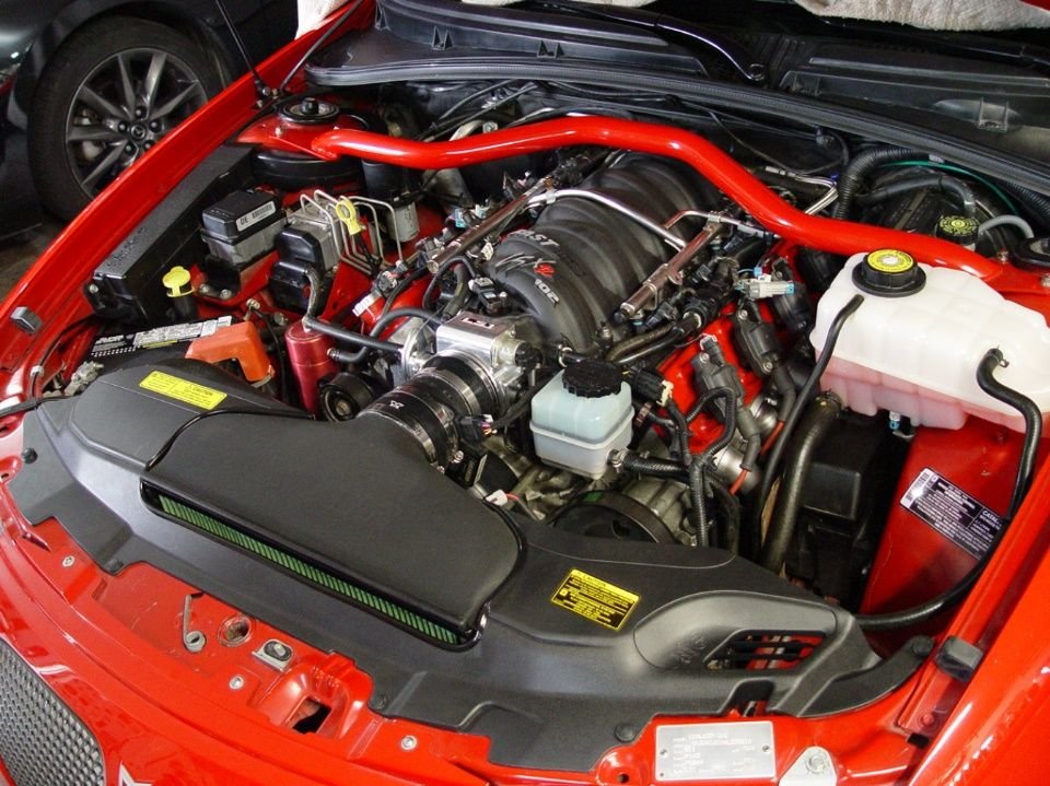

Stock LS2 rail fits the FAST 102 and stock LS1 rail fits the FAST 92. (Assuming stock sized injectors of course.)
This is the FAST102 on my 04 GTO using a stock LS2 fuel rail.

I ended up taking them back/got cold feet on trying something that wasn't "made to fit" but I didn't see the issue tbh... Wish I did more research on it, feel like I'm spending more money on this whole setup than what its worth. Switched to a fast 102 so that I can end up getting my direct port setup for a 150 shot but thinking I would've been better off just keeping the LS6 with a plate lol. I'm now trying to find the fitting that goes from my factory fuel line (2000 Trans Am/Fbody) to an AN fitting. The ones I've seen don't look like they would hookup correctly but Quick Connect and AN fittings are something I'm still learning about.
