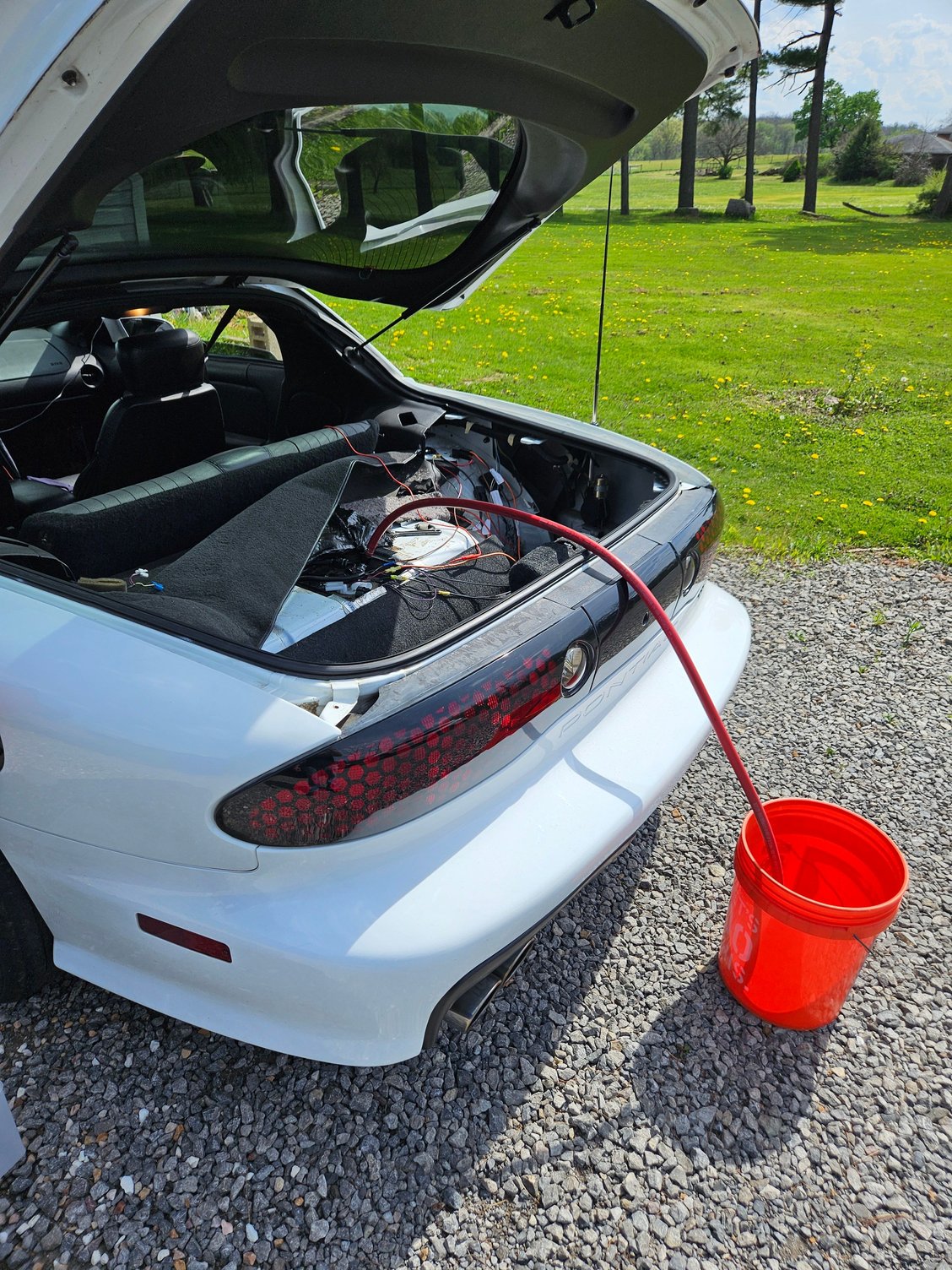

Tested my fuel pumps today and found out that my 535 is under performing big time. Pumping for 1 minute the 535 only pumped about 1 gallon. I then Tested the 450 and it did about 2 gallon in one minute which is right on par.

Do both pumps have check valves ?
Old Apr 28, 2026 | 10:04 AM
Old Buzzard's Avatar
Joined: Jan 2009
Posts: 1,063
Likes: 475
From: Bostwick, GA.
Those are free flow numbers.
What's the answer to No Juice's question?
Testing the free flow does nothing toward checking for the leaks I asked about in a previous post.
