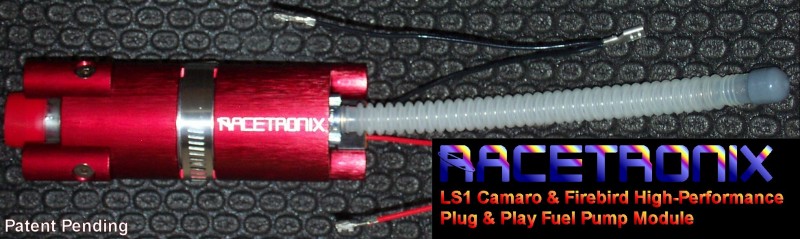

The function of the F99+ pump assembly is covered in our ad here:
The F98 does not have the same features as the F99.
There are other unique features specific to the F98 module.

The 98 is unique. Our custom jig aligns the pump in the factory location. It allows the factory sock to be adapted to the pump. We include the proper size & type flex tube vs. rubber line. We include new in-tank wiring (no adapters) as some are rotted due to the age of the cars. The F98-FPA is available from Racetronix dealers for $159.99. We recommend the complete package with harness because without it the pump takes a considerable performance loss.
