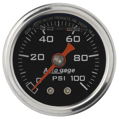

F...K the gage I got from Casper's is 1/4" Summit has a nice one for $31
Notes: Will directly screw into any 1/8 NPT female port.
Maybe I can drive in or have it shipped for another week long wait.

Well I got a 1/8x1/4 adapter for now, but I'm not impressed with the gage from Casper. Quality looks alright, it's the appearance I don't like. The Summit one is also a rear feed which I think will look better on the end of the fuel rail.

I ended up using this one
Not sure if I'll leave it, but it's nice to have handy.
