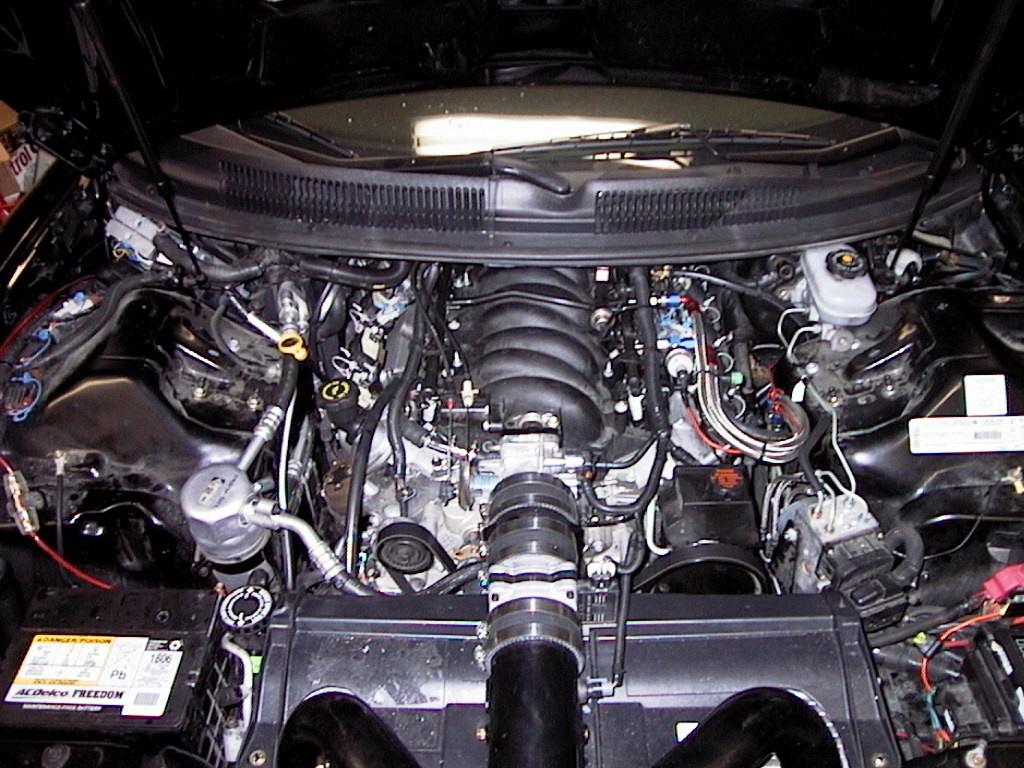

crossover is in the same location as the single inlet rail. The return line on this rail is basically the same location as the feed on the single line rail. The feed on the returning rail is on the same side, about 3 inches in front of the return.
The regulator is in the same location as the damper on the single rail.
http://harlan-engineering.com/incon/...nal_engine.JPG
you can kind see where the 2 lines are in that pic, where the braided lines make the 90° bends toward the rail.
