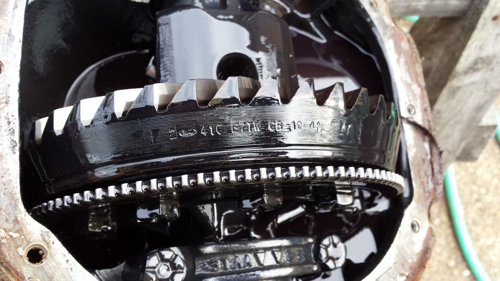

I got to work on my 8.8 today. Opened it up to find 4.10's
I'm real happy about that. Gears looked great! I also got my housing cut down, I still have some grinding and deburring to do.
