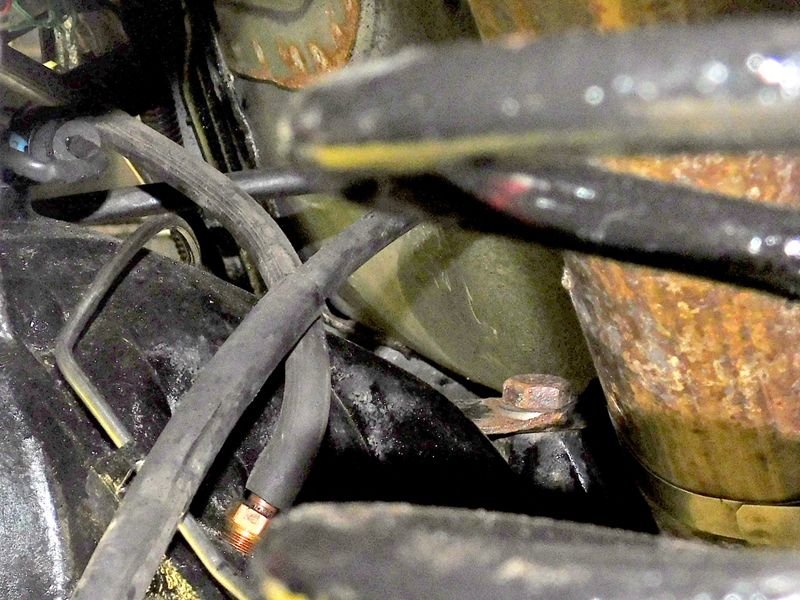

Put a TA performance girdle on the rear end today. This is my first 7.625 10-bolt differential, I like to check the vent and make sure it isn't froze up. I was not able to locate the vent. I tried searching the forums and found nothing. Anyone know where it is?

passenger side on top. pic shows a tube fitting that I use to replace the plastic vent fitting that was pressed in. I tap the hole for 1/4npt. OEM fitting is plastic and pressed in(hole is 7/16" diameter) and has a plastic non-removeable cap that acts as the 'vent'.
Attachment 586321
Sorry for the thread resurrect, but do you just leave that open to the air, or do you have some sort of protective cover to keep debris out? If the latter, what are you using?

I put a section of rubber hose that fits on the fitting and zip tie it to the panhard bar support bracket,with enough extra length to allow for rear end up/down movement.

With nothing on the end of the hose to prevent ingress of water, debris, etc? Is your car street driven? Does it ever see anything other than warm, dry weather?
My car is street driven, and it sees all types of weather except for ice/snow/slush, and all types of road conditions except for salted. The axle I bought has a hose barb fitting like yours, and I’m trying to figure out what I should attach to it. I was thinking of the hose approach you described, but with some sort of dust cap on the end, similar to the factory thing.

Nothing on the end, street driven daily. The 4L60E comes with a open vent hose. Never encountered debris/water upon inspection.
