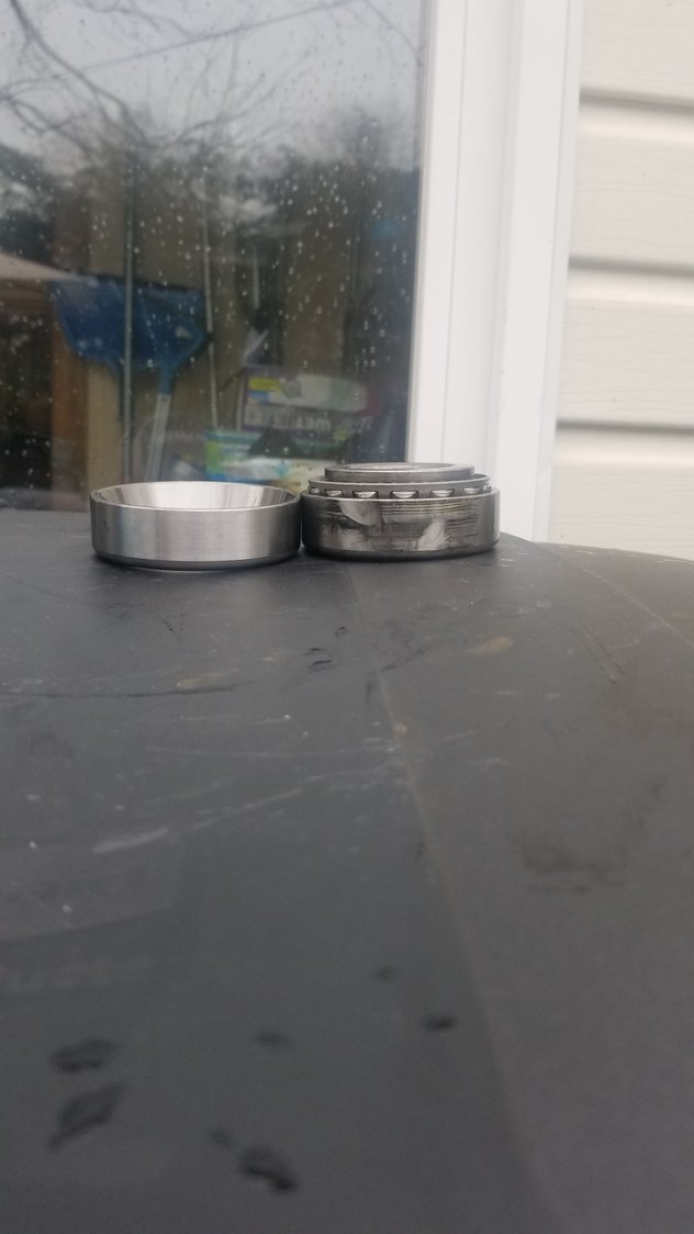

Long story short, I am rebuilding a ten bolt for my car as a learning experience more or less. So far its been smooth until I reached this point. I have a Ratech spacer with shims and all the pinion bearings and races have been replaced. I reused my old ring and pinion and reused it's pinion bearing shim as a a starting point. I measured the old crush sleeve as a starting point and shimmed my spacer accordingly. The problem i run into is if I torque the pinion nut to 125 ft lbs (as per Ratech) I get wayyyyy too much resistance. Despite adding numerous amounts of shims, this problem continues. I actually accidentally bought two solid spacers so i had ten shims to work with. There is no slop or play in the pinion after I have tightened it down and if i simply nug up the pinion nut up i can achieve the pinion preload i am looking for but this method is like treating it like a crush sleeve. I even take a punch and tap the pinion gear after tightening the pinion nut to ensure the bearings are seated (as per some video i saw on youtube).
So what the hell am I missing here?

Well after cooling down and checking it out again this morning,i have determined its something with the inner race. I drove it in flush but the new bearing does not seat against it fully. I tried the old bearing and it was the same way. It appears that does not allow the bearing to pull all the way in for whatever reason. Its like it pinches on the taper alittle too much. These are national bearings and races. It took some effort to get that one in there so I am not looking forward to trying to drive it back out. Anything I should try before i do so?

Never mind. I got it out and not surprisingly the new race drove in properly, easily and the race driver actually fit it. That should have been my first clue when I was assembling it. Check your parts boys and girls. Right is the bad race, left is the good.
Bad race. Not properly machined to accept bearing.
Good race. Same brand, same part number.
