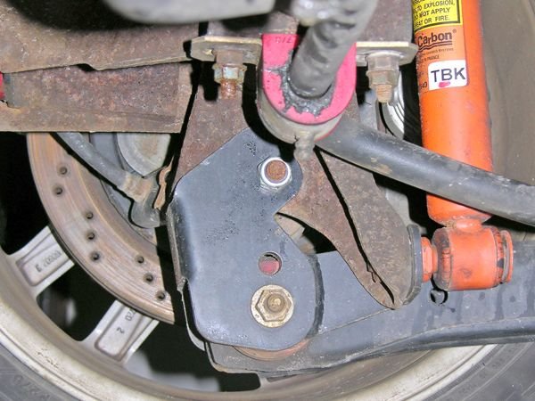

Get yourself a set of bolt-in LCA relocation brackets to help 'plant' the tires. Bolt-in, no welding. Relatively easy to install, rearward LCA bolt and shock lower bolt, and some pushing/pulling to line up for bolt insertion.
I have a set I'm willing to sell, hit me up if you're interested. Mine were from UMI and still in really good shape.
