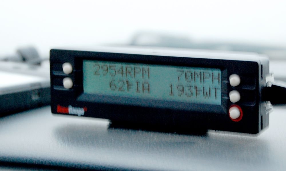

4.10's and 60 mile an hour at 2250? I have a 4.11 gear in my car now and @60 miles an hour my car is 3200+RMP. Now my setup may be a little different than yours but i don't think 4.10's @60 MPH and 2250 rpm go together.
Old Feb 24, 2020 | 06:47 PM
SLP IROC-Z's Avatar
iTrader: (16)
Posts: 1,062
Likes: 212
From: Salem, NH
4.10s @ 60 = 2350rpm with a 25.5/stock size tire

Here's a pic of my ScanGaugeII on the way down to Florida from Ohio. It plugs into the OBD2 port and reads parameters off the factory computer. The dash tach reads about 150rpm higher than the ScanGaugeII. Has many items to read, pick and choose. Rear end gears are 4.56s'/A4. Would have been 3000rpm at 72mph which equates to 2650rpm had it been with 4.10s'.
