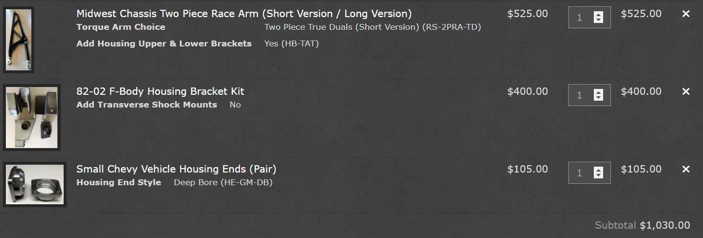

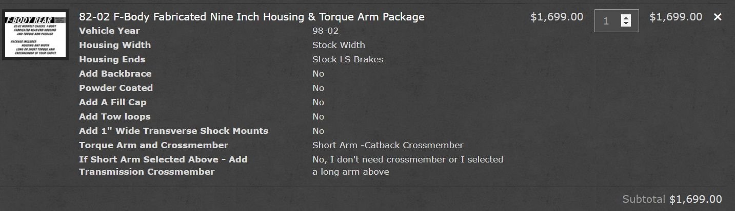

This is the only way I have known anyone to do it. The housing end choice may change depending on brakes.
Or you can let us do all the welding and end up with a fabricated housing over a stamped steel housing and get a better product that is stronger and lighter.

People purchase our two piece torque arm all the time for the QP housing however we have never done it in house so I do not have tech advice on what they are doing to make it work.
