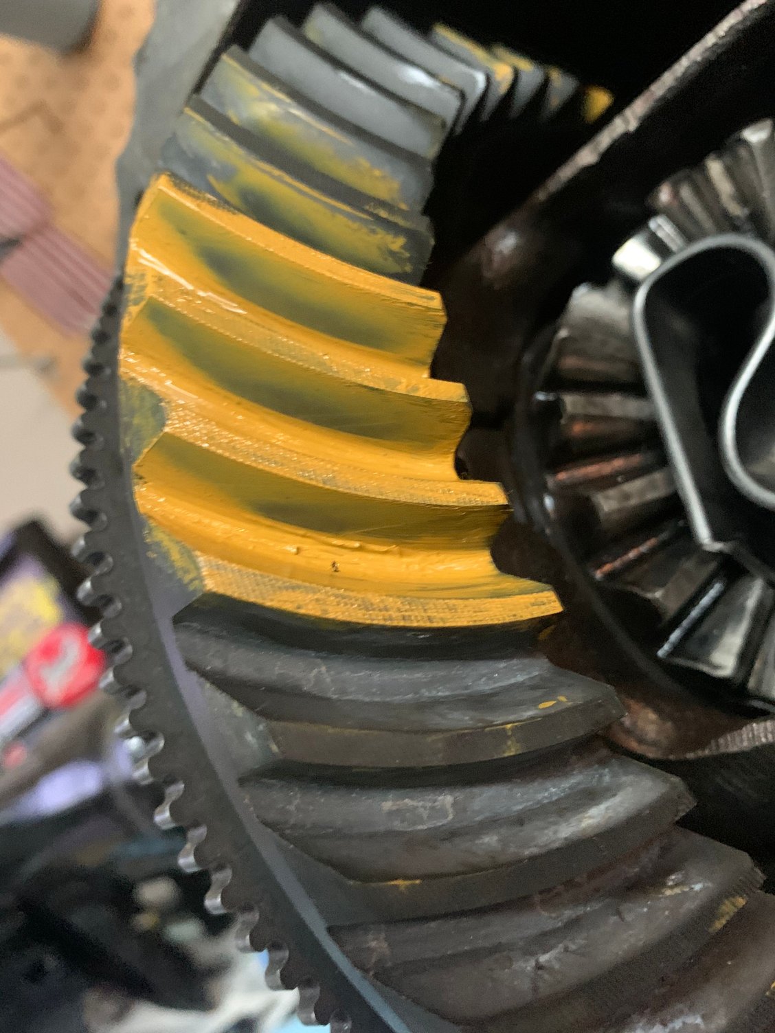

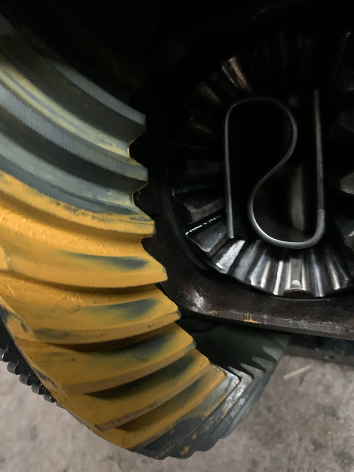

This 8.8 build is my first time setting up a rear end, I’ve done a lot of searches, watched videos etc. but I just want to get some opinions on my gear pattern? I’m running a solid spacer, all new Ford gears, bearings, races, etc. Pinion preload is at about 20 in/lb, backlash is .08-.09. I think I’ve got the gear pattern correct, I just want to double check against those more knowledgeable than I. I think I’ve got them where they need to be, but I figured I’d ask.
Drive side
Coast side

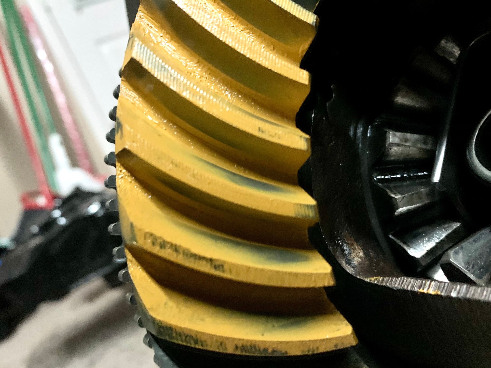

Looks about the same as my contact pattern in the thread below. Just out of curiosity, are those 2 cut gears (aka face hobbed)? From what little I've seen the backlash settings for that type of gear is pretty tight (only a few thousandths), but if that's what the manufacture calls for then you should be OK.

I know I’m within spec on the backlash,what I’m curious about is the gear pattern. The drive side looks good to me, but the coast side looks a little light, so I wanted to get some more experienced opinions on the pattern itself. Going to try an extra .02” pinion shim tonight I think and see where I end up with that.

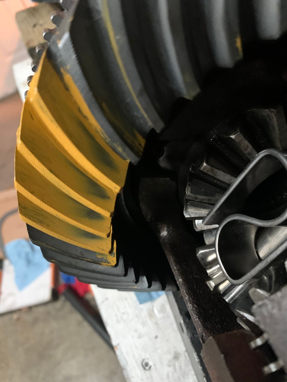

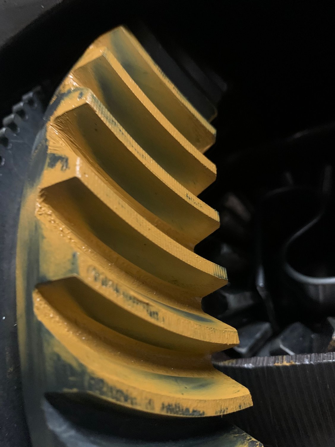

Adjusted the pinion shim slightly thinner, and here’s where I ended up. I think I’m going to run this.
