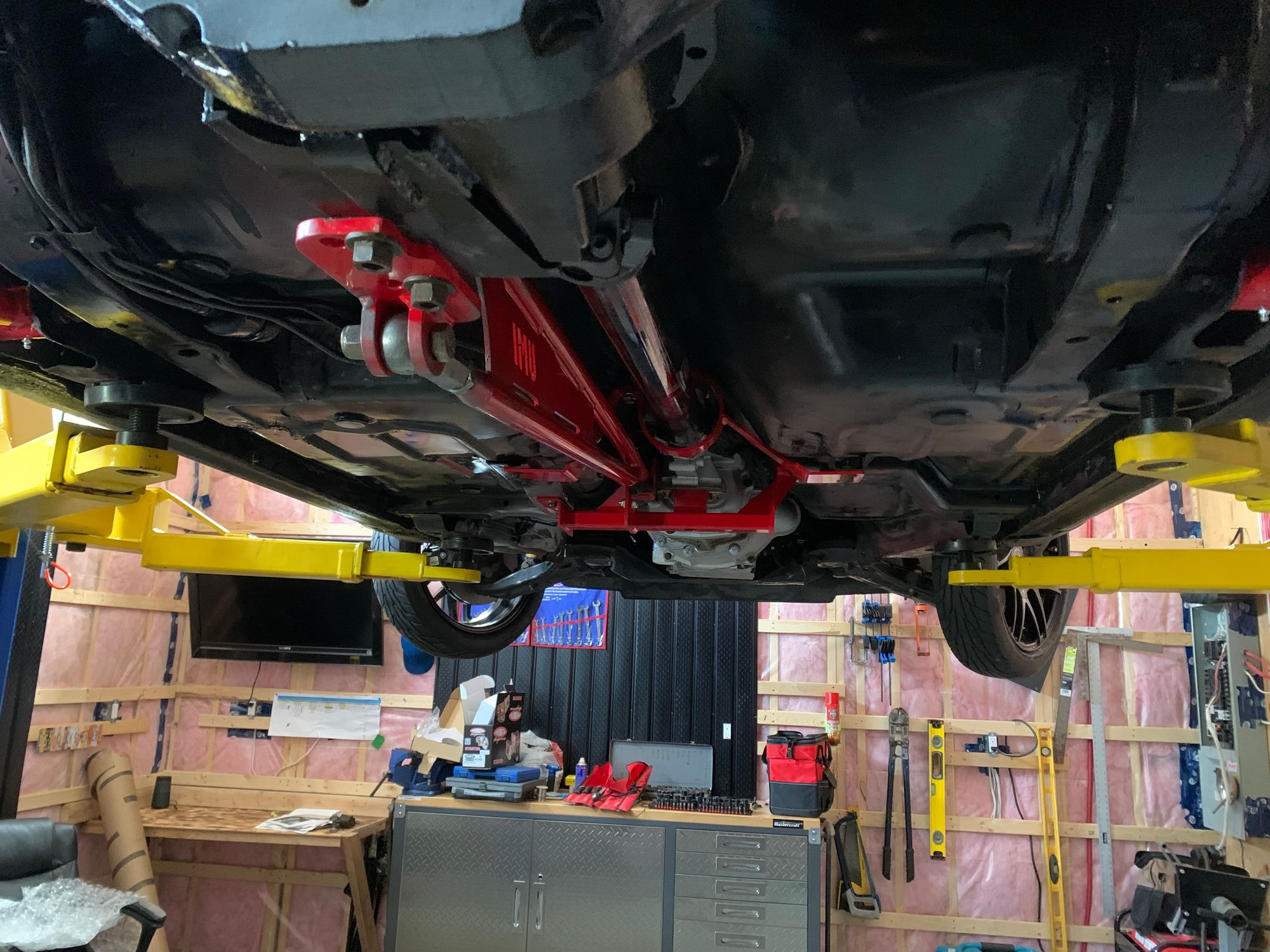

Just got the racecraft bracket kit in, going to assemble them this week, looks like some pretty beefy brackets.

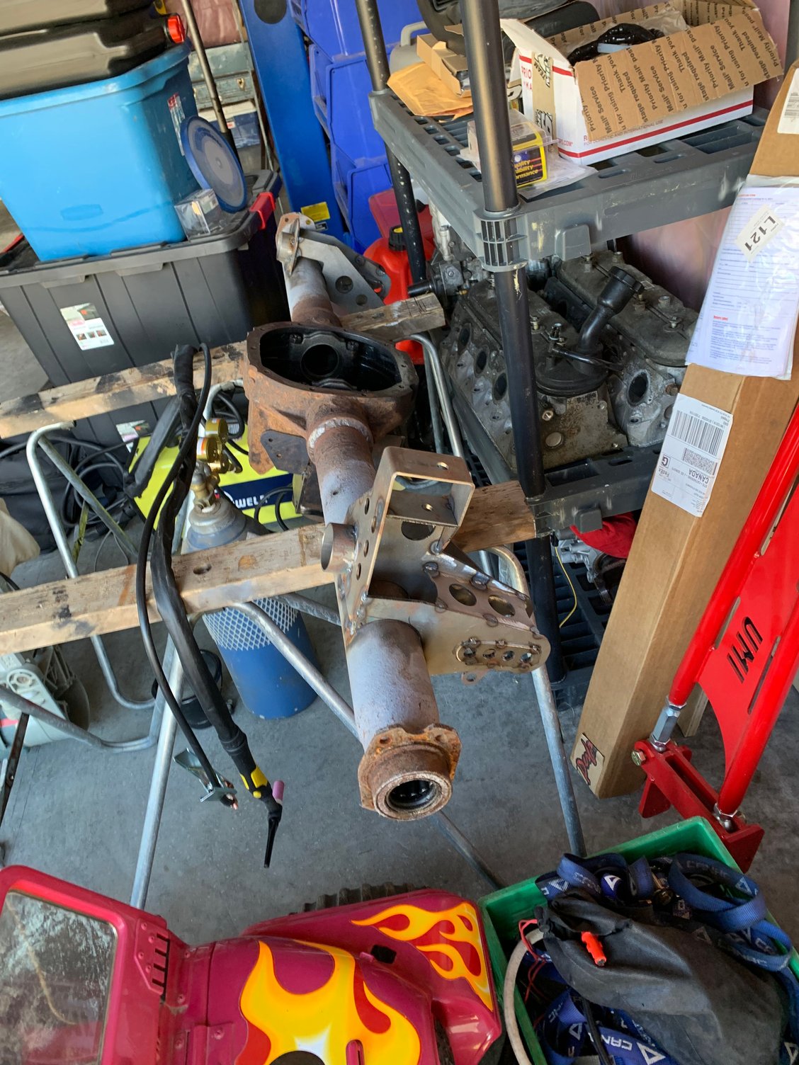

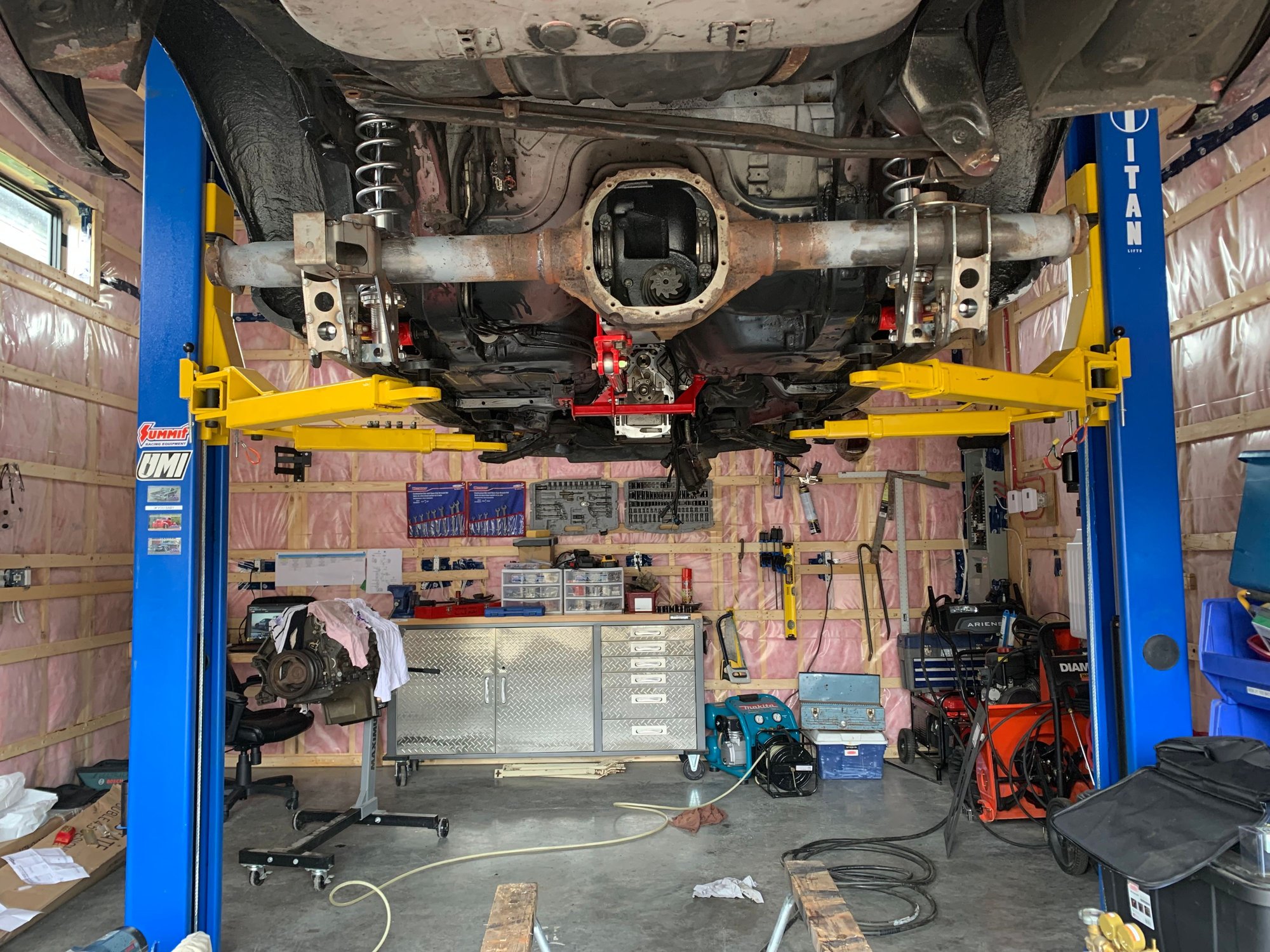

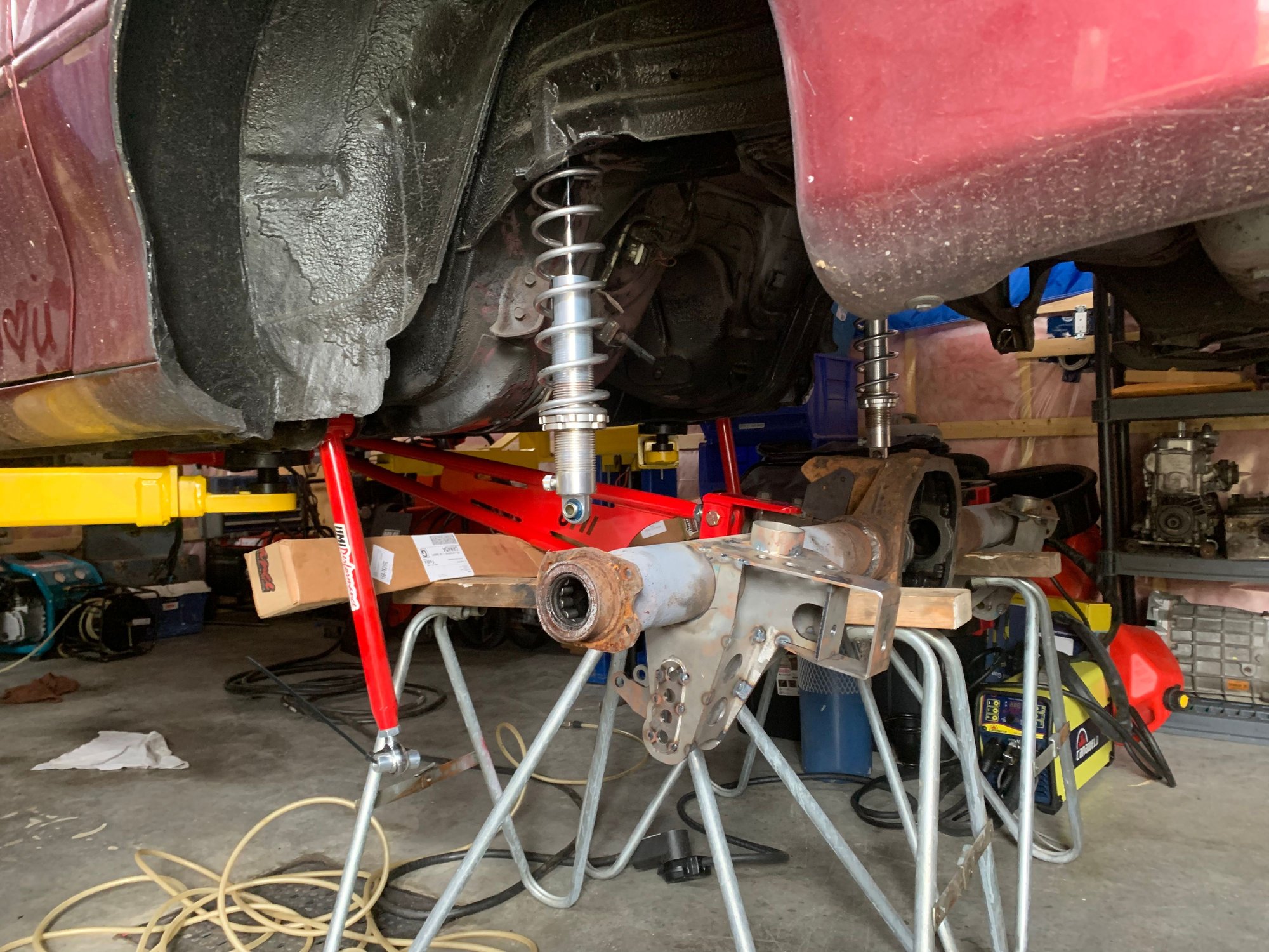

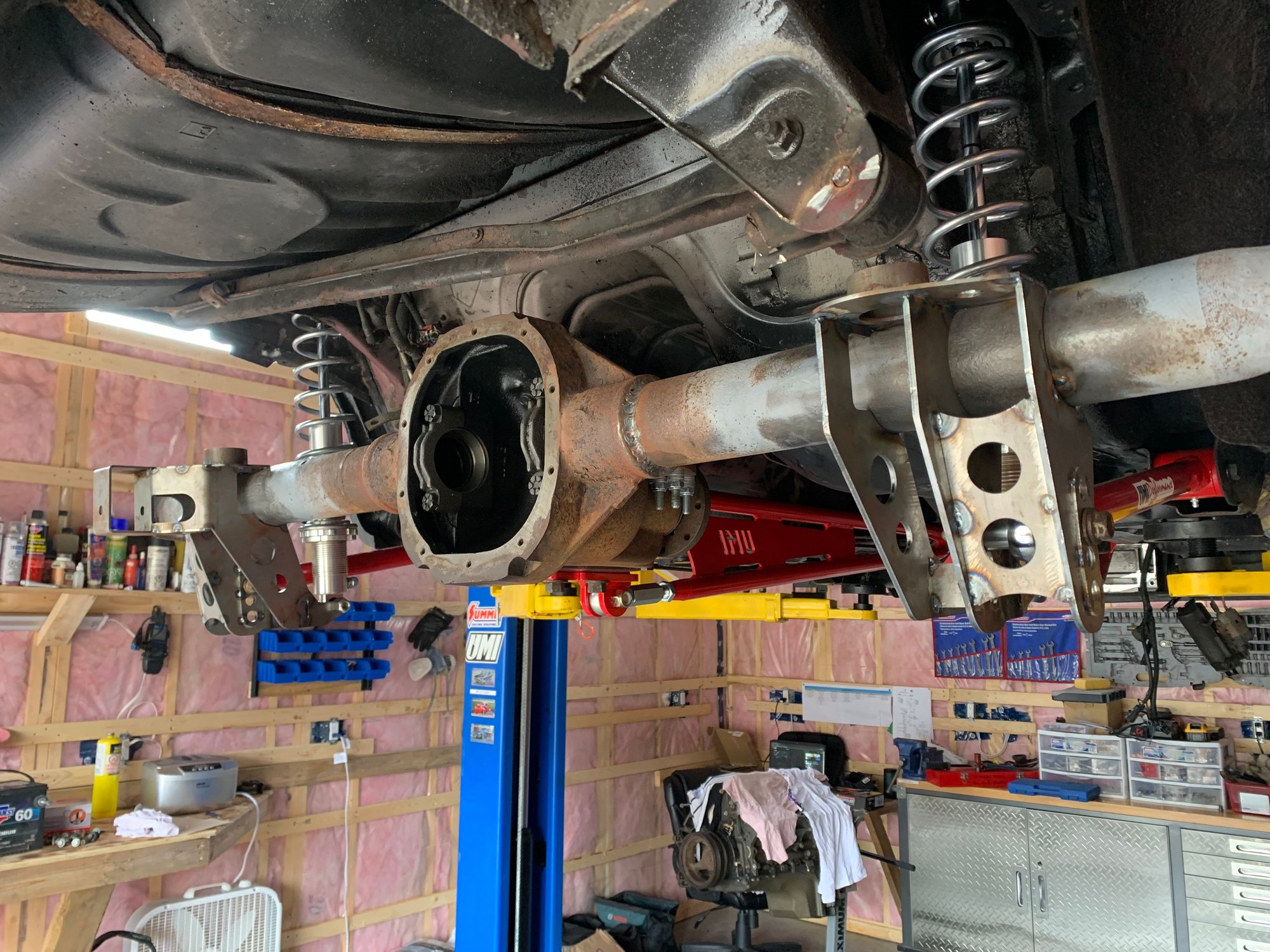

Sorry it’s been a while doing the finishing touches on my garage, working on the 8.8 swap while I’m doing this also. I’ve got the racecraft brackets tacked to the 8.8. I got Viking rear coilovers installed on the car right now and currently lining things up.
Old Aug 19, 2022 | 07:12 PM
john.kiley's Avatar
Joined: Mar 2021
Posts: 58
Likes: 12

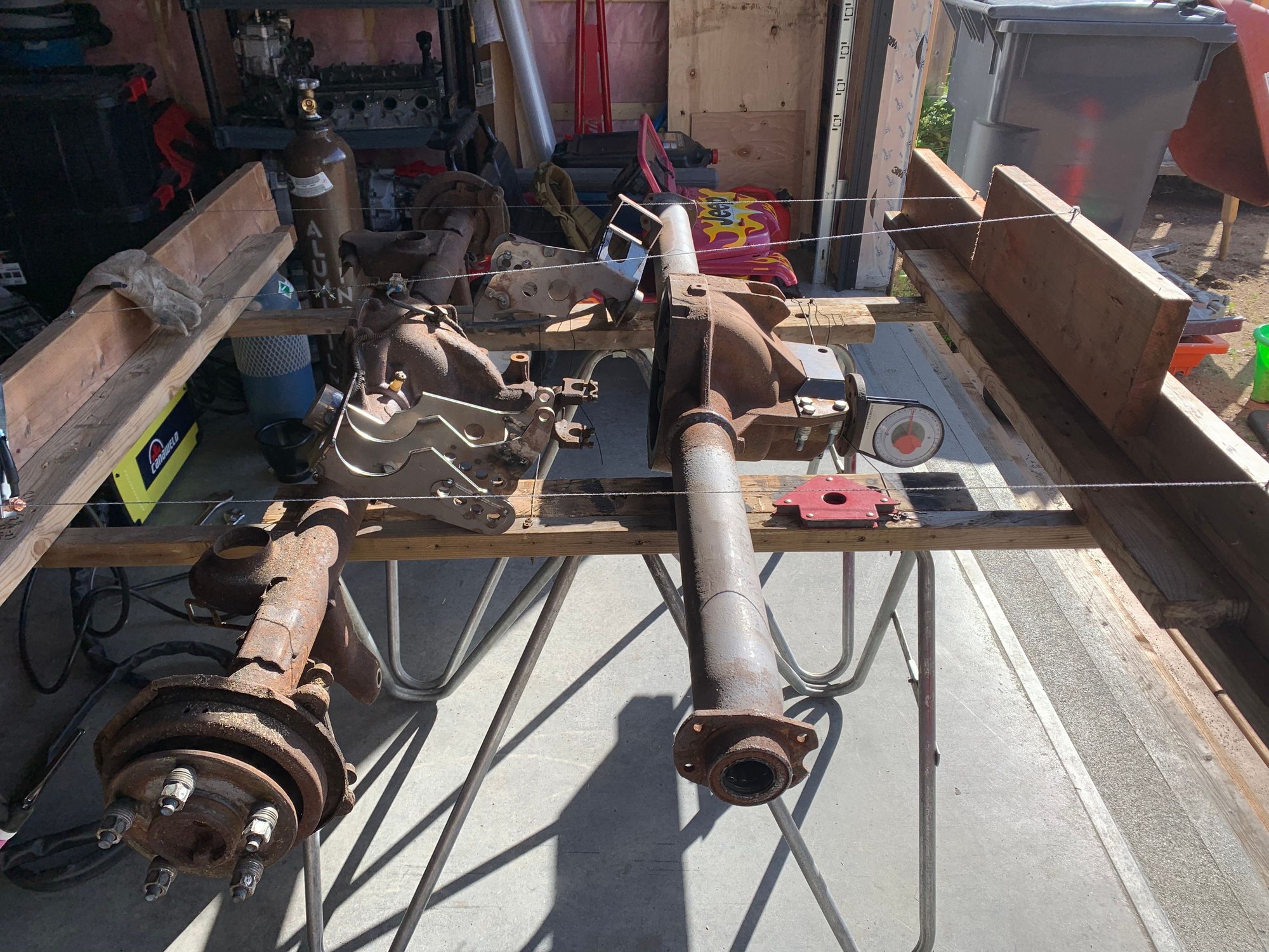

This is how I got the brackets in the right spot. Put both diffs in line (centreline), level and parallel. Put lines perfectly in the center of 10-bolt spring perches and perfectly square. Then make sure spring perches are perfectly level on 10-bolt and measure pinion angle with magnetic angle finder. Then set same pinion angle on 8.8. Then position new brackets spring perches centered on old ones, and level. Tack them in.

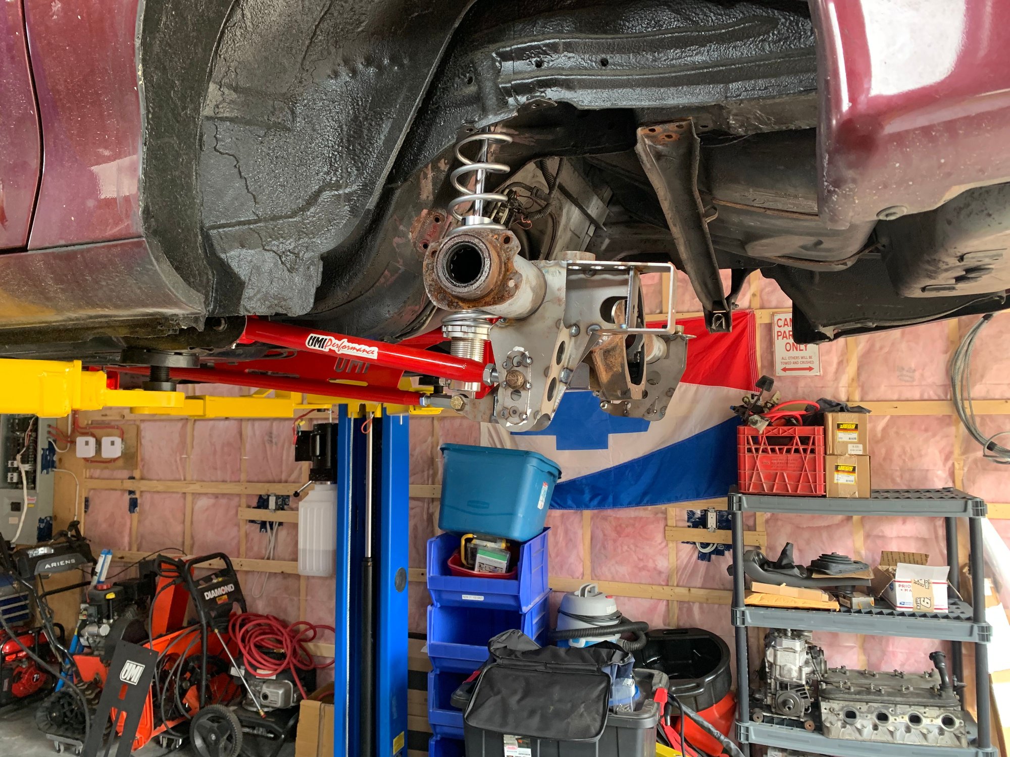

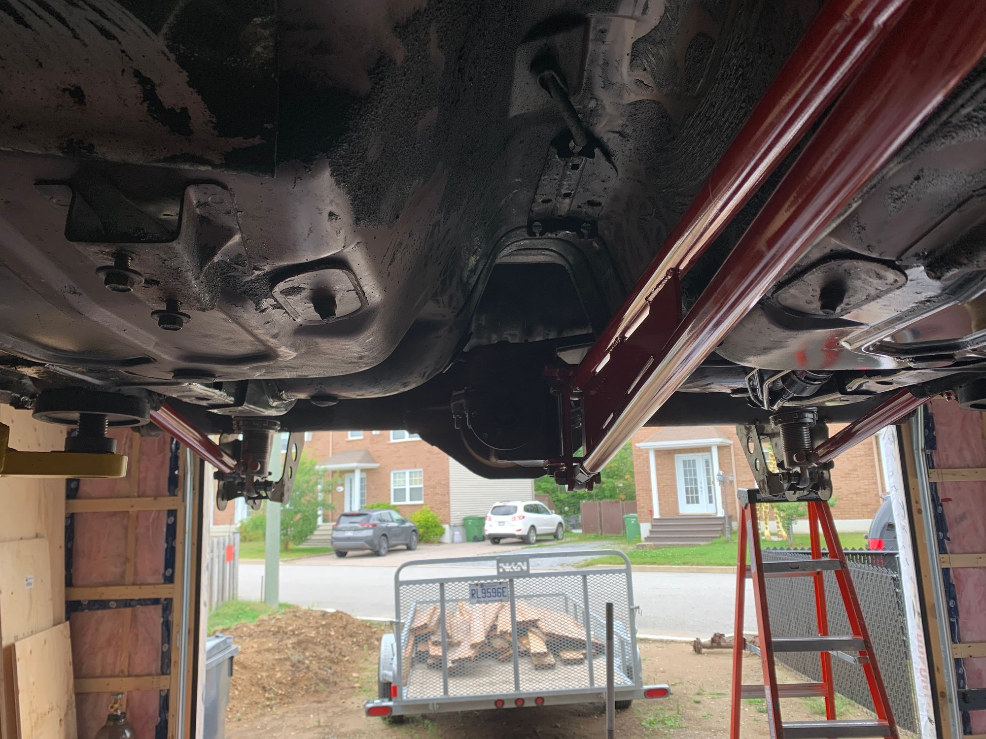

And here it is mocked up on car, everything lines up very well

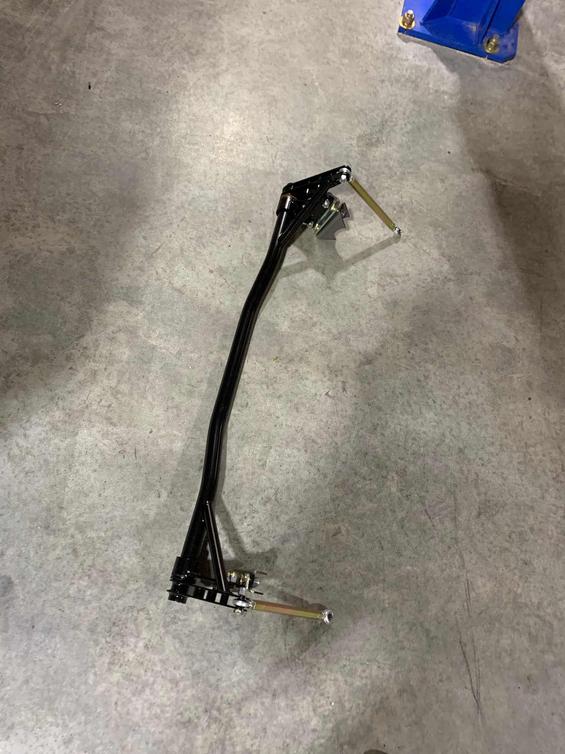

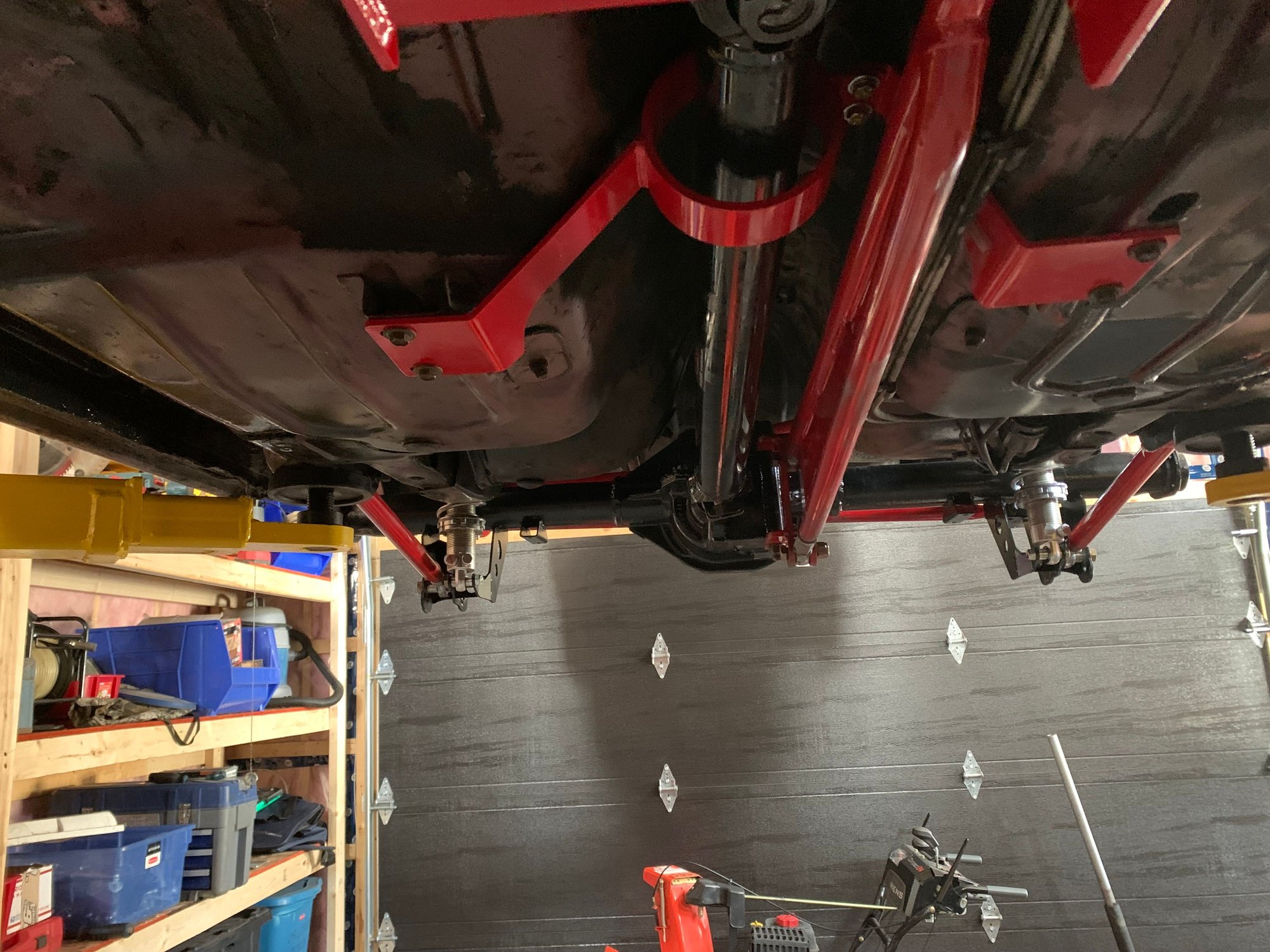

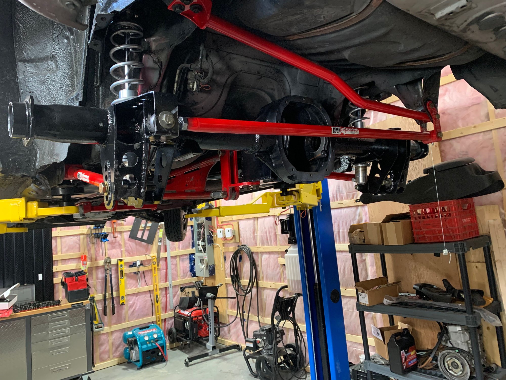

Decided to use Midwest chassis’ bent style Antiroll bar, just got it in. Next step will be to tack it in, then final weld everything. Will post pics as I go.

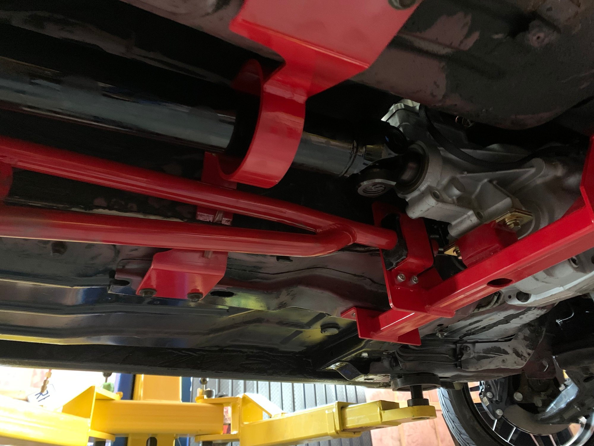

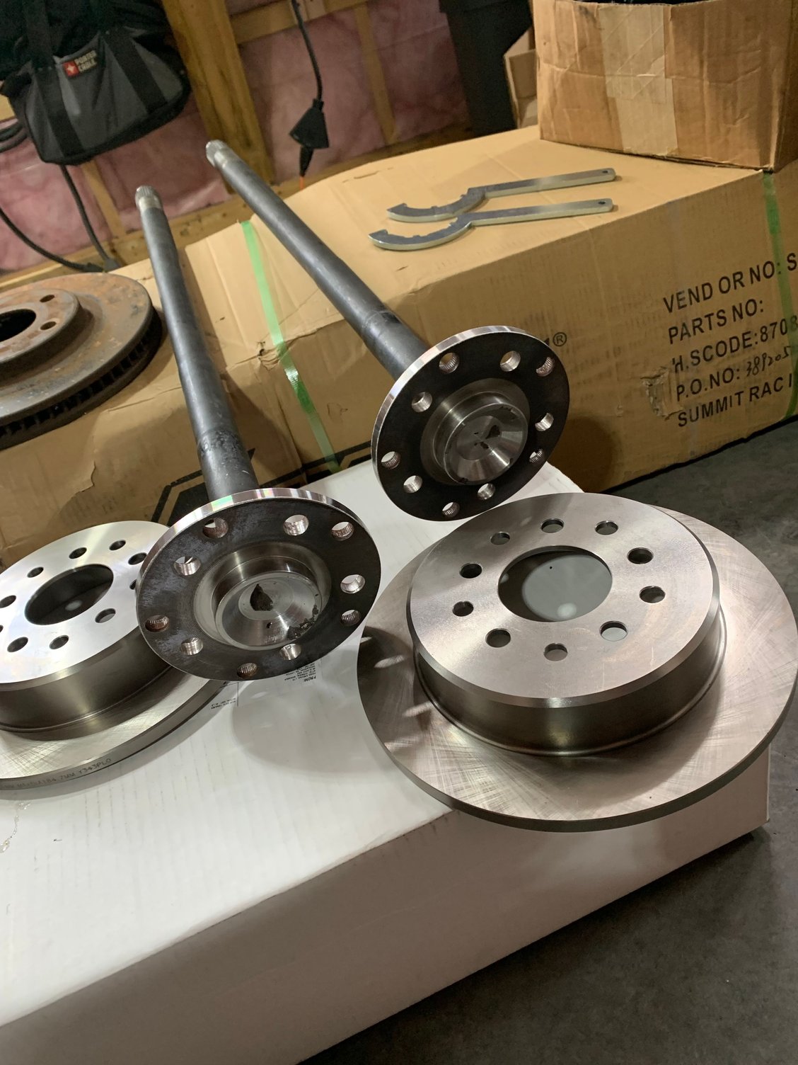

I used this tool to redrill the axles to the correct bolt pattern.
Custom 3" chromoly driveshaft
Driveshaft slightly offset, but not too bad.
Old Apr 4, 2023 | 11:40 AM
  #37
john.kiley's Avatar
Joined: Mar 2021
Posts: 58
Likes: 12

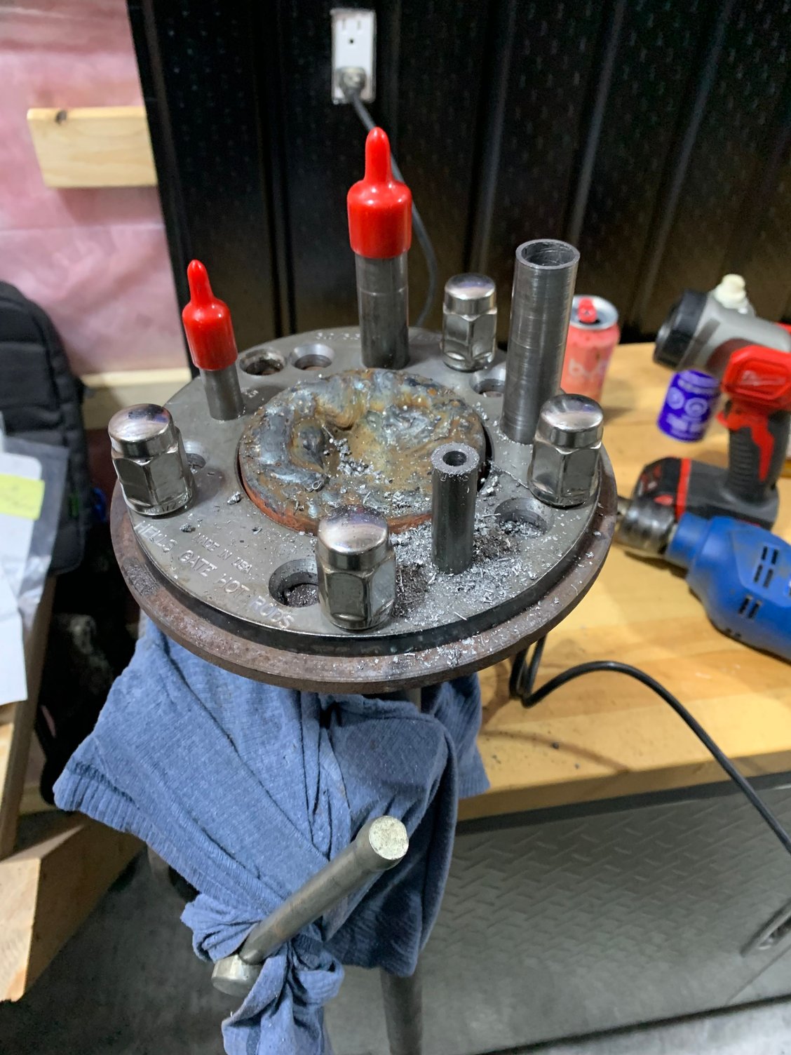

Ford explorer discs, redrilled to 5x4.75, f150 axles turned down to fit inside the explorer discs, and hub center filled with weld and turned down to 70mm to fit inside camaro wheels
Final installation

Thanks for the awesome thread. Any issues/ vibrations with the driveshaft angle?

Would you say thats about a 1/2 inch offset to the right? this swap is looking pretty good, in for driving experience also. Great job John
