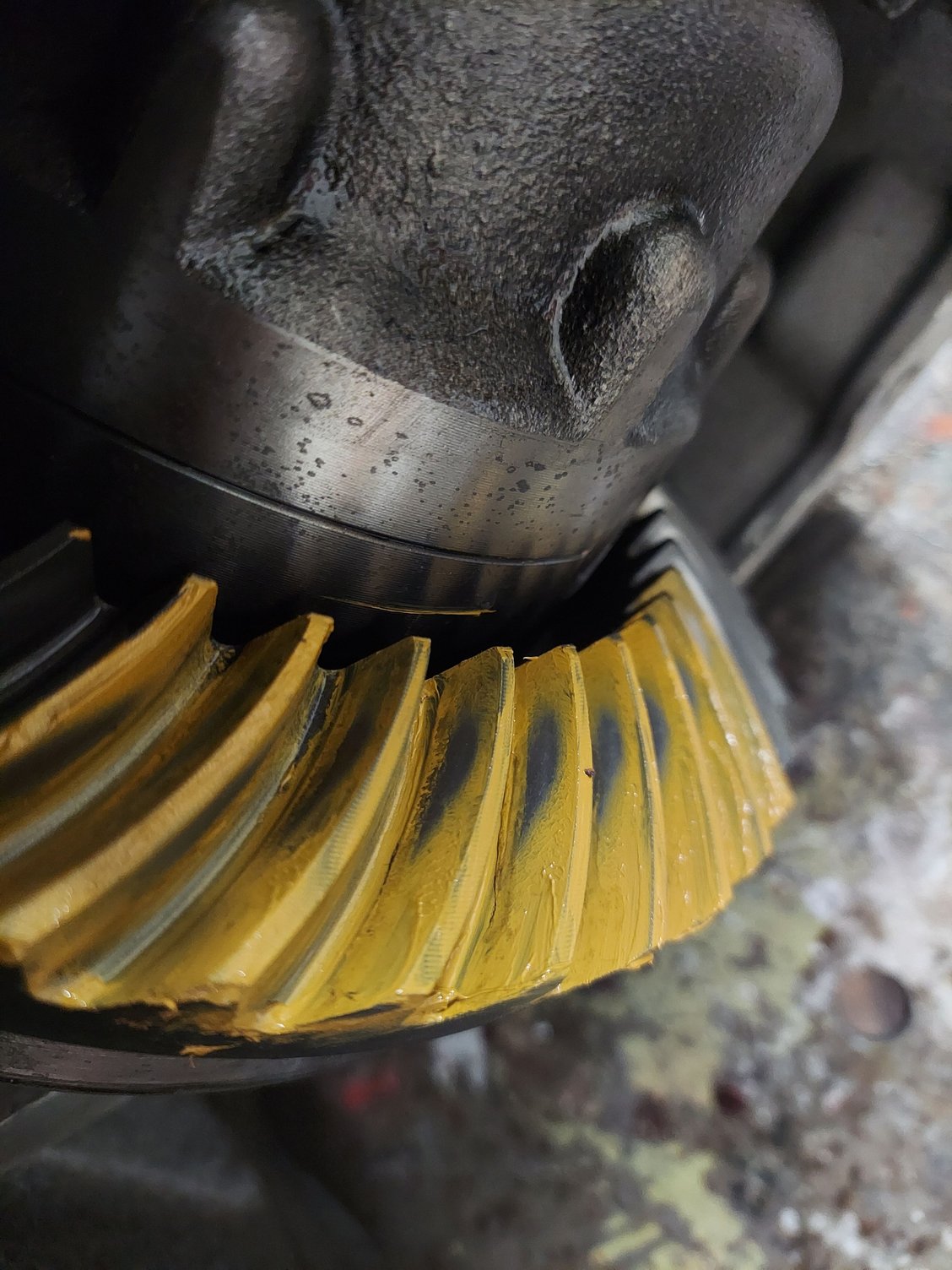

I am sure someone has posted this before but there is hundreds of pages to cycle through...no.
Anyways I have GM 8.6 irs that i just put some 3.91s in. Set the preload to 16 lb in per new bearing spec and backlash about .007. Is this uhhh acceptable for 2 cut? Drive side looked pretty centered maybe towards the heel a tad. Opinions?

The teeth that weren't coated with marking compound and the marking compound carried to those previously clean teeth, what does the yellow pattern look like on those ? That would show a true pattern.

I never took photos of it but if I remember correctly the "ghost pattern" didn't look too much different. Not 100%
