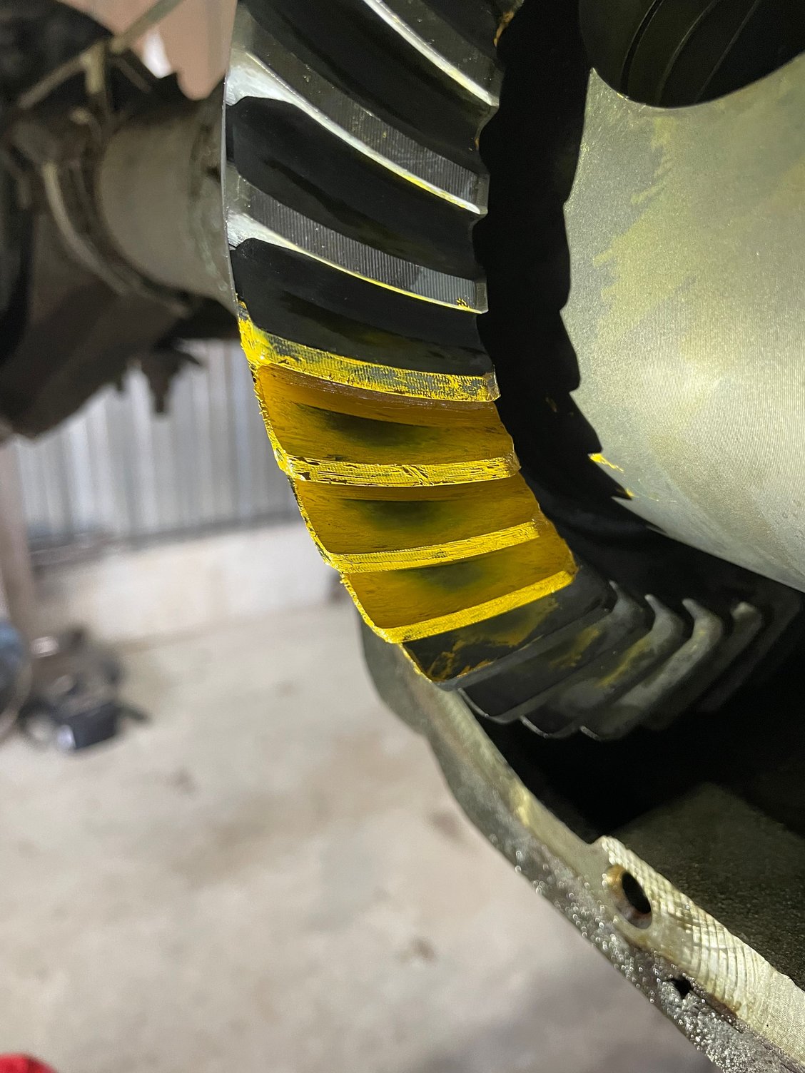

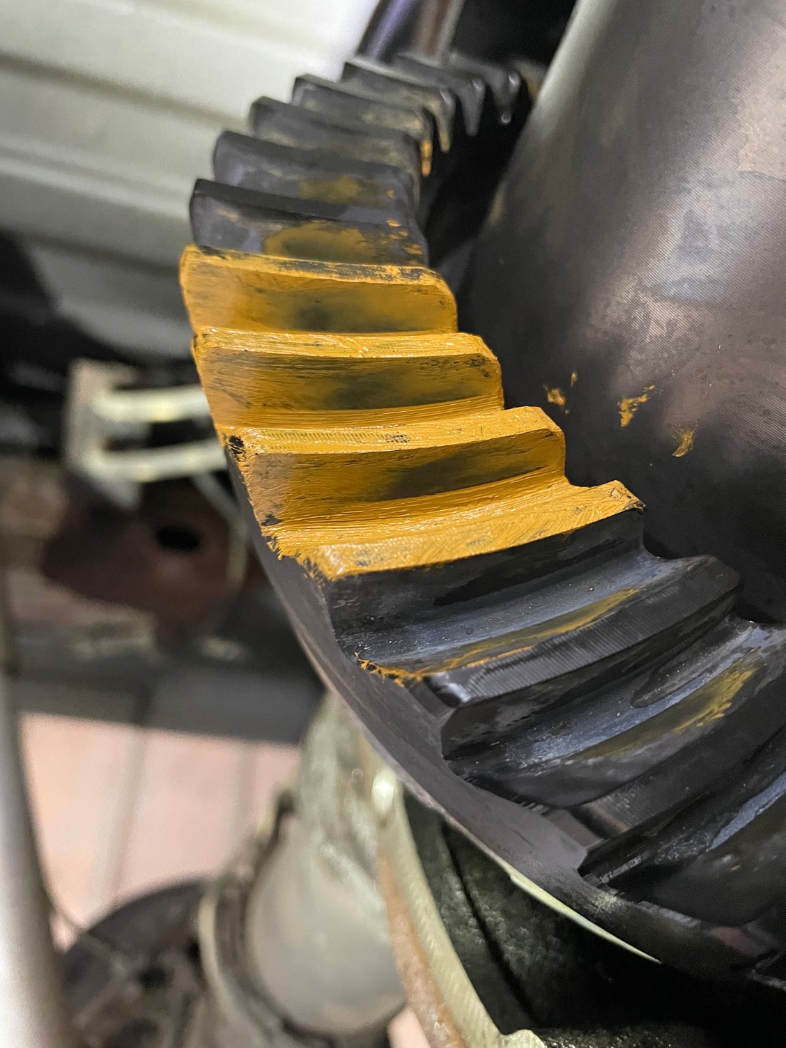

Does this look close?

Yes, big change compared to your original thread.

Think I’m good to run it?
