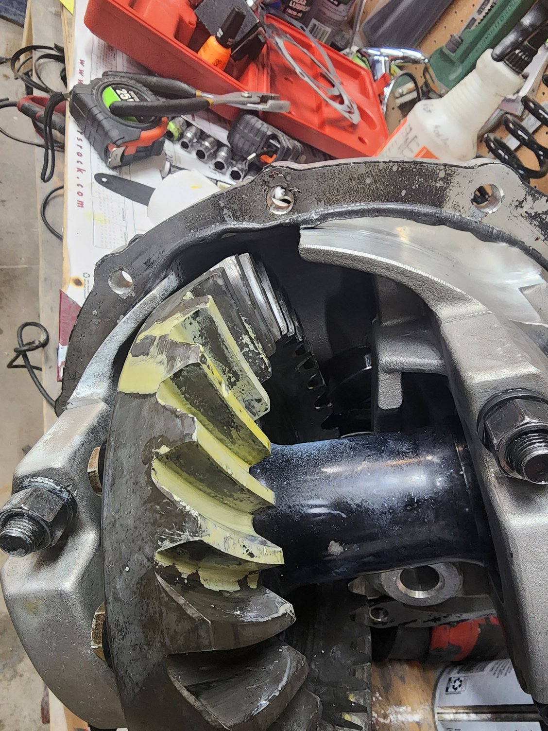

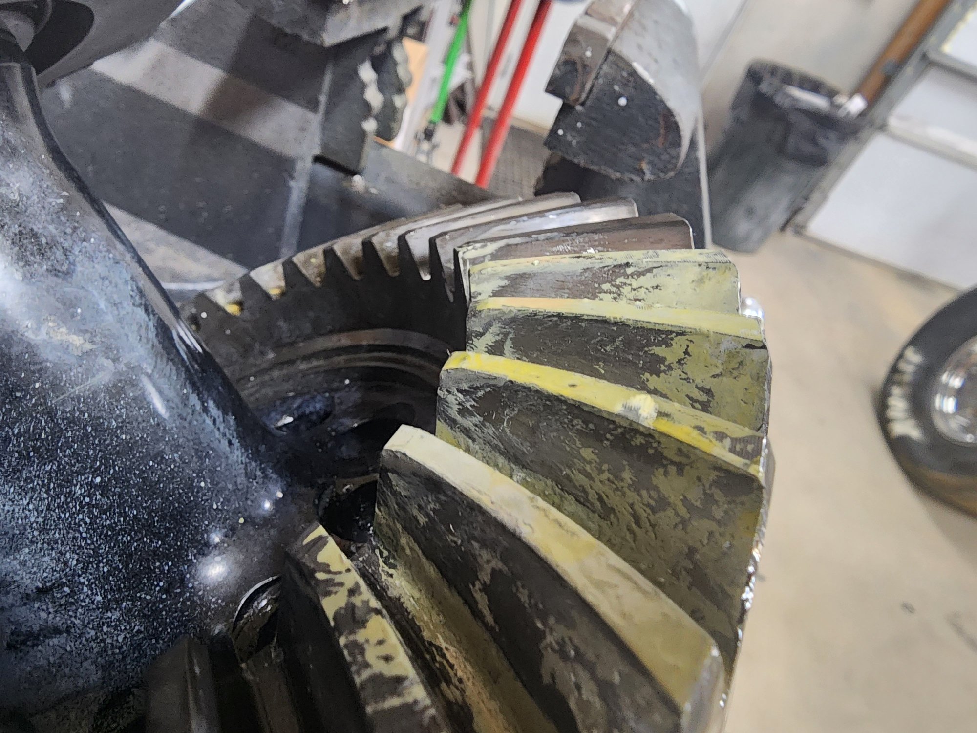

Here's some photos. Paint I used kinda rough. Just look at pattern let me know how it looks. 9" 456
any input will help thanks everyone..

Looks like backlash needs to be decreased.
