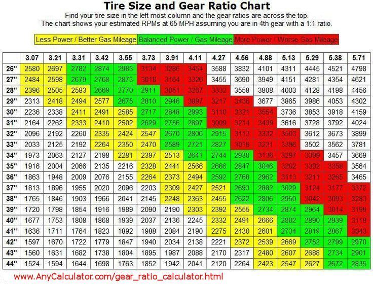

Ole boy said, “for spirited street use only.” How common is it for a 400’ish or less rear horse car to break one from a roll? Fairly common? Do the road course guys upgrade rear ends too? I suppose the big power boys probably do. But what about the 400 ish horse guy? Would he need to necessarily? A road course car would be a closer comparison to a street car than a dragster would. One might race from a stop light now and again maybe (bad idea. not safe) but surely it wouldn’t be a huge clutch dump and it’d be on street tires. If one takes “the launch” out of the equation how well does the 10 bolt hold up? Are they breaking shifting from 3rd to 4th etc at moderate power levels?
I wish there was a better option for the street car crowd than to have to expect to have delete ABS/TCS and live with dash lights after spending that kind of money. It’d also be the pits to end up with a loud one or any other issues that seem to happen more than they should considering the price tag. It’d also be the pits to get a loud one.
@Mezzy If you didn’t like the 4.10’s I bet the 3.90’s might still feel too short. I once went from 2.73 to 3.73 then “down” to 3.31’s in a car that has a trans ratio as follows: 3.35 1.93 1.26 1.00 0.68. And I believe your T56 is: 2.66, 1.78, 1.30, 1.00, .74, .50.
For me the 3.73’s were too steep and they got a little old after awhile. The 3.31’s are a more “comfortable” gear and the car isn’t much if any slower really. It’ll still burn rubber from a roll and the highway cruising is much improved. However, the 3.73’s worked better with the cam at parking lot speeds than the 3.31’s do. If your cam doesn’t require a mega steep gear maybe take a look at the 3.55’s. Remember when we’re talking gears we’re talking about fractions of a second on a race track. To all the street car guys: A hundredth of a second won’t make or break you on the boulevard 500, but running down the highway at 3k rpm might break your sprits down the road a ways. Drivers age depending of course. 😂
3.55 gears but not a specific brand recommendation
