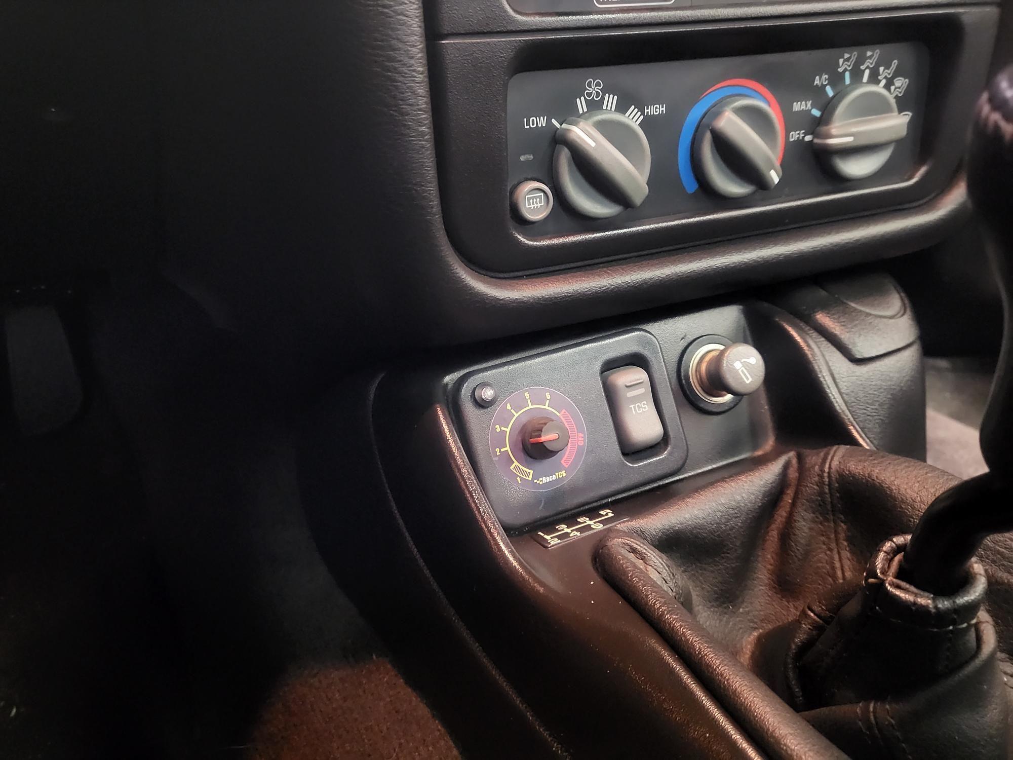

Alternatively, run a traction control system. I run a RaceTCS and it instantly solved all of my traction issues. I run the car at 10% slip on the street and the traction control system dials the engine into just enough power for 10% slip within a fraction of a second. https://ls1tech.com/forums/forced-in...quivalent.html. Possibly best mod I've done on the car.

I played with the factory TCS a lot probably 15 years ago. I was playing with the torque reduction calculations. Probably a better way to do it, but it worked. The issue I ran into is that it was just too long of a delay to bring the car back up to power. So, it works well for keeping me out of the woods, but doesn't dial in the power like the aftermarket stuff.
The RaceTCS is a standalone. I put mine next to the ABS module and just ran about 12" of wire to the box from the ABS sensors. You run the injectors over to the box and the 4 wheel ABS sensors to the box (along with power/ground). I put off putting it in for a while because I just didn't want to mess with the wiring, but it has been a game-changer with the car.
I prefer an injector cut over an ignition cut when chipping off a couple hundred horsepower. Folks prefer the timing cut, but you have to pull so much timing that it puts a ton a heat on the exhaust valve and it takes a sec for the motor to clean up with the fuel still going in. I've worked on both types and much prefer the injector cut - I put on the RaceTCS specifically because of the injector cut.
The system is able to pull an RPM signal from an injector rather than the reluctor signal - so likely works just fine in tandem with the lingenfelter box.

Been checking these out. So, what is the difference between the v2 and v3? V3 is already harnessed or something? Also, I’d assume you’d want to disable the factory trac control or does this kick in so fast you don’t even have to mess with it? Definitely want to check this out. After further playing around with the speed calc, 3.70s look to be the better option for me not considering traction issues.

V3 has spark and fuel and you configure to use which one you want or a mix. It is also a little more robust box. I run the V2 because I don't need/want the spark control.
For normal driving around I keep the factory TCS on. The RaceTCS runs in the background at ~5% and dials the power in fast enough where the factory TCS doesn't come in. If I want to go quicker, I click of the factory TCS via the button and turn the RaceTCS up to 10 to 12% via a **** right next to the factory TCS. It picks the car up from about 15 mph/sec up to ~17 mph/sec for roll stuff.
