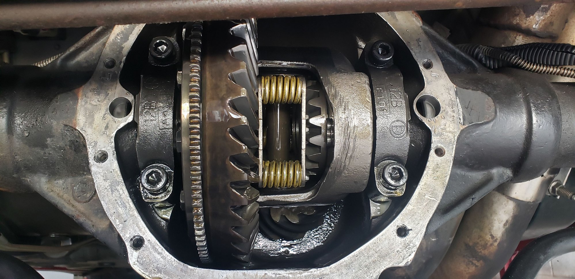

Hey everyone, about to change the 12 bolt moser rearend but I don't know which type of carrier it is so I am uncertain on which fluid to use and if I need to use any friction modifier? I inherited this car from my late brother so I don't know much on the rearend fluid type. Thanks in advance! Fyi this is for a 01 4th gen

Will need friction modifier. Springs = clutch type diff. Weight is usually 80-90. You can go heavier, but it will run hotter.

I actually got response from moser. I'll need 3 bottles of 80-90W non-synthetic fluid along with a bottle of 4oz limited slip additive

You need to dig deeper as certain year Eaton Differentials have carbon fiber clutch discs and they do not live a long life if synthetic oil is ran. It delaminates the carbon from the discs and causes them to float around the carrier. Safe bet is GM limited slip additive and dyno oil 80W-90.
