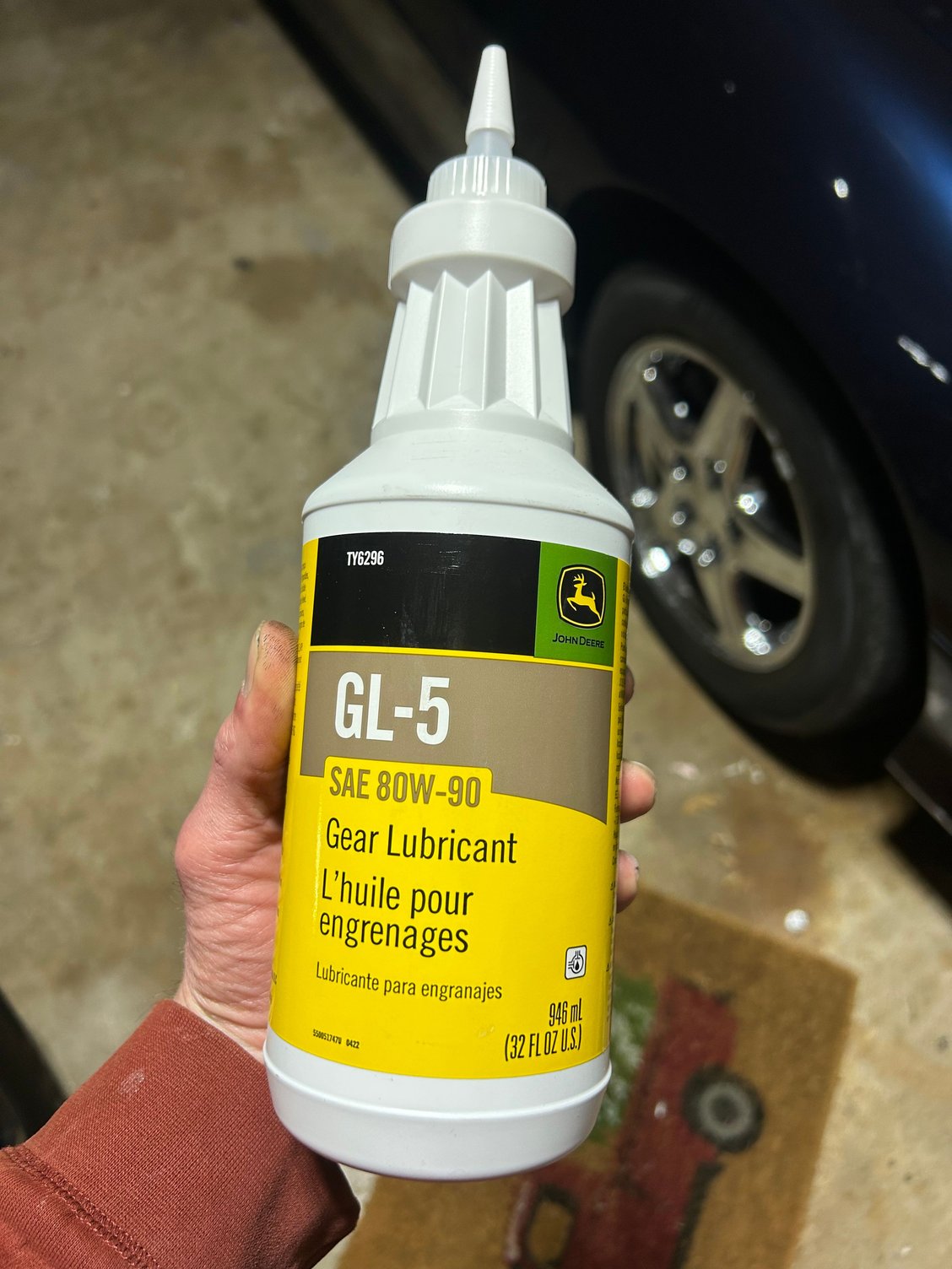

I changed the rear gear oil in mine today and I used a conventional 80w90 that doesn’t contain any limited slip additives. It’s a little thinner than at 100*C than GM’s Delco synthetic 75w90 but I think it’s close enough to be comparable. One thing that the synthetic will probably edge out the conventional is the temp range. How hot do differentials get?
I ran it down the road a little including some WOT down shifts from 4th to 3rd (auto) at Hwy speeds and the gears were quiet. Both accelerating and and coasting. I didn’t notice any weird noises from the differential when making slow speed turns either. I may run this oil until the summer time and then I might go with Mobil delvac 75w90. It’s a synthetic and it’s one of the “heavier” 75w90’s. It’s also one of the few that doesn’t contain limited slip additives. I had to dig deep to find even an 80w90 that didn’t have any. I’m using John Deere 80w90 GL-5. It’s made by Chevron and it’s API GL-5, API MT-1, and SAE J2360 rated. They also have an 85w140 which might can handle heat better, but it might be getting on the “thicker” side of things.

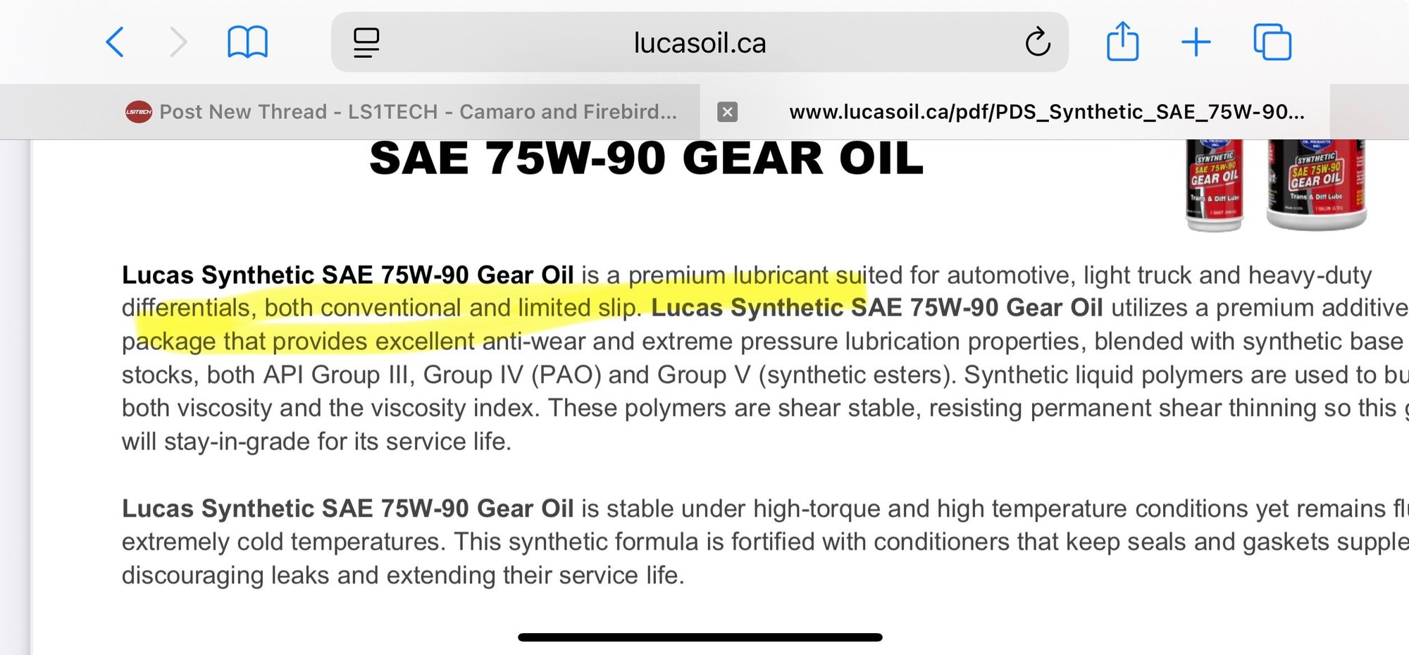

I’m going to attach a screen shot of Lucas synthetic 75w90’s specs where it mentions limited slip. It doesn’t say that it has it
in there, but when it says “suitable for limited LSD” that means it’s in there. If you reach out to the MFG they’ll probably tell.

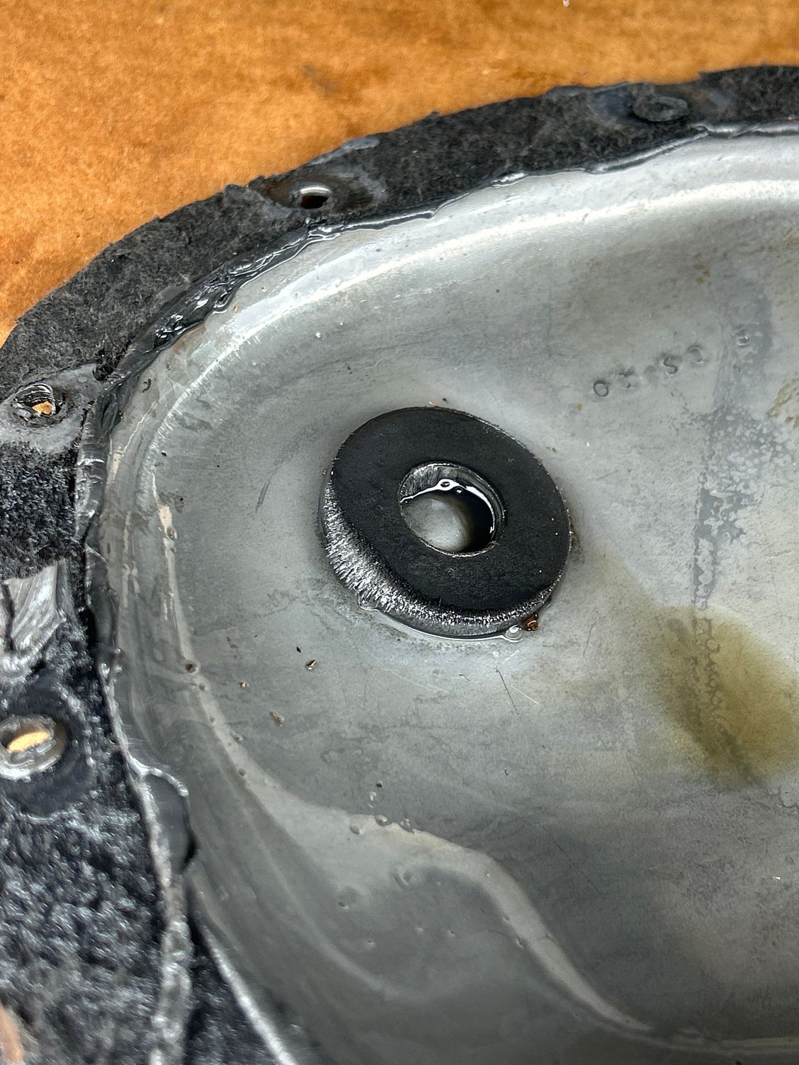

Also, after a new ring & pinion install how much is too much metal on the diff cover magnet during the first fluid change?
This is after about 1k miles, which I realize is probably a little long.

^ Doesn't look too terrible to me. FWIW, the first diff fluid change isn't recommended until 7,500 miles in the owner's manual.
