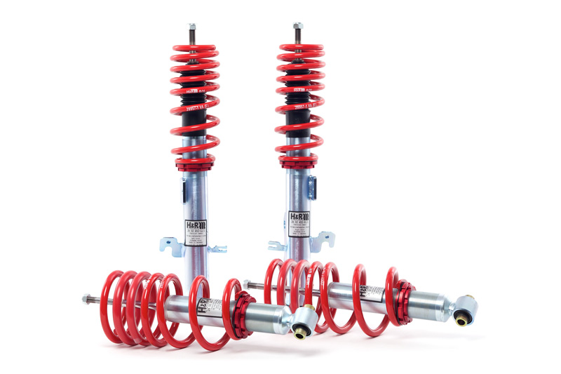

So I'd go with either the Peddlers Camaro 160086 Xa Coilovers ($1763).
Now if you're trying to keep the cost down then look at the H & R Street-Performance Coil-Over kit 50779-2 (2012-13) and 50779 (2010-11) for $1080 which is ride height adjustable and has shocks/struts that are valved for their springs, but the valving isn't adjustable. Tire Rack has them.
